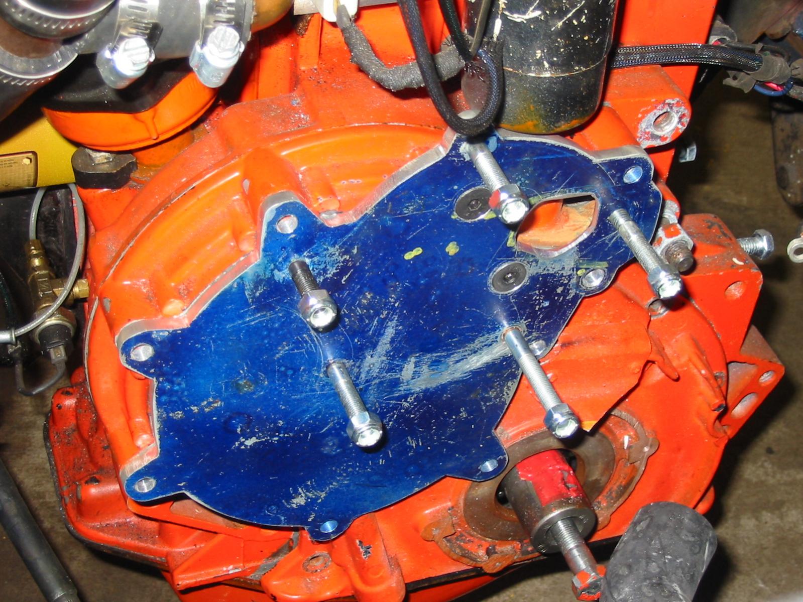

  28. I got rid of the mercruiser waterpump today. I cut 1/2" to 3/4" off the nose of the camshaft. A Dorman "cup plug # 570-026 presses into the camshaft opening in the waterpump housing perfectly. (It is a size slightly less than 1 .5") . The rear half of the Mercruiser waterpump housing is un-modified and fills with coolant. The front half of the housing is replaced with a 1/4" aluminum plate that a Toyota Corolla water pump bolts onto.
  29. As plugging the cam passageway into the water pump was so easy, I immediately made a plate adapting a Toyota corolla water pump to my Mercruiser 470.
    The plate takes its shape mainly from the Merc. water pump which it covers.
    Flow considerations determine the location of the outlet of the Toyota pump. Coolant flows through a hole in the plate located near the Merc. pump outlet opening. The shape and size of outlet hole in the plate is determined by the passageway walls of the two pumps. It is as large as I could make it.
    In the pictures the adapting plate is still blue from its layout fluid. A set of 5/16" studs hold the Toyota pump on the plate. I will use allen head capscrews in some locations on the plate as they are smaller than an ordinary bolt head.
    You can see two black bolts countersunk to clear the water pump impeller.
