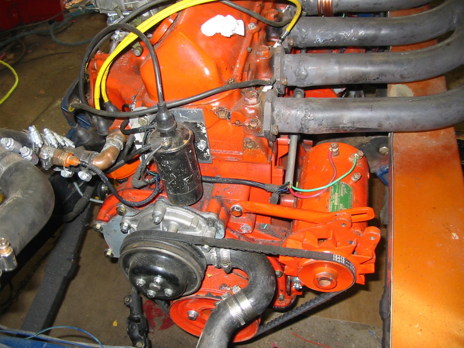

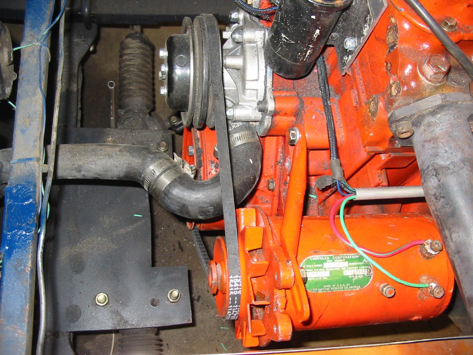

  1. I've replaced the alternator I added with a 12 volt generator. It was easy to mount inspite of being a big clumsy thing. But the important thing is that it looks old.

  6. here are photos of my generator...it certainly is big compared to an alternator, but it looks old so if it can charge the battery after a start, that is enough. There is a regulator so you know it is real. Near the exhaust I ran the wires in aluminum tubing {conduit style}]. It is really just to make it look funky.
    I ran it a few minutes tonight. Its motocraft carb seems better on the mixture than the Rochester 2 jet. It is still runs rich but then it was off of a Ford 289. This engine is 13% smaller, so it would run rich without rejetting. Its steering rack just peeks out from under the flat plate in the 2nd photo.
    As you can see I made the radiator hoses by connecting short sections of preformed hoses with copper tubing.
