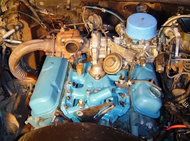

    Here is my latest aquisition for a possible installation on one of my 470s.
    A Turbocharger from a 3.8 Buick V6 that provides 9 lbs of boost.
    I like this setup because it is made to use a QuadraJet carb and was used on a 3.8 engine that is close enough to the same displacement.
    They also did not use an intercooler.
    They increased the Buick V6 from 125 hp to 200 hp without severely effection reliability.
    If I can easily install it on the 470 I am sure that it will produce 300+ hp.
    Thats about 1 hp per lb.
    Anyway the only obvious disadvantage is to stealth so I might put this one into my 544 Volvo where it won't matter so much.

    Does this pull in through carb to the compressor and then strait down to the intake?

  18. looks that way.

    The early Buick Grand National Turbos were the hot air pull through type.
    They are not as efficient as Blow through with an intercooler.
    The pull through turbo provides a lot of extra power with very little down side.
    The most obviouse negative is the extra room they require.
    The intercooler used on the blow through turbos provide more power but used more space and are even more complex.
    I might also put one of the pull through turbos in a model A if I can use a cowl vent for cold air pickup.
    compressing hot air that has already p***ed through the radiator just reduces the effectiveness of the turbo.
    The problem being that between the heat transfer of the exhaust and the air being compressed the boost is partially negated by the heat expansion of the hot air.
    9 lbs pressure cold air is better than 9 lbs pressure of hot air.
    It's like finding that your engine performes better on a cold damp night at a low al***ude than it does on a hot day in the mountains.
    If I find that I get predetonation or learn that it is for sure desirable to have dished pistons I will use them.
    I noticed that the grand national used dished pistons and it might be better to use them.
    The heads that I use have the same 8.8 to 1 compression ratio as the cast iron 460 Ford heads used on the original Mercruiser boat engine.
    Below is a picture that I pinched off the web that shows this setup on a Buick V6.
    Notice that the exhaust pipe comming out of the front of the turbo is missing in the picture.
      84.2 KB
      370

    The Buick Grand National Turbos weighed over 3200 lbs and had 190 to 245 hp depending on the year.
    The reason That I think the 470 will produce so much more power than the Buick V6 is that it starts with so much more.
    The standard Buick 3.8 V6 produced 125 hp while the Mercruiser 3.7 boat engine produced 165 to 190 hp with a cast iron Ford head.
    The after market performance head flows better than a 429 Cobra Jet head.
    I will see if I can build one that stays together as well as the Buick.
    These engines contrary to what many have said are very robust as proven by Sarge Nicols, Randy Dupre and others who have modified them to put out much more hp than I am trying to get out of them.

    I don't think you can flip the manifold without covering the nearly vertical spark plugs. It might be possible to add a thick header flange and move it out enough to flip it, though. There is almost no quench on these heads so I stacked as Fel-Pro on a copper gasket to drop a half point. I need to get back to this project.
  30. dawford
    Joined: Apr 25, 2010
    Posts: 498
    dawford
    Phil,
    You are right about turning the exhaust manifold over. It not only interferes with the spark plugs but off sets the ports.
    I will either have to make a header for that purpose or make a U head pipe to feed the turbo.
    I have figured out how to reduce the comp. ratio to 8.13 to 1 which is close enough to the Buicks 8 to 1.
