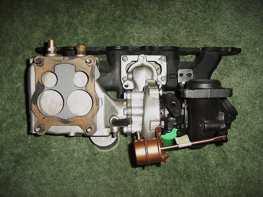

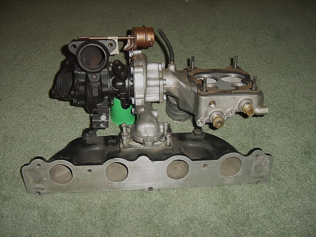

    I just got the Buick GN turbo and lined it up with the 2 barrel Mercruiser intake manifold.
    It looks like all I will have to do is make a flat aluminum adapter plate with 4 bolt holes to match the intake manifold and three studs to match the turbo base and drill a 2" hole to match the turbo to the intake manifold.
    I will also have to fabricate a couple of braces to the engine or intake to distribute the strain and prevent breakage of the turbo 3 bolt flange.
    There will be oil, hot water and vacum lines as well as a couple of sensors.
    I will have to find out what the plumbing was all about on the Buick GN.
    Here are a couple of pictures of the turbo setup sitting on the Mercruiser intake manifold.
    Dick :) :) :)

  8. Your copper colored pneumatic actuator is very important to keeping boost under control.
    It is essential to run it connected.
    Thinking about the merc manifold:
    mine is heated, but that is not to say yours couldn't be water cooled . Where to get the cold water would be another thing to solve, perhaps a heater core mounted up front and a little electric pump
  9. Your exhaust pipe to the turbo will act to as a brace to dampen lateral vibrations , but in heating it lengthens placing a strain on the manifold .

  12. Dick:
    Your first turbo photo shows a 1/2" 2 bolt flanged hole. I think it is the oil return. Orienting that downward lets the oil drain out resulting in less oil burning in the turbo and less residue there.

    The aluminum roller rocker arms work on the same studs that come with the head and were purchased from the same supplier.
    The best and easiest mod is to upgrade to the Mercruiser QuadraJet manifold and carb if you don't already have one.
    I don't know how you would use the Buick turbo in a boat but I am sure it could be done.
    The exhaust manifold would have to be scrapped and a header would have to be made to hook up to the turbo.
    The exhaust and the hot water would have to be ejected out much like other high powered boats do it.
    I have several boats right now that I am removing the engines from but I have no intension of trying to salvage any of them for use.
    The government rules regulations and fees have ruined boating and fishing for me.
    I remember when these agencies were there to help people enjoy these things in a reasonable manner.
    We now have to speak out to keep them from further infringing on Hot Rodding and auto ownership rights.
    Dick :) :) :)
