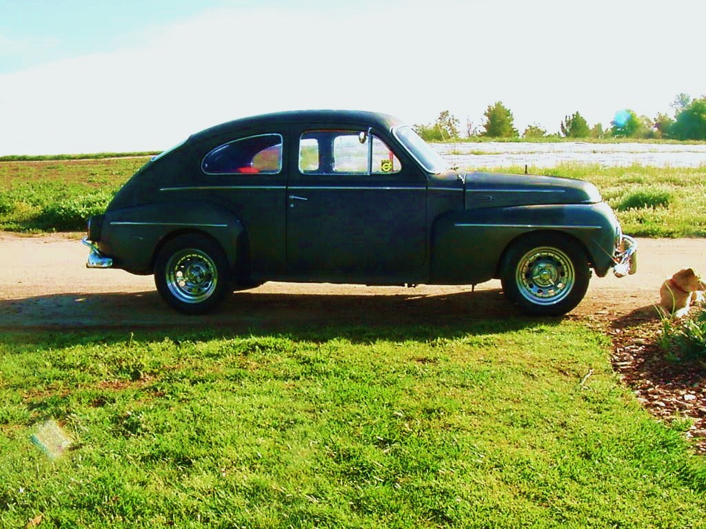

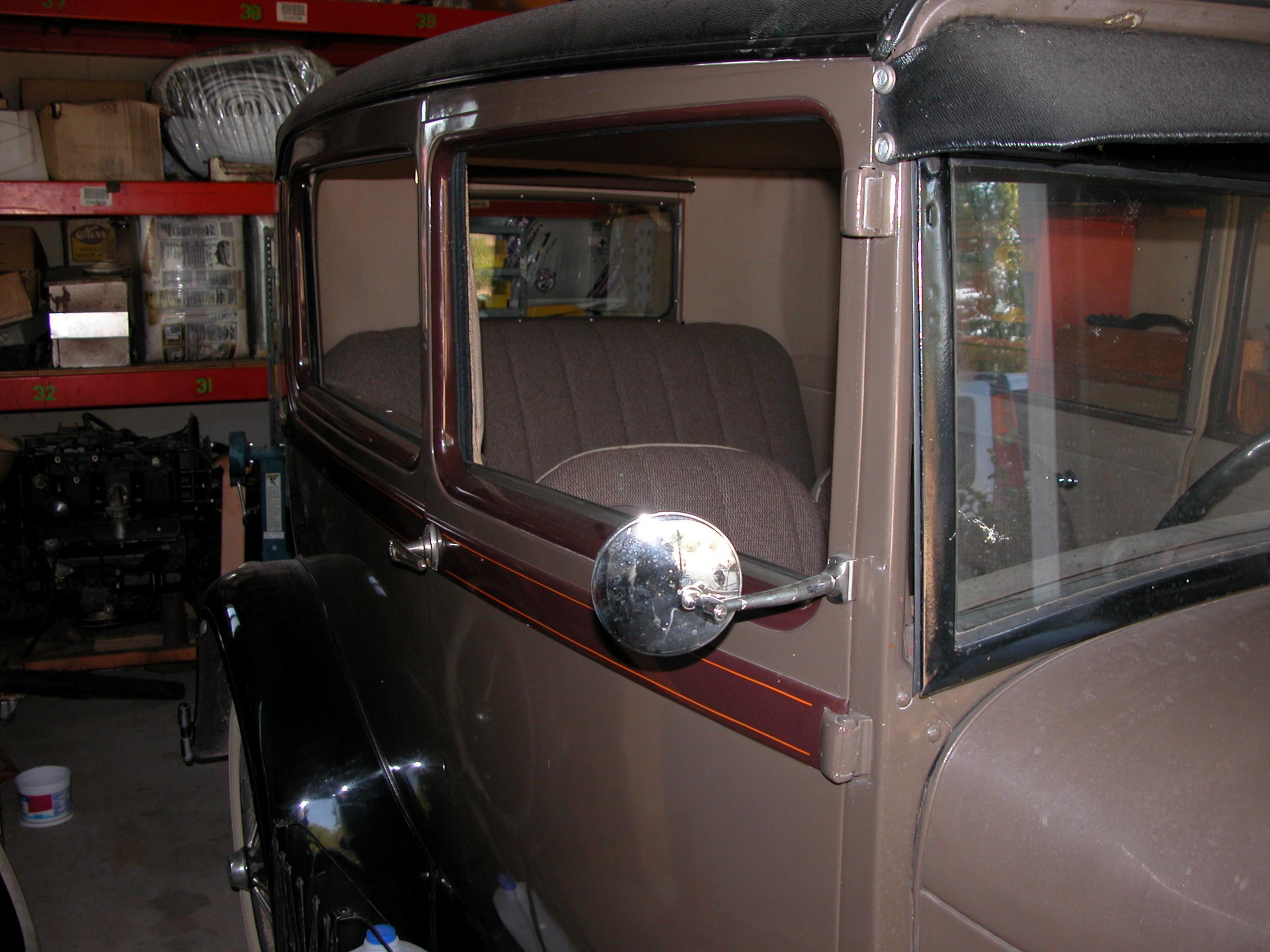

    I am putting my engines in Model A Fords and in a Volvo 544.
    The 544 will be a European sports cars worst nightmare.
    The Model A's will probably shake up most flathead and many V8 hot rods.

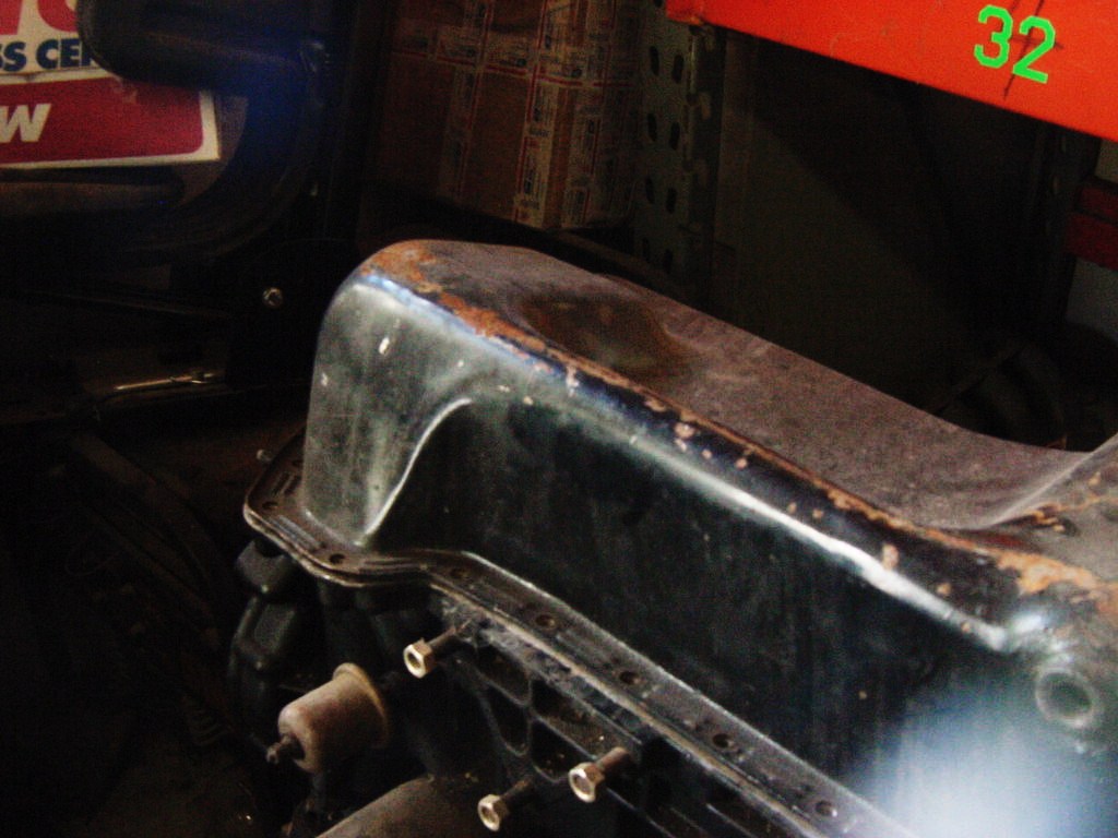

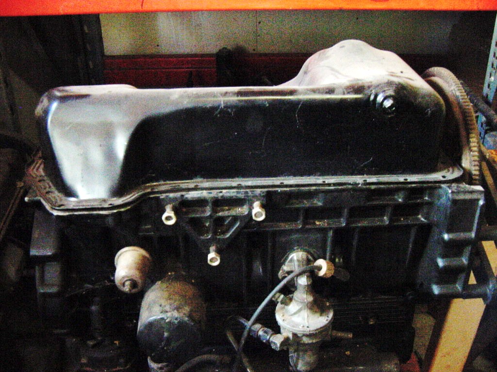

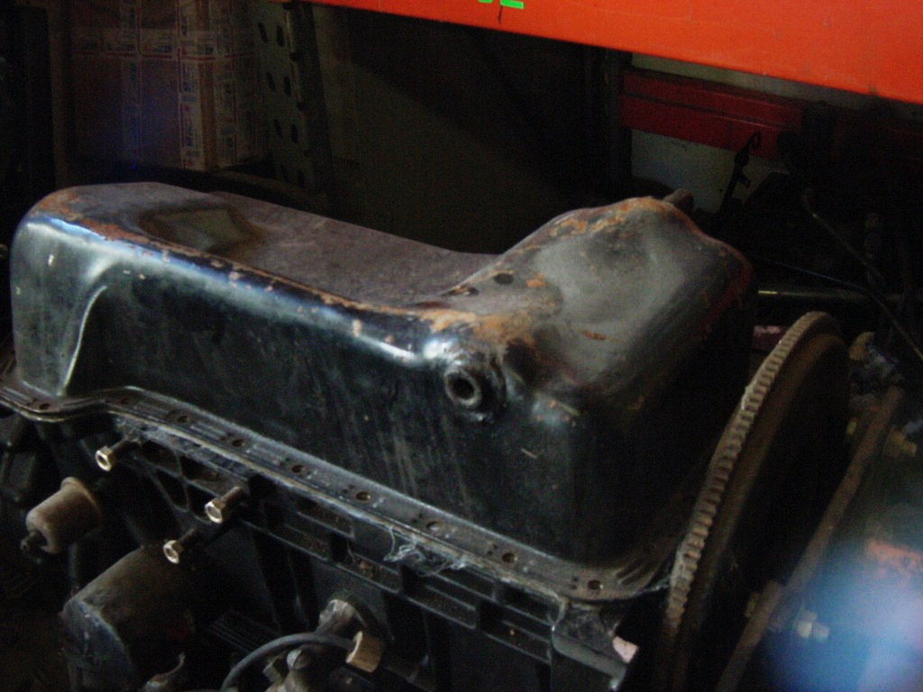

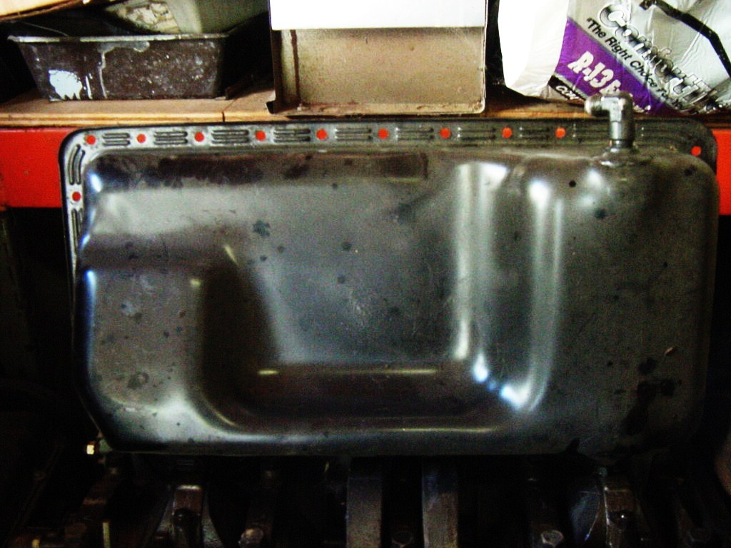

    The oil pump is in the front and the pickup tube runs to the back.
    A short tube pickup could be made to work in the front and the pan bottom clearance to the conrod bolts is only about 1.5".
    The oil pan is different than a 460 ford pan and they do not have the same or similar bolt patterns.

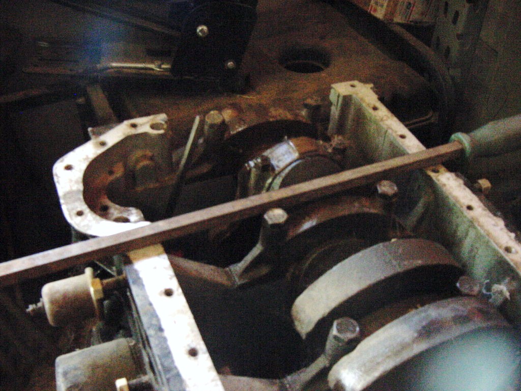

    I have taken some pictures for you showing the pan and the recessed main caps.
    The oil pump extends about 5" down into the pan but is slanted toward the front of the pan therefore it occupies only about the front 5" if the pan.
    I have never considered altering the pan to make the engine a front sump pan but I can see that it would be easy to do.
    The oil pump drives off of the distributor shaft at the front of the engine.
    I am not familiar with an external oil pump setup so I would not know how to set up a rear sump.

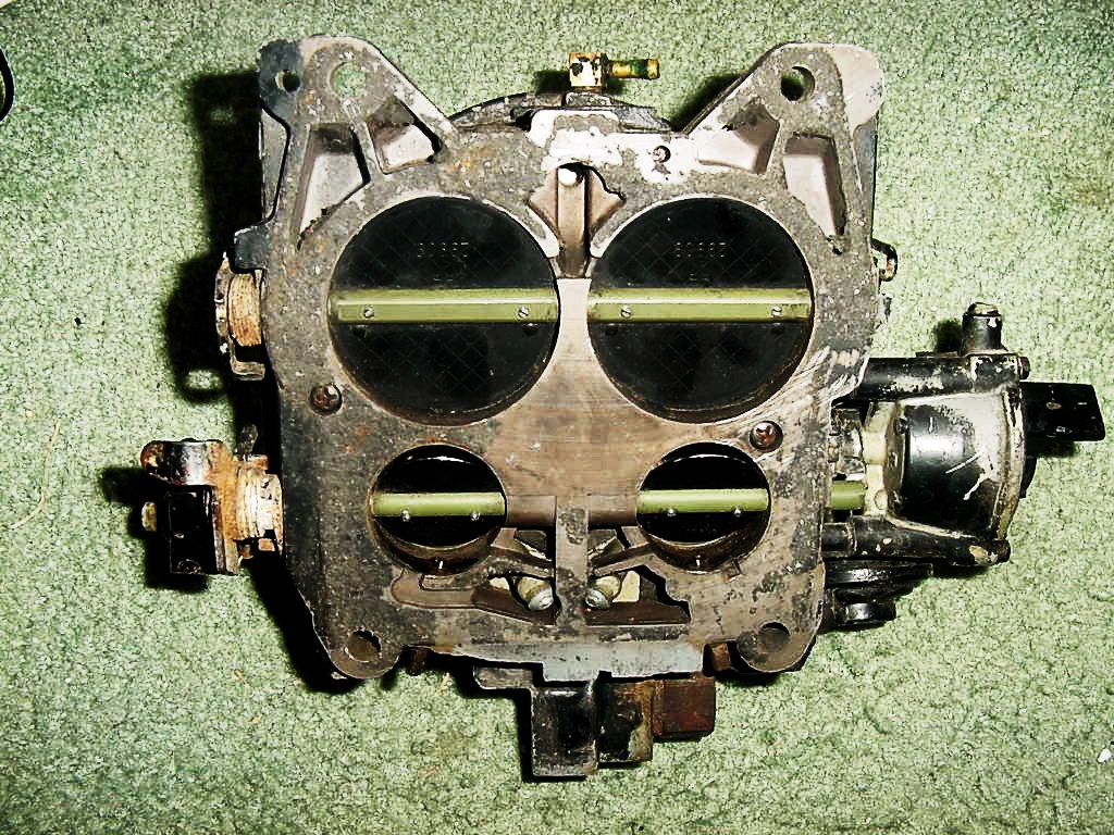

    On the QuadraJet carburetor the primaries are 1.475" while the primaries on the 165/170 hp mercruiser used the 2 barrel Rochester with 1.775 venturis.
    I intend to run my cars with the 4 barrel QuadraJet, a 3.08 or 3.55 rear end and a T5 5 speed so that when I am cruising I can short shift it and when I am on the Freeway I can cruse at 70 without using the secondaries.

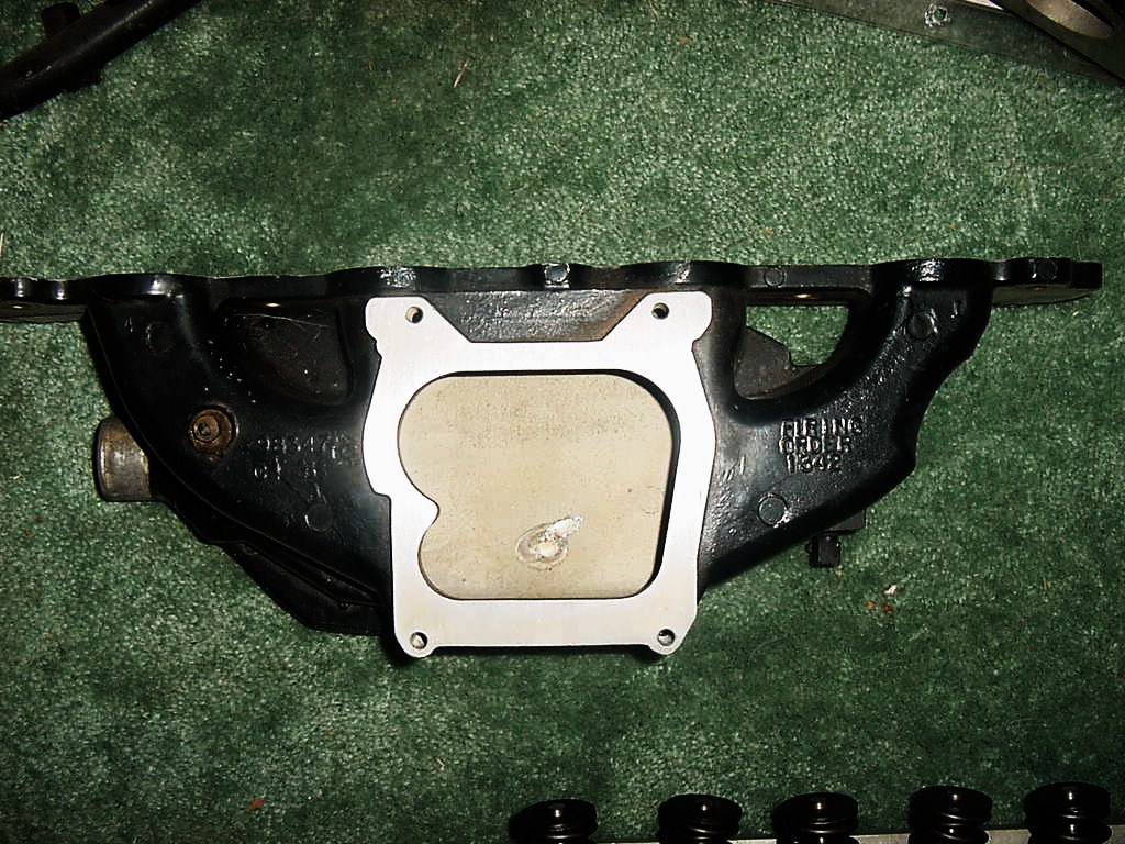

    You wouldn't happen to have an extra quad manifold you would part with? I have searched all the boat shops around here and find nothing but 2 bbls. I have 3 of these engines and grandios ideas.
  19. Mine gets 15 mpg consistently in an 1800 lb car running 3.07:1 rear end and 6.00 16 tires, 2bbl carb, torque cam. It got 22 one afternoon when something was wrong with the timing. I had expected more but it is a lot better than it's preceding engine which got 7mpg.
    I'd see more benefit in turning the engine slower as it has lots of torque and is a low rpm engine. A 3.07 ratio easily makes both tires smoke in low. An automatic would be convenient as there is no linkage to fool with. I've a 3 speed manual transmission.
  20. dawford
    Joined: Apr 25, 2010
    Posts: 498
    dawford
    Babyearl,
    I am sorry that it has taken me so long to respond to your inquiry about a 4 barrel manifold.
    I usually keep good track of this thread but somehow missed your reply.
    I do not have any of the 4 barrel manifolds that I don't have plans for.
    I have bought mine off of ebay and I have had to pay as much as $300.00 plus shipping.
