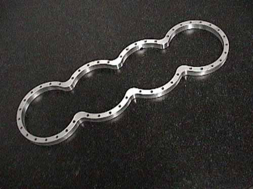

  4. 2000 rpm at 62mph advance is 33 degrees then 37 when it is all in at another 1000 rpm.

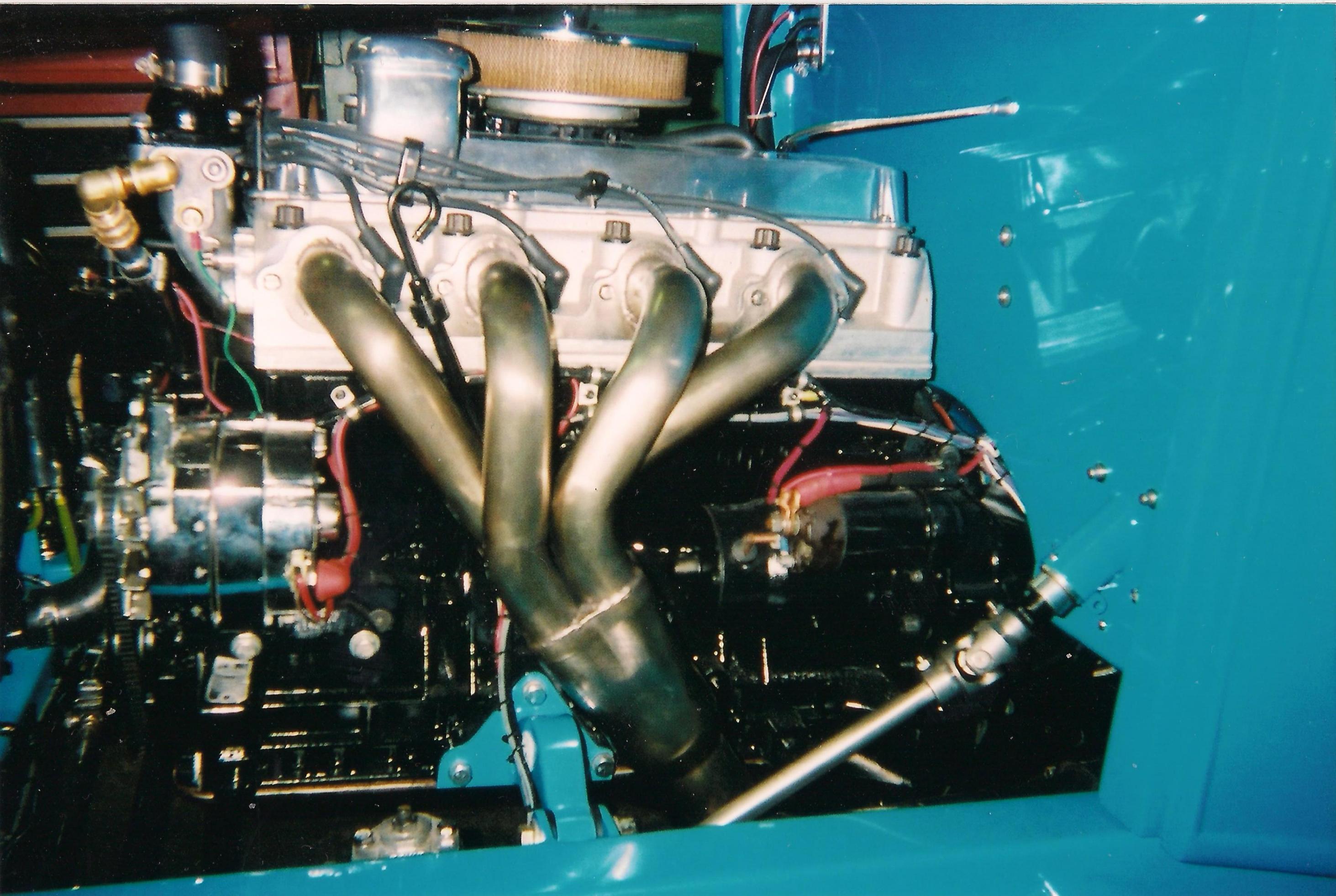

    Here are some interesting pictures from another forum.
    These pictures are posted on page 4 of the Thread.
    http://www.yellowbullet.com/forum/showthread.php?t=415635&page=4
    Notice that this engine uses the Mercruiser 2 barrel intake.
    ray-jay Randy Dupree ran over 12 to 1 compression ratio and never had head gasket problems on the cylinders.
    He had water problems when he used Ford head gaskets instead of Mercruiser head gaskets but the water leak was in the area of the push rod gallery and it was solved by using the Mercruiser gasket.
    I do not intend to use more than 6 to 9 lbs of boost if I use the Buick turbo and dished pistons at just over 8 to 1 compression.
    The 3.0 Mercruiser is 43 ci/in less and doesn't have the cross flow head that the 3.7 mercruiser has and it is heavier to begin with.
    It also has to run 9.5 to 1 compression to get 140 hp.
    After turbo charging it I would probably not get the same Hp as I get with the 4 barrel carbed 3.7 unless it is boosted above good reliability.
    There are several people using turbo chargers on the 3.7 but most of them are out for total performance.
    I am looking for modestly good performance with good reliability.
    Anyway check out the pictures.
    The first 3 pictures are from another post but they are also interesting.
    The second 3 are from the above posted site.
    Dick :) :) :)

    IT SEENS THAT ALL OF THOSE WHO SAY THAT THE MERCRUISER 470 BLOCK DESIGN IS FLAWED MIGHT NOT KNOW WHAT THEY ARE TALKING ABOUT.
    Clint Neff runs this dragster quite well.
    The 1,400-pound altered sports a replica 1923 Ford T body mounted on a 125-inch wheelbase 2001 chassis from Neil & Parks in Burlingame, Kan. The 254-inch four-cylinder engine is based on an aluminum block that a MerCruiser inboard boat engine in 1985.
    David From who built the engine in 2010, used the block because its favorable 4.900 bore spacing accommodates the Ford E-460 Pro Stock aluminum head.
    With a Comp Cams cam, Australian-made Motec fuel injection, and MSD ignition, the engine puts out 625 horsepower. It is sent through an Ace clutch and 2.98 low-gear Liberty transmission to a Strange 12-bolt drop-out rearend with a 5.86 gear. The launch RPM is 6,600-7,000, and the revs are 9,600 at the shifts and the finish line.
    The best times for the car are 7.78 at 168 on an 8.41 index.
    See below:
    http://www.competitionplus.com/drag...and-his-little-racecar-looking-at-big-picture
    Dick :) :) :)

  16. Can Hard block be put in a water jacket to fill just the top of it?
  17. Randy's reference to the Chevy 153 {chevy 2} distributor is valuable. I just checked and they are available for a little over $30 [rebuilt]. It would probably pay for itself in reduced fuel consumption. There is very little room around the distributor but it looks as if can be rotated so the vacuum part is outward pointing away from the engine .
  18. dawford
    Joined: Apr 25, 2010
    Posts: 498
    dawford
    dennis,
    I though about that some time ago and decided that I could be done by heating the block enough to match the temperature of melted paraffin (125 to 165 degrees).
    Then by filling the void from the bottom up with melted paraffin using a funnel to avoid letting the paraffin touch the sides where the Hardblock has to bond with the aluminum.
    I would leave the paraffin down 3/4' or so from the top and then pour in the Hardblock.
    Paraffin dowels could then be set vertically onto the paraffin before it completely cooled to allow the paraffin to later be melted out.
    The paraffin dowels are called sprues in lost wax casting.
    I would put them every where that the head gasket has a water hole.
    The Hardblock could be left down 1/2 to 1" down from the top to allow water to cool the head gasket seal.
    If there was a concern about hot spots on the cylinder bore double sided tape could be used to hold half round or square paraffin sprues to the wall every so often to allow water contact to be more uniform.
    After turning the block over and heating it to melt tie paraffin out the tape could be removed with a narrow chisel
    I was also wondering if JB Weld couldn't be used in place of the Hardblock cement although it might not transfer the heat as well as the Hardblock.
    It might bond better with the aluminum casting. A thin layer of JB top and bottom might seal the cement better.
    All of this is unnecessary unless you intend to produce gigantic hp.
    For a street machine or a real driver this would be overkill.
    Dick :) :) :)
