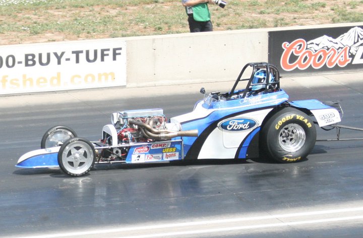

  4. I'm still looking for the pics of my dragster in '86 with the 485 in it.
    This engine is alive and doing well in NHRA Comp.
    Clint Neff drives a K/A and won the Mile High race in Denver last year ('11)
    Here's a video of one round
    http://www.youtube.com/watch?v=l5WLs0JurF8&feature=related
    The car went 8.32 at that all***ude and has run as fast as 7.78 @ 168.6 MPH!
    How's that for a 4 banger with no power adders!
    Here's a shot of the new engine "Diana" and the car

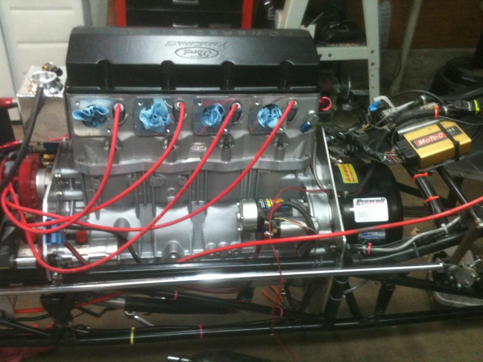

    Here are some pictures from last season. This is the 3.7 Mercruiser motor. It is bored .030 over and the original crank was offset ground to 4.050. It has a 600 cfm 4 barrel and we run it on alcohol. The last picture is of the new drysump system we are installing for next season.

    Probably so but my cousin had this lying in his shop form a Nascar sale and said I could use it. Needless to say, I didn't turn him down on the offer. :)
  10. Completely understandable... by the way, that is a very fancy pump.
