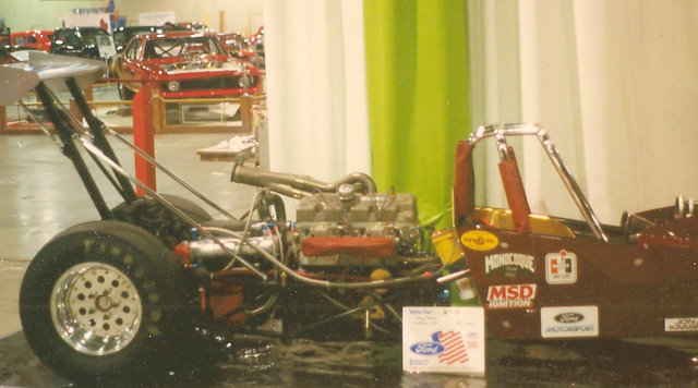

  20. jmayabb
    Joined: Nov 18, 2009
    Posts: 21
    jmayabb
    from Kentucky
    This is probably the coolest Mercruiser build I have seen. This is Clint Neff and he is the current NHRA comp eliminator record holder. He is running the new NHRA Ford pro stock head.

    Dennis- the studs are supposed to be 6.4". When I talked to the engine builder he found some about .400 shorter, but the orderdesk clerk lady said she wasn't aware of any such thing....? If the bullet nose is 3/8", then we are matching for the Boss9 head. The other .400 shorter one might be better for other heads. Like I say nothing as good as having it in my hand to mock up...so I'll stay short of offering much more until then.
    JMayabb As you likely know- bit for others- that's called JC51 head -for Jim Cunningham, a racer who provided much of the impetus (read:$$'s) for Ford to get back into Prostock.
    What's interesting is with the old E460-headed build, Clint and Mr From, from whom he bought the car, are already equaling the (halved) output of Prostock cars while running 400-800 fewer RPM. Mainly it would seem that they have extra displacement (500cid limit in P/S, so they have about 25 more CID, which is ~50hp per 4 cyl's at this level). Still a very very impressive engine program...
    Don't happen to have a bigger photo, do you??

  25. I found a couple of photos of the Kaase Shotgun MC engine in the dragster. This was about '84, I think. I hope to find more.

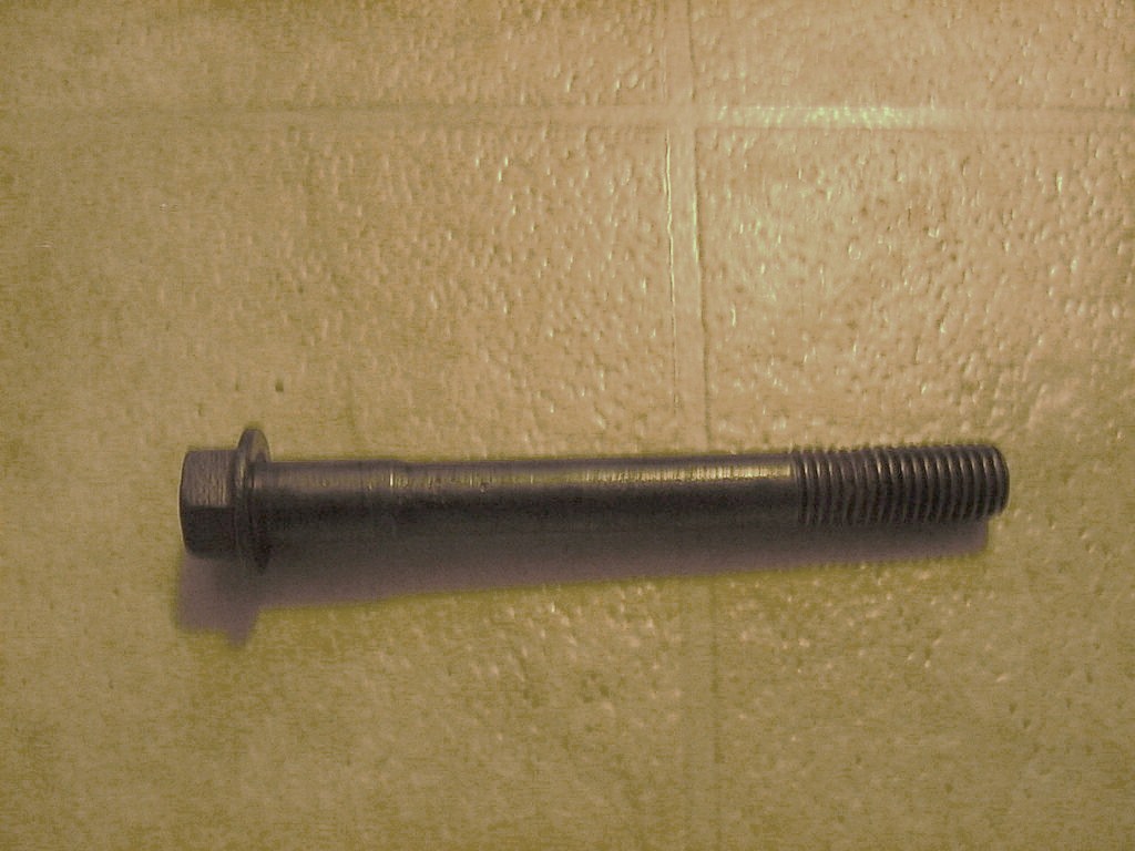

  27. dawford
    Joined: Apr 25, 2010
    Posts: 498
    dawford
    The threads are 1.5" long.
    The Mercruiser head bolts are tapered down about 1.25" from the head and do indeed have 1/2" threads making the threads 3 timed as deep as their diameter.

    Are you saying threads measure 1/2" OD?
    double checked mine, 5 1/8 and 4 3/8" long, indeed it does taper down to 1/2" OD, but threads measure 9/16" OD x ~1.5" length
    9/16" x 1.5" ~2.6 times dia
    9/16" x 1.25" ~2.2 times dia
