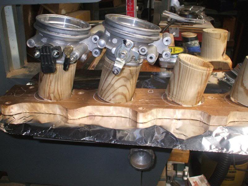

    I spent half a day working on an intake plug for casting, it's coming along nicely.
    I am using Buell 55-59mm throttle bodies.

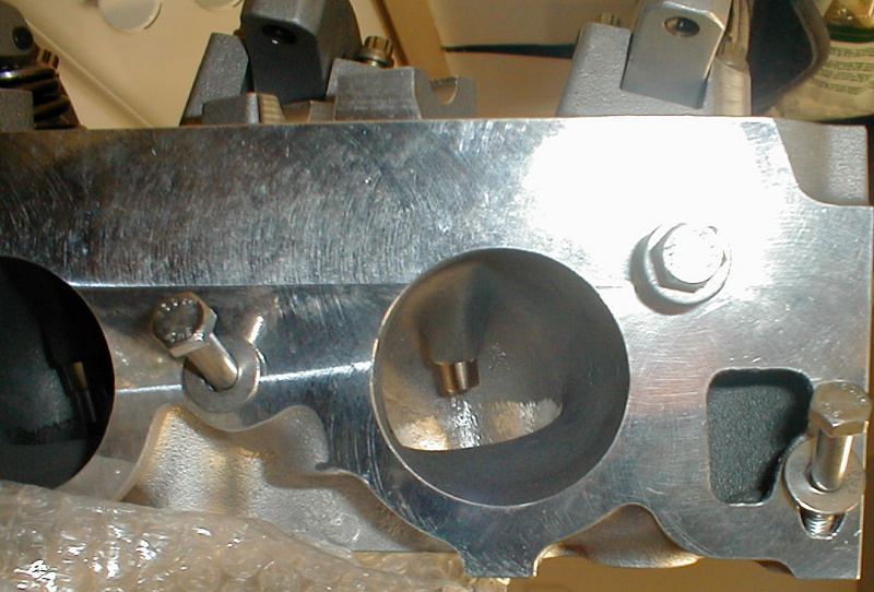

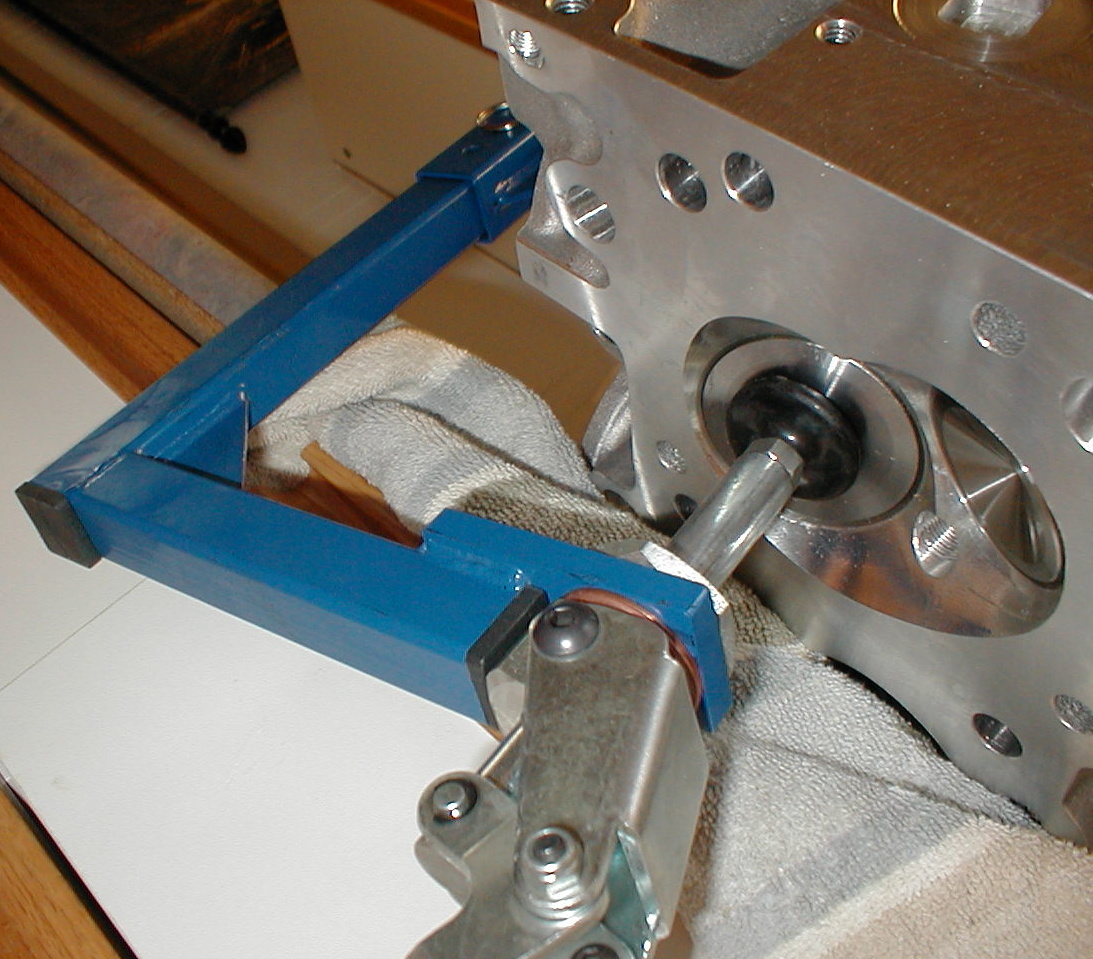

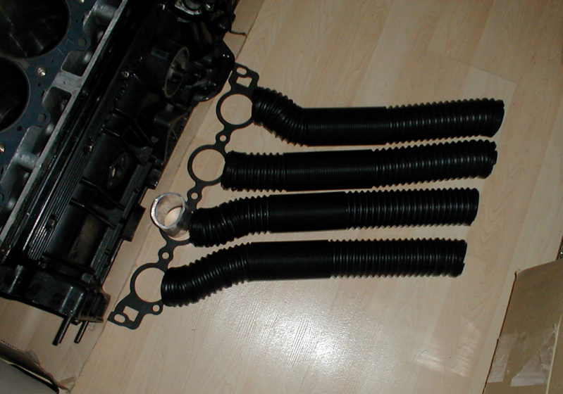

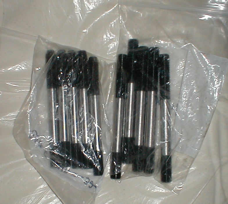

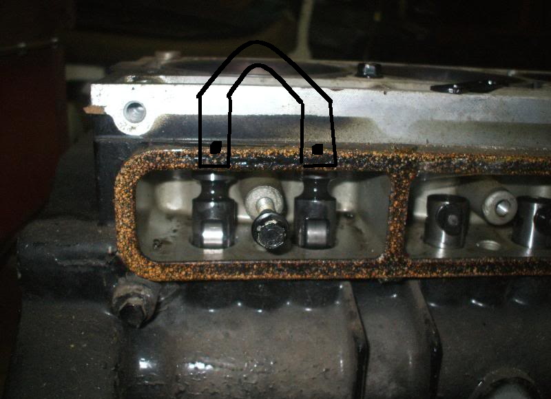

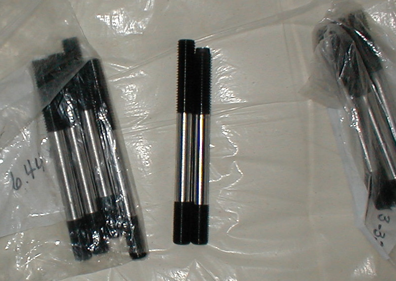

    Anyway I will come back to throttlebody size, but I thought I'd post a few attachments of the parts gathering I've done so far.
    You remember I had wanted .500" shanked studs- well I got the exact dimensions I needed by buying C&C Motorsport's studs and having them machined down.
    I also am showing a pic of the 3 angles of the intake bolt holes on a Boss head. The side of the head is 9 degrees to vertical (99 to deck). Then NONE of the intake bolt holes are 90* to that. I was just doing casual measurements for later, but my hand written notes seem contradictory- it seems one pair is 45* to Deck, another is 22.5degress to deck, and one is something in between- about 33 degrees. Looks to me like in at least two of the 3 cases, they referenced the deck rather than the actual mounting surface when chosing machining angles.
    I looked elsewhere where I'd drawn some not-to-scale doodles and see when I referenced the intake mounting surface I called out 38(142)*, 9*, and 60(120)....?? Obviously I am confused. Not too many are using Boss heads, so this is mostly my problem..lol
    The black corrogated tubing is stuff I use to lay out tubing runs- it holds its shape very well. The "closed up" sections would be where I position the throttle bodies. The rest is to get a "tuned length". Also shown is the D-shaped tubing- I will weld on a "tongue" to the intake flange that sits on the floor of the port to decrease area.
    The other pics show changing from dual "roller" cam springs to single "flat tappet" springs using the very trick cam action compressor loaned to me by a friend.

    I don't see why the link bar is being thought of as unchangeable. It's a flat bit of steel, easily welded etc. When the below link bar dropps down it will be below deck. Its odd shape doesn't mean anything- it just needs to keep the lifters aligned. Ther are not great or unusual forces on it.
    Of course you'd still need a steel core. I suspect what Neff and From did on the 9600 rpm dragster is run a steel machining that didn't have oil pump /distributor gear due to running dry sump/crank trigger

    Deck plate
    also clearly visible in the following two pics (934+935) and the attachment of Clint Neff's (maybe still with help from Canadian David From??) newest build, which is to supercede the engine that went 7.78 all motor.
    So, I guess those who wanted an "option" to get around the open deck liner design, there you have it. Machine the stock bore tops' outside diameters round (or for a full race build you will already have installed new liners), machine a ~23 x 8 piece of .75 or .875 or 1.0 alloy to fit the 4 bores at 4.900" spacing and the headbolts, cut away the outer perimeter of the Mercruiser OE block, press together. Route cooling as you see fit.
    Not 100% sure how sealing to the block & liners is best done, but anyway, two experienced engine builder both came to this solution separately.
    Note the photoed build using the race heads with 4 extra small external head bolts/studs per side, and that these are tied to the deck plate, which makes me curious how the deck plate is held to the block? or does it just mean then deck plate is sandwiched to the block by the primary 10 head studs and the outer ones just leverage off that?

    No, each cylinder on a Buell has it's own throttle body:
    http://www.ebay.co.uk/itm/Buell-112...rcycles_Parts_Accessories&hash=item43ac7cec9a

    The link bar can be changed, its clearance that is an issue. The "U" shaped link bar isn't a bad idea, if they are dropped in with the link facing the cylinders.
    The steel core is not a must, just increase longevity.

    Running a cast core and rollers seemed to work for late 80's early 90's small blocks of both Chev and Ford, but in the aftermarket it is a bit hits and miss. I used to be a counter person at a speed shop, and before that a supervisor of warehouseman for the same company, and I've handled a lot of "warranty" cast iron core rollers, and gave a sympathetic ear to the owners of 'em.
    That said, I also don't think you can treat *any* cast core to be roller suitable,- I think the core itself is different material.
