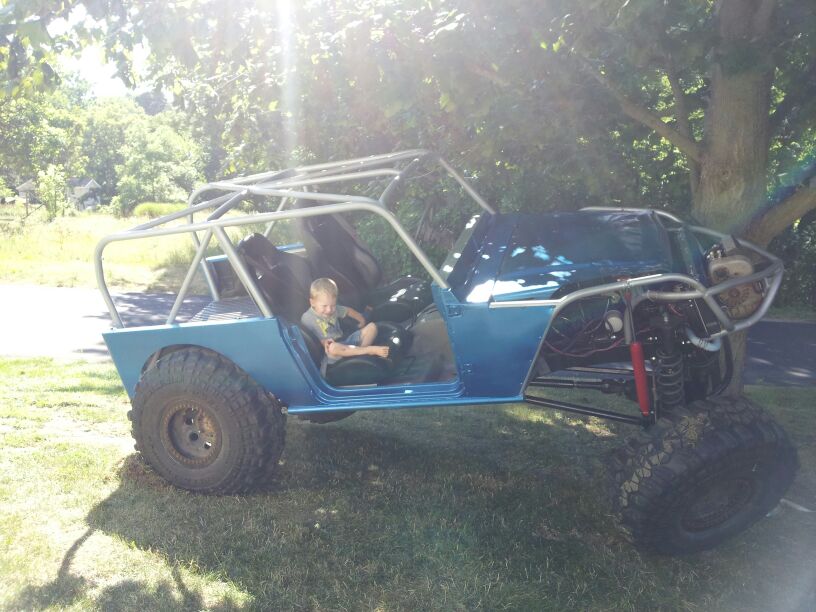

    I have a Suzuki Samurai that has received a few modifications, one of which is this cool motor.
    Drivetrain consists of the 3.7, TH350, the front half of a NP231, and a Dana 300. Toyota Mini truck axles and 38.5 super swampers.
    I'll try to provide more details later. I've been working on this for over 2 years, and hope to take it on it's maiden voyage this weekend. I just have to get this carb sorted out.

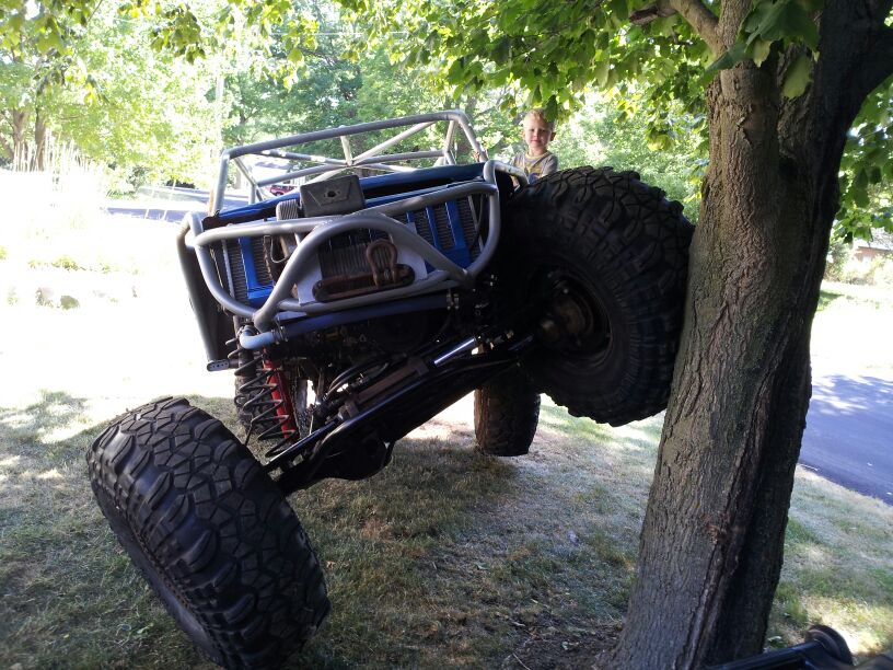

    [​IMG]Yesterday I took my Mercriuser powered Samurai out for its maiden voyage, and all I can say is WOW!
    What an awesome motor for an off-road rig. It has an amazing amount of torque, and pulls hard from a low idle to wide open-put a smile on your face-squeal like a little girl-hang on tight-things are getting squirrely-ok I better lift but I don't want to!
    I still need to fine tune my jetting, as
    I'm still running rich, but wow that was fun.
