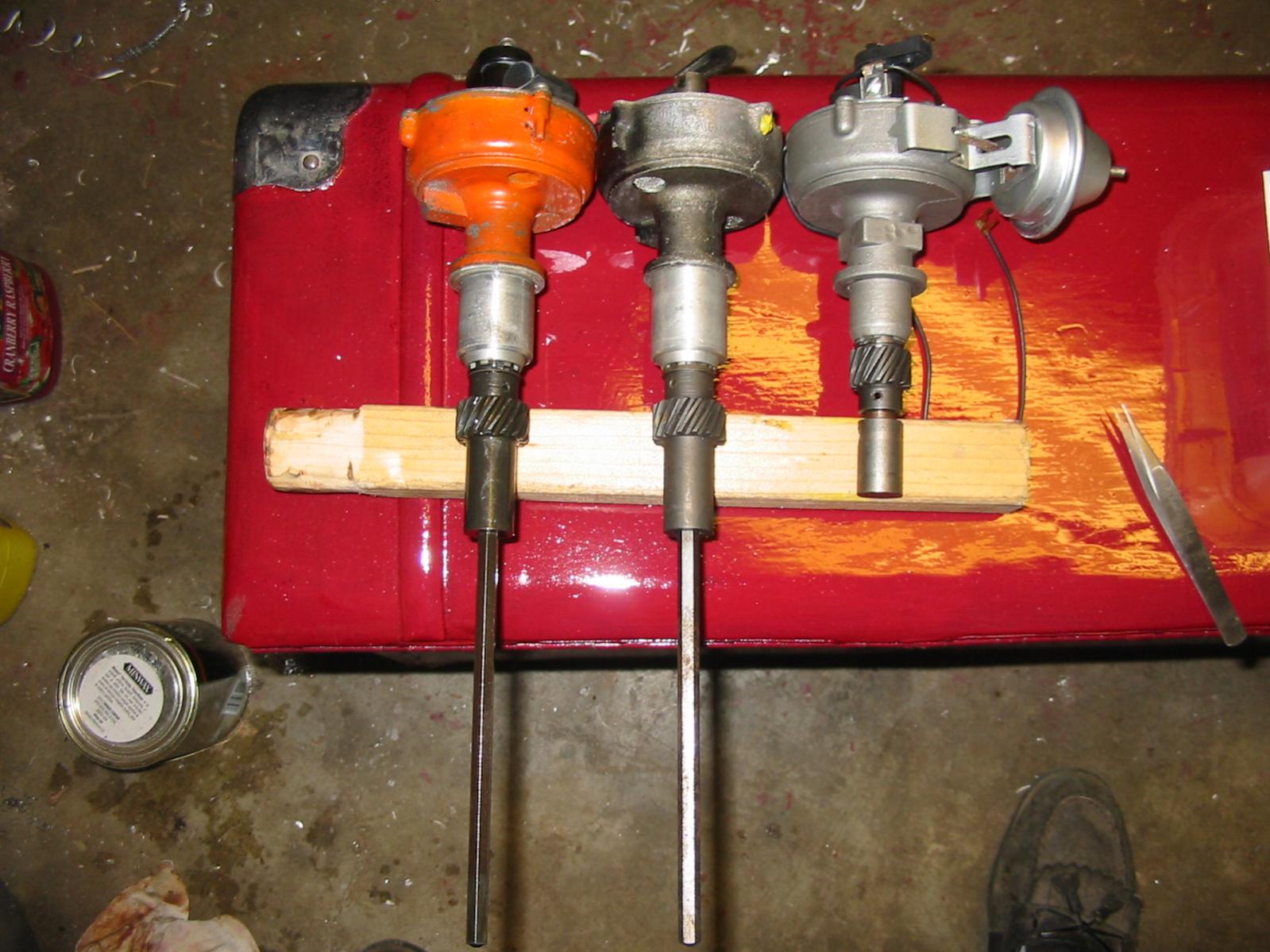

  7. Vega and Mercruiser distributors compared.
    In a side by side comparison, there are differences, but not so big that they can not be overcome.
    The vega distributor has a different gear which is mounter higher on the distributor shaft.
    The vega shaft is 7mm longer.
    The vega shaft extends 2mm more into the cap than the Mercruiser shaft
    Expect the two rotors to fit but a Vega rotor can cause an erratic misfire in a Mercruiser which can be frustrating to find. (guess how I know this)
    The bodies appear to be the same casting with the mercriuser distributor body neck bushed longer and fatter.
    The mechanical and vacuum breaker plates interchange. A little slot needs to be filed out for the vacuum pot arm. And two holes drilled and tapped to mount the pot.
  8. Vega and Mercruiser distributors compared.
    Differences:
    The gears do not interchange
    The shafts are different the (Vega shaft is 7 mm longer is drilled differently.)
    A Mercruiser distributor has a shaft oil seal
    The rotors are keyed differently to prevent accidental interchange.
    The bodies are close but different. the Mercriuser distributor body neck is longer and bushed to be fatter.
    To make a vacuum conversion, you will need the parts from two distributors.
    Adapting the Mercruiser distributor body by drilling and filing is far easier than machining the Vega distributor body, making a bushing, putting a bearing (bushing) in its end and inventing a lubrication scheme. The Merc shaft is the one to use as it is drilled properly for the oil pump drive extension.
    The shaft can be shimmed up and down to fit the cap using washers under the advance mechanism. I measured end play on all three distributors at .035 thousandths. If it was shimmed to 10 thousandths end play timing would be more accurate.
    Merc parts to adapt a Vega distributor:
    distributor shaft (Merc)
    drive gear (Merc)
    delco lower bushing (Delco)
    adapting sleeve ( you make it from billet)
    rotor (merc)
    cap ( depends how you shim the shaft)
    Vega parts to adapt a Merc distributor:
    Delco advance plate with advance mechanism
    Delco vacuum pot

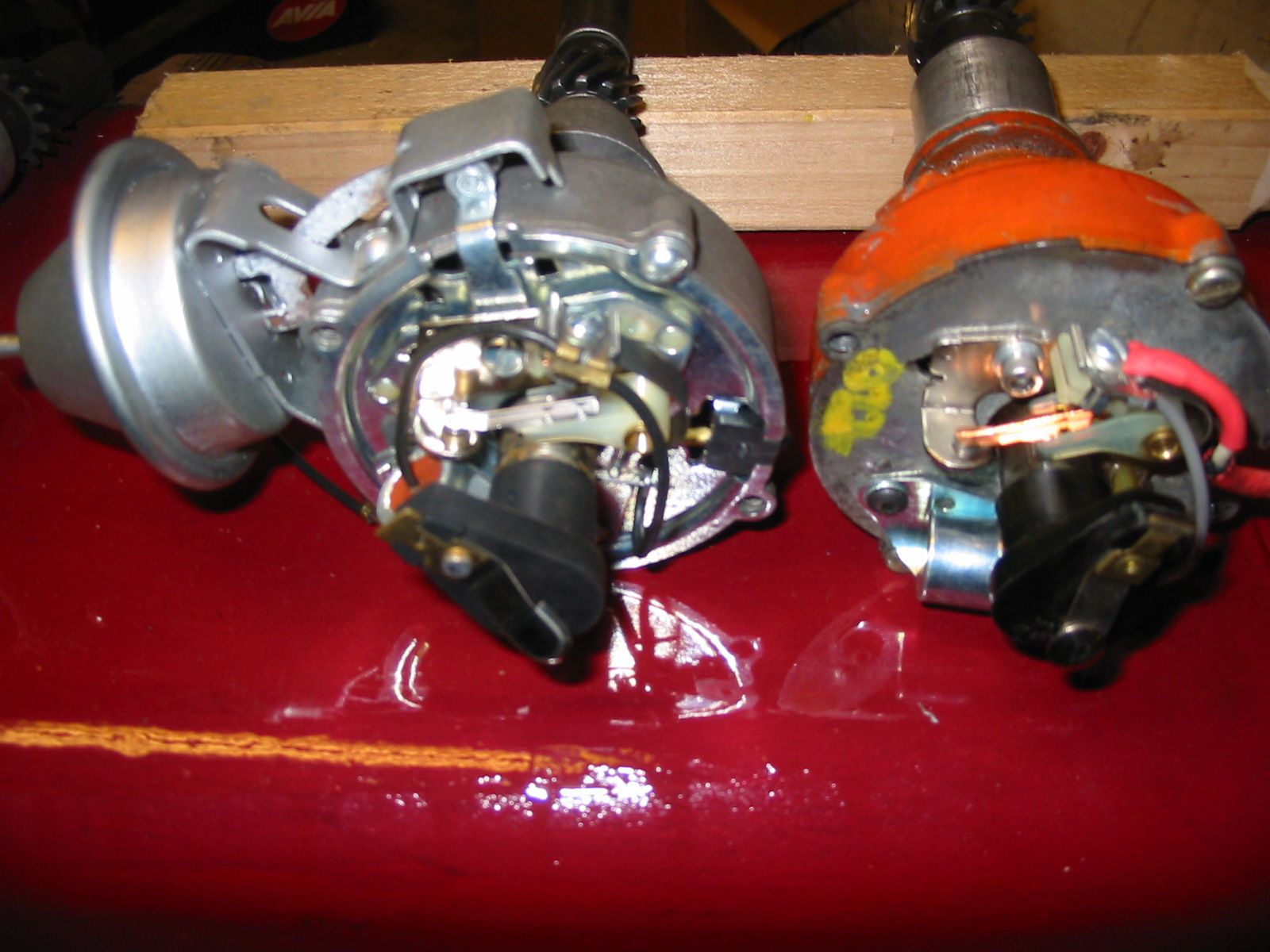

  21. A side by side comparison of two distributors I used in a mercruiser distributor conversion. Easy even if they are not quite the same. M&v.jpg ........ merc vs vega top.jpg
    It was not too hard to make them the same length. The shorter one is a 1974 Vega distributor. They can still be found.
    Note that the Mercruiser distributor has a vacuum advance slot in its casting.
