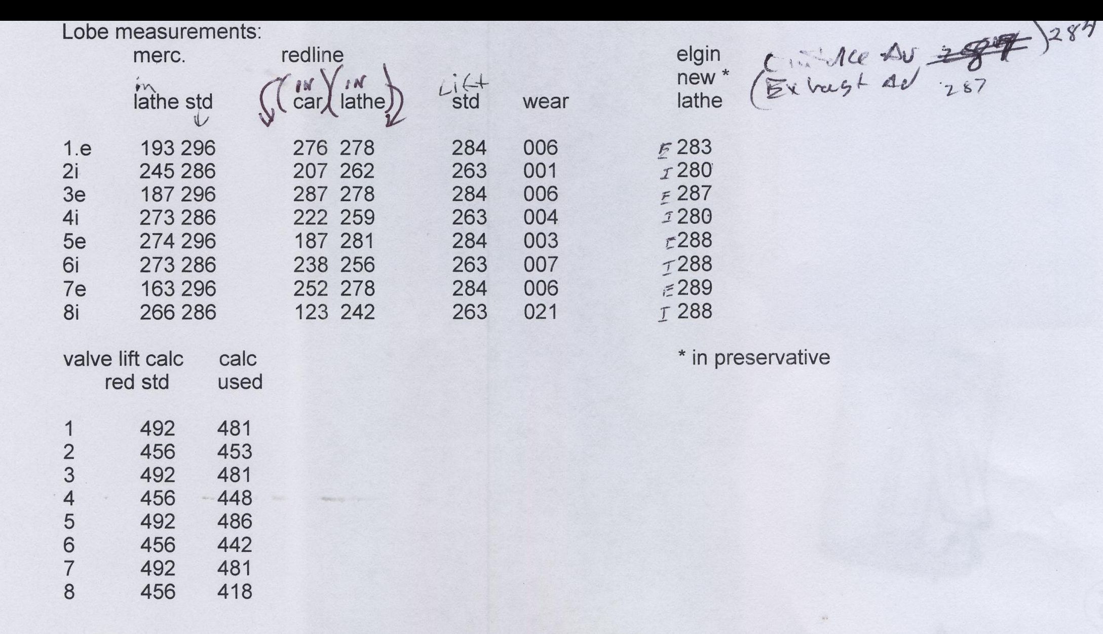

    As thorough as you are, I'm sure you must have specs for both grinds. Please tell us the difference between the two cams.
    This is the card for my preferred cam. One of my lifters was not spinning well and wore a lobe a little so I replaced it. Even worn, I preferred this cam to the one which replaced it.
    click on the image to enlarge it.

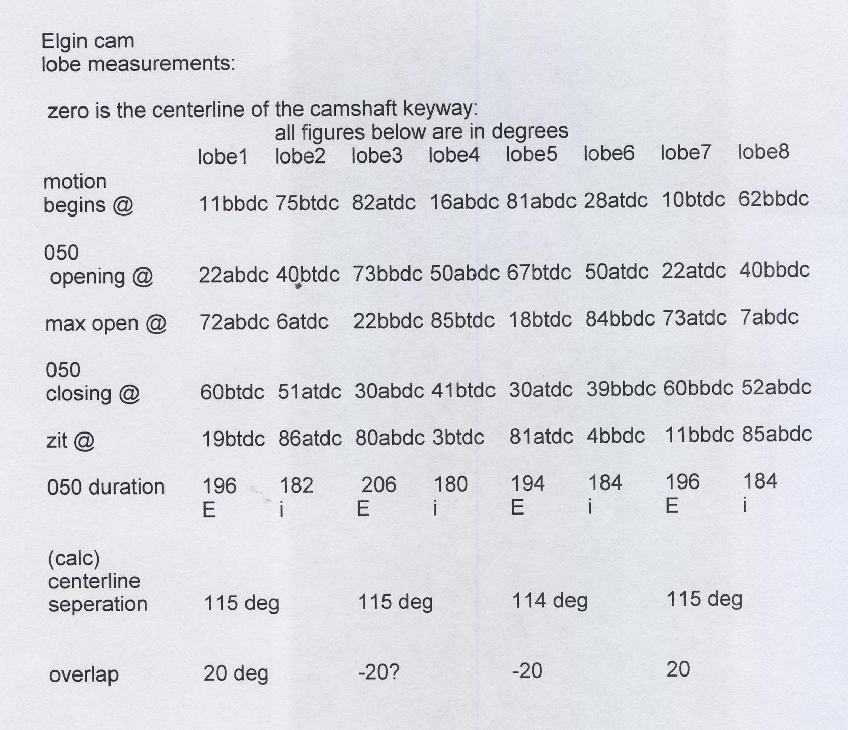

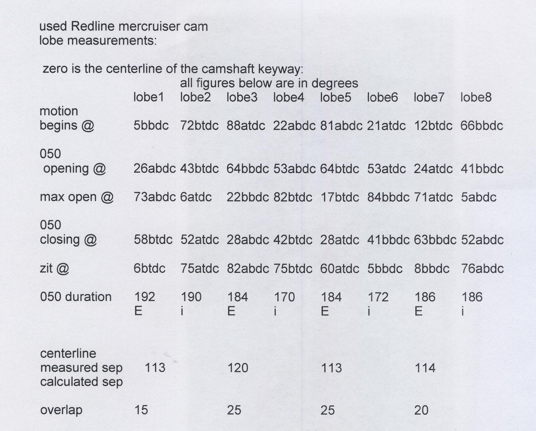

  20. these are dial guage measurements that I made with the camshafts mounted in my lathe.
    As one end of the camshafts were mounted in a 3 jaw chuck there will be imprecision in the measurements. The other end was held in a live center.
    click on the images to enlarge them.
    the 3rd chart compares a new elgin cam and a worn redline cam.
    The numbers seem close, but there is a difference.

    I'm ***uming that the lift is gross valve lift using theoretical rocker arm ratios. if it is lobe lift, that is a fairly aggressive grind for a non roller design.

  23. Sorry, I did not make that clear, It is at the end of the rocker arm not the actual lift at the lobe. I did measure it on the engine but was not able to get lift measurements which were consistent enough for me to have confidence in my measuring procedure.
    the rocker arm ratio is 1.73 :1
