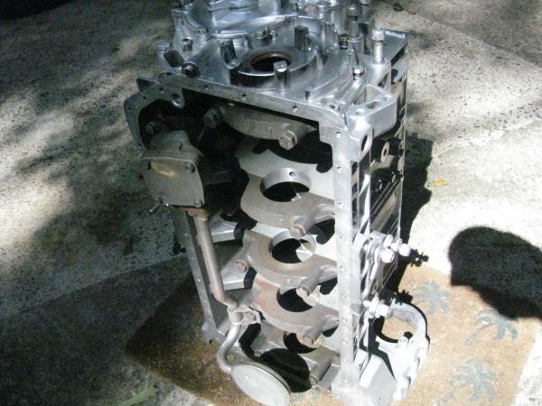

    tscheerer

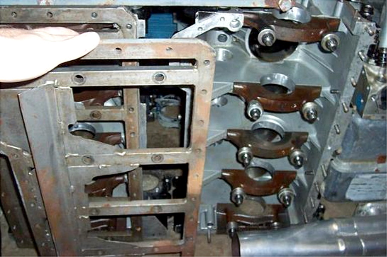

    Will a 460 main girdle fit this engine? Looking to build a turbo 3.7 and will use one if it fits.
  24. iadr
    Joined: Apr 14, 2007
    Posts: 147
    iadr
    No. The Ford 460 bottom end looks quite a bit different.
    However it is not hard to design a main girdle as the Mercruiser main cap bolt bosses and pan rail are all very close to being on the same plane. Measurement has to be dead on, but from there... fairly easy
    I would say a turbo of this is likely to be troublesome. The free standing bores and the block being (allegedly) die cast instead of sand cast, means there are multiple weak points once you get up into the 350+HP range. As always it depends a lot on tune.
    I think the sweat spot for these is a fully built naturally aspirated 260-340hp. The ones beyond that, the Puerto Rican "Mitsubishi" drag car, the Randy Dupree Salt flats car (his girdle photo'd), Neff and From's Comp Eliminator, and Sarge Nichol & his son's drag build build are all pretty serious engineering projects.
    If you are talking a new power plant for the white Mustang as your avatar, I think you will have more trouble reaching your goals than with using a 2.3.
