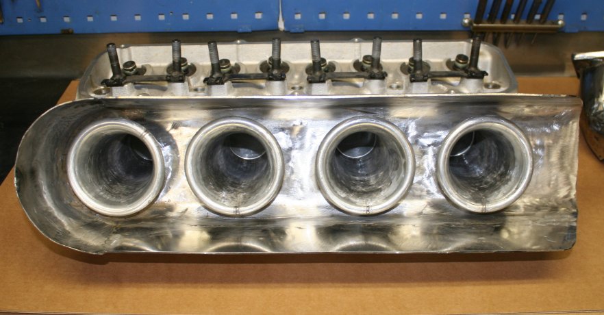

    don't drill the head for the water port,just drill the intake on each end and use a 1'' ****** to return the water to the rad,make a "Y" to run both 1'' lines together,then go to the radiator.
    This is better because it cools the back cylinder better.

    The problem that I am having with just drilling the intakes and putting 1" ******s is that the aluminum heads have a lot bigger water ports than the cast iron heads had. Neither the 2 barrel or the 4 barrel mercruiser aluminum manifolds quite cover the hole so I am going to fab a 1/4" aluminum spacer plate to fully cover the head and allow the original Mercruiser manifolds to work.
    The original Mercruiser Maniforld should flow good the way they are. The 2 barrel is a 500 Rochester and the 4 barrel is a 750 Quadrajet.

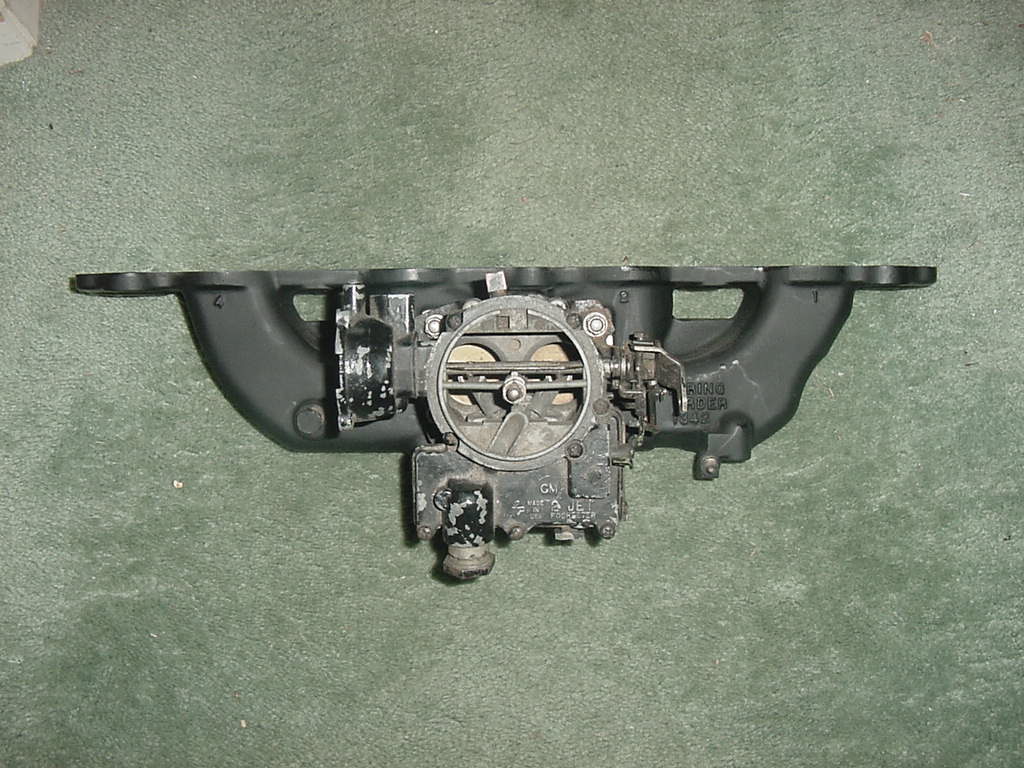

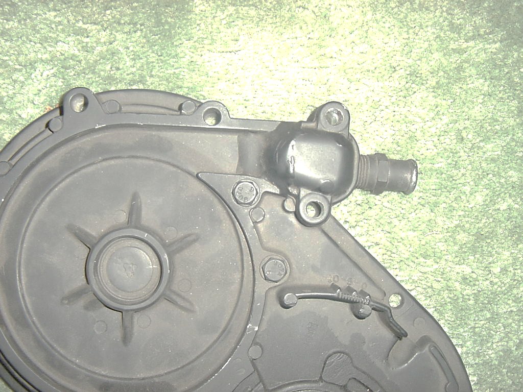

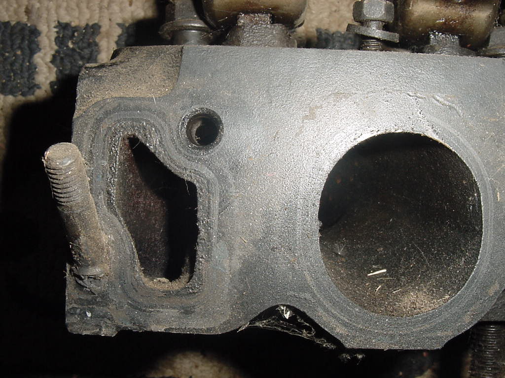

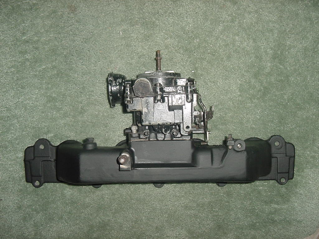

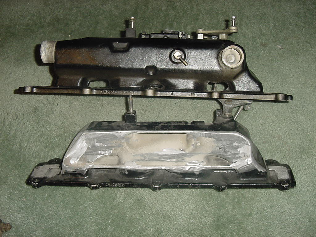

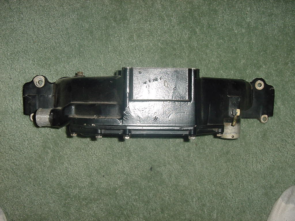

  7. **** show us a side view photo of your manifold with the water jacket off. I nearly milled mine off but stopped as the water jacket did not seem harmful.
  8. Excellent, thanks, I'll do it your way... the merc way seems much less strong and more plugged up.

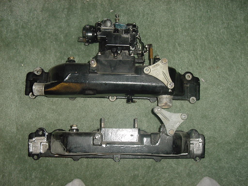

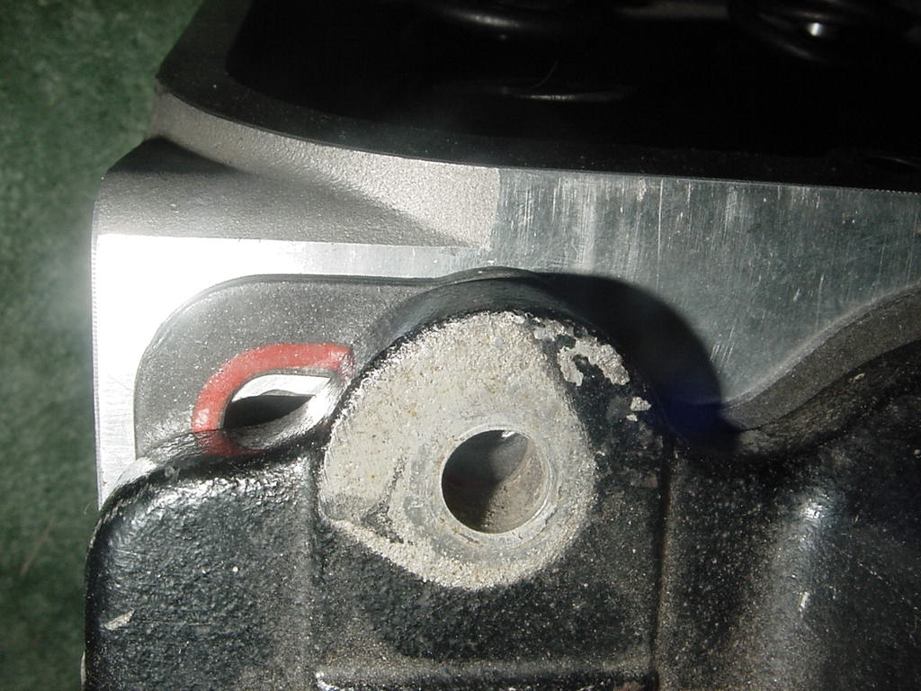

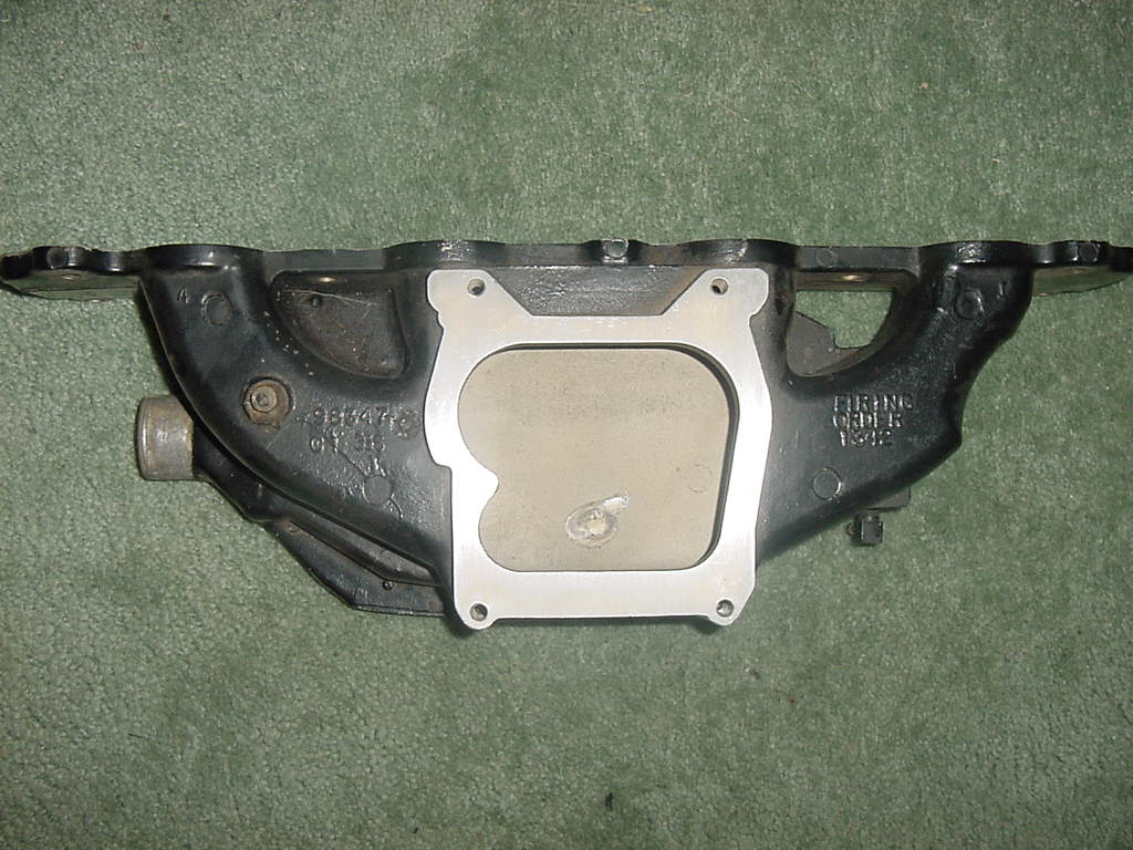

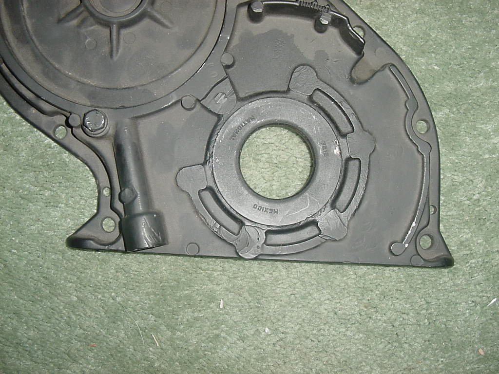

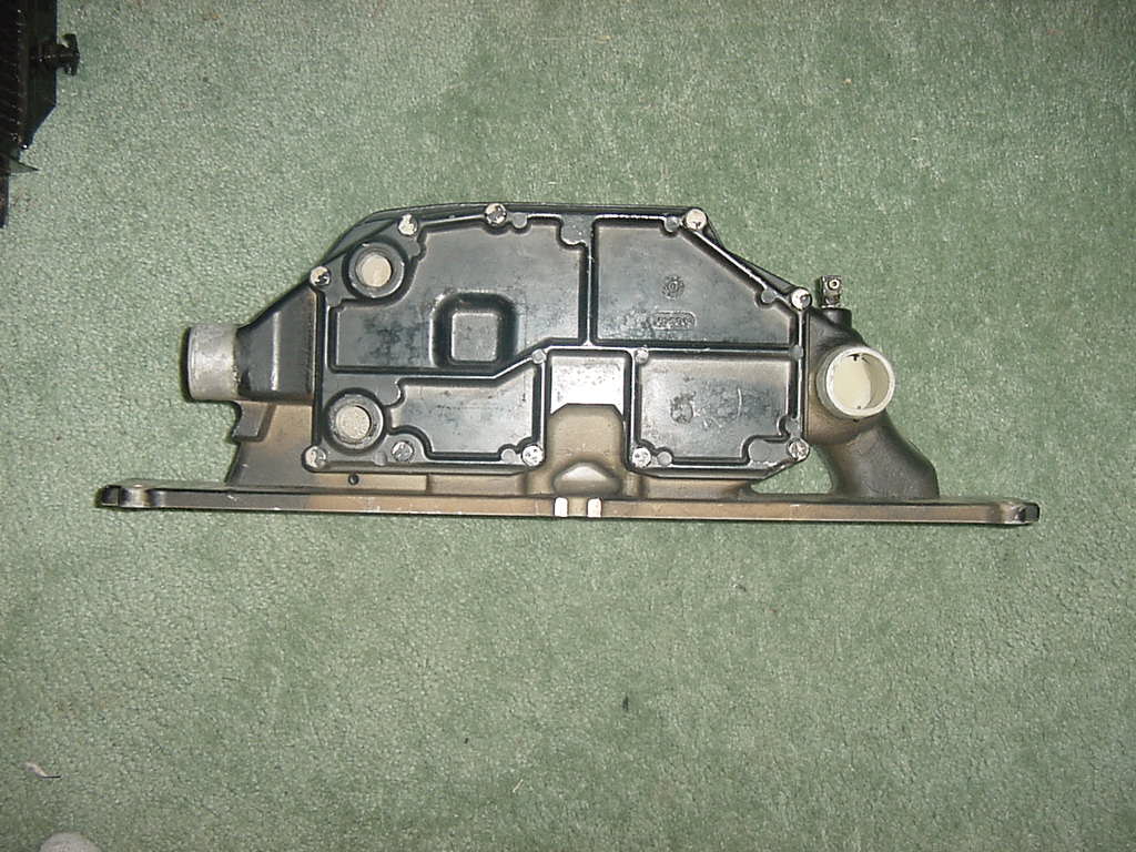

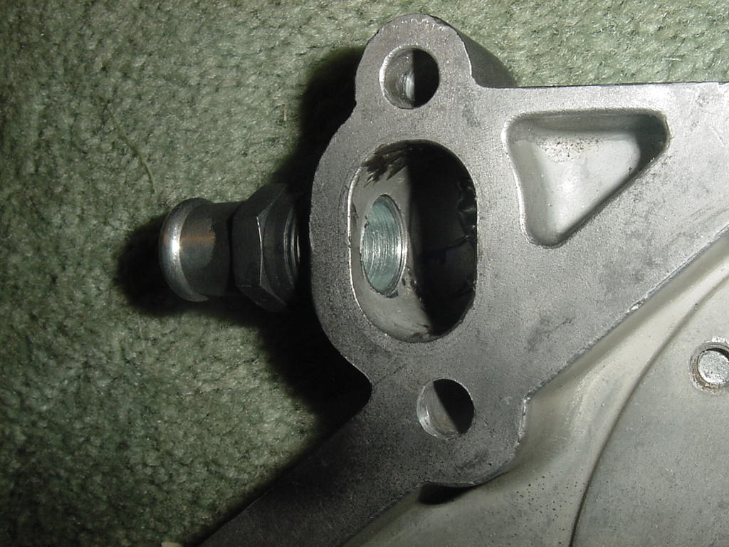

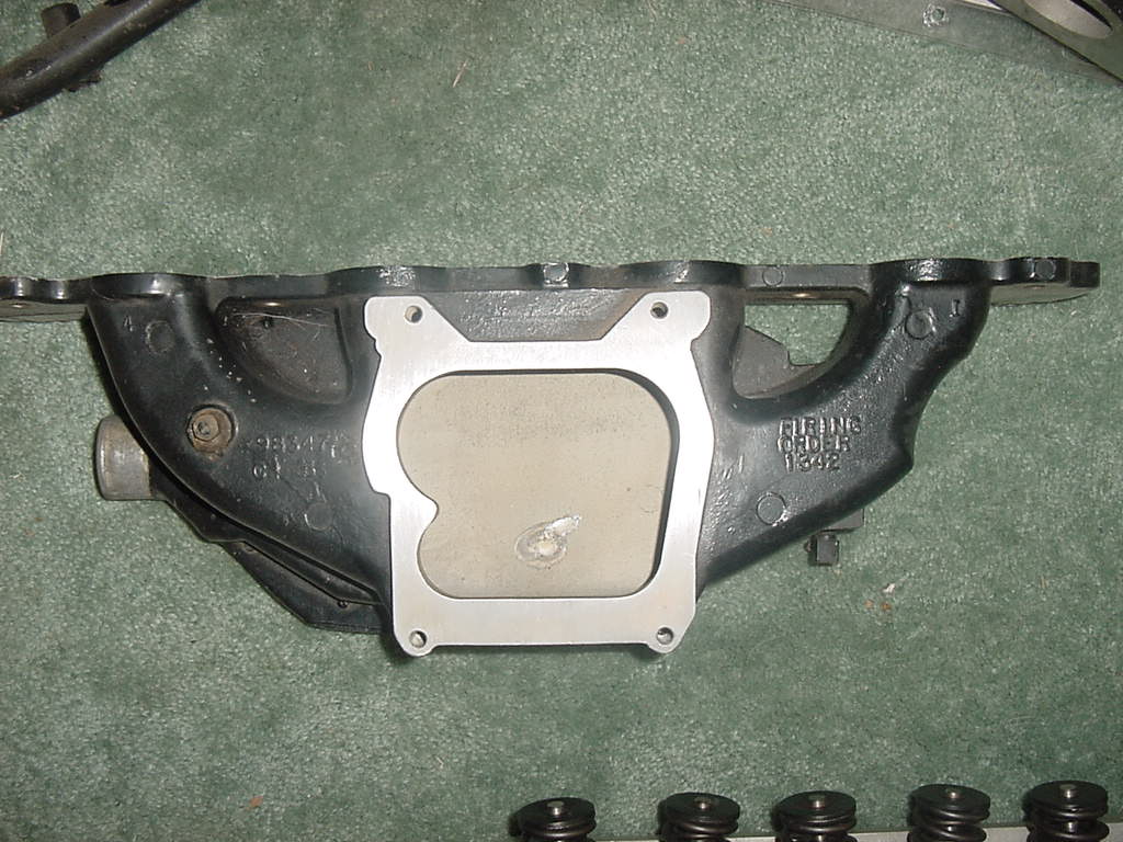

    I found the 4 barrel manifold and I apparently didn't mess with the water jacket or the oil cooler. I think I will initially leave them alone in case I need the heat for warmup.
    It would also be a kick to run ice water thur it if I install a Turbo later.
    Here ar the pictures you asked for.

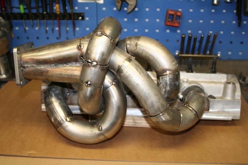

    Here is a thread that I copied from "turbo on a 235 inline.
    It was authored by Mart3406.
    If you want a cheap and 'near bolt on' turbo set up
    for your 235, maybe think about a complete set-up
    off of a late '70's carburated turbo-Buick V6.
    These were used on 3.8 itre V6's in late 70's. I
    picked up one in a boneyard a few years ago from
    a '78 Buick Regal and put it on an otherwise stock
    slant-6, in an in O.T. '81 Dodge D100 pick-up. The
    late-'70's Buick set-up is a 'draw through' system,
    with a Rochester Q-jet mounted to the inlet of the
    turbo, via a cast aluminum adaptor.The size and
    layout of the Buick turbo set-up happens to be
    just about perfect for adapting to an inline-6. To
    fit it to the Dodge, I used short piece of 2-inch
    diamiter stainless steel exhaust tubing, with
    flanges welded on the ends. The turbo mounted
    to the stock slant-6 intake manifold, sitting just
    above it, with the stainless exhaust tubing
    connecting the turbo's compressor outlet to
    the carb mounting pad on the slant-6 intake. For
    the exhaust, I had another piece of stainless
    exhaust tubing - this time 2 1/4 inch diamiter
    - bent in a "U" shape, with flanges welded on
    the ends to connect the outlet on the stock
    slant-6 exhaust manifold to the inlet of the
    turbo's exhaust turbine.
    For an an exhaust system, I had a 3 inch diamiter
    'downpipe' made up, that went from the exhaust
    outlet on the turbo and connected under the truck
    ito to a homemade 3 inch inlet and two - 2 1/2
    inch outlets "Y" pipe that fed into a pair of
    2 1/2 inch inlet & outlet X 30 inch-long resonators
    and a pair of turnouts, exiting just ahead of the left
    rear wheel. Even with two side by side, straight-through
    resonators and turnouts, the turbo acted enough as a
    miffler, that until you were really on it and making
    boosrt, the system was still resonably quiet and not
    a whole lot louder than stock.
    I had the downpipe and turbo mounting and exhaust
    tubing bent up for me at a local mufler shop and a
    little trick I used to get the bends right, was to use
    exhaust 'flex flex pipe' to mock everything up. When
    I had the flex pipe bent the way I needed it, I
    brushed on some epoxy cement and let it harden. Then
    I took the pieces of flex pipe to the muffler shop and
    got them to rplicate them in stainless steel exhaust
    tubing. I made the flanges up myself at work, from
    some s**** 5/16 304 stainless plate
    To lube the turbo,I found an unused oil port on the
    side of the block. I plumbed into it by removing the
    stock pipe plug from it and replacing it with an NPT
    to AN adaptor fitting. Then I used a length of braided
    hose, -also from work - to connect to the oil inlet on
    the turbo. For the oil outlet, I simply ran a line from
    the turbo into a br*** hose fitting that I epoxyied
    into the the side of the valve cover. The only other
    even 'semi-major' mod I made was changing the carb.
    The stock Buick Q-Jet is an electronic "feed-back" carb
    and used a computor.whiich I didn't have and wouldnrt
    have wanted to try messing with anyway. Probably any
    old style 'non-feed-back' Q-Jet could be made to work,
    but I had a 'Holley 'list 80552' 650 cfm 'sreadbore
    replacement' marine carb collecting dust on a shelf that
    I rebuilt and used. The carb worked great almost
    'as is' with only some linkage fabrication and
    going 3 jet sizes richer on the secondaries required.
    I also added an electric fuel pump at the back of the
    truck to push fuel up to the stock slant- 6 mechanical
    pump , "just in case" to ward off any chance of fuel
    starvation and lean-out under boost. After a bit of
    tweeking with the timing to limit the total advanvve
    to 30 degrees, the system worked great. With the
    turbo, at low speeds, the truck drove pretty much
    as stock. In fact you'd hardly know that it had been
    modified. But when the scondaries kicked and it
    started making boost, hang on! I kept the boost
    limted it to 6lbs, which was probably about the
    mazimun safe limit for the stock cast pistons and
    stock, 80,000-plus mile slant-6 bottom end, but
    what a difference even just 6 lbs. made!. I never
    tried dynoing it or running it at the track, but
    just 'seat of the pants' guesstimating from driving
    it, I'm sure the stock 115 horsepower was at least
    - and probably more than - doubled! Besides
    everything being basically "bolt on", it was cheap too.
    Including buying the complete Buick turbo set-up from
    a boneyard, having the tubing bent at a muffler shop
    and buying or making the ***orted small bits and
    pieces, I still had less than $350 tied up in the whole
    system. I''m sure that you could adapt the Buick turbo
    set-up to a 235 Chevy - or any other any similarrly
    sized inline-6 - and have simillar results.
    Mart3406

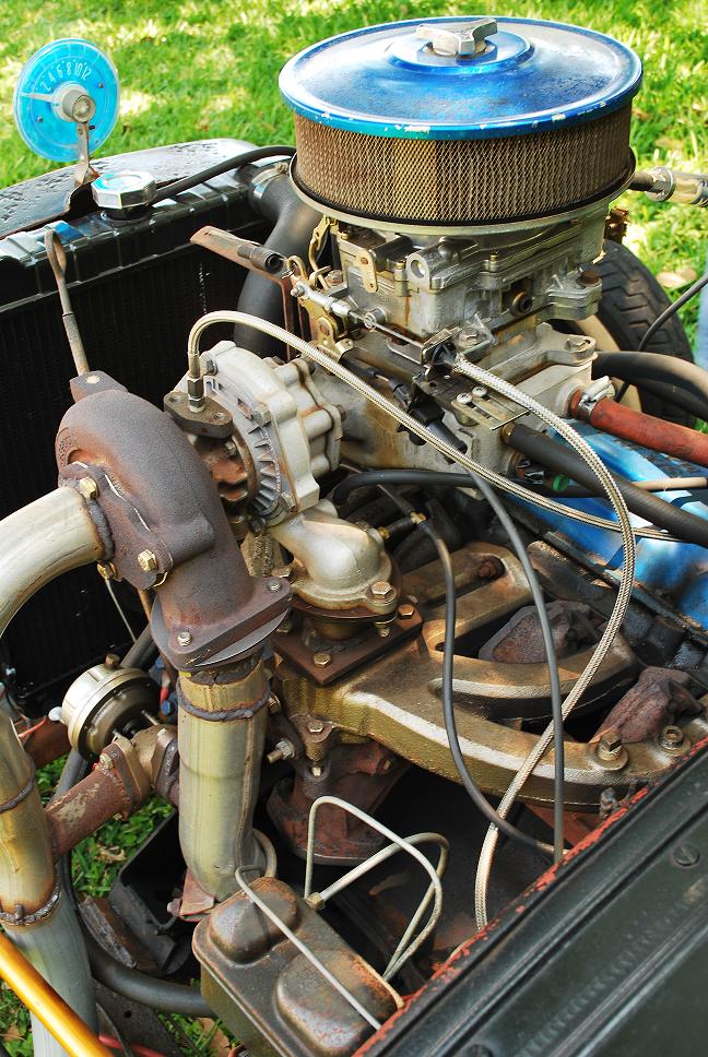

    Here is a Picture posted by 6cf Pony in that same thread.
    I think that you might have a hard time finding a late 70s Buick V6 turbo in sweeden but you might be able to get one shipped to you from here.
    It looks like it might be a natural for this engine.

    I never used the stock manifold or head either,the spacer should work fine foor you,or,just build an intake like I did.

    I think the stock Mercruiser manifolds look good and I would think Mercury Marine engineers would have the flow down pretty good judging from what they get out of their Mercury Outboards.
    I have cut the water jacket off of the bottom of a couple of the 2 barrel manifolds and they look better.

    Down the line I might turbo the open wheeled roadster pickup that is setup with a 8N front end.
    Here is a picture of one back in NY built by Elis that gave me the Idea. Imitation is the finest form of flattery.
    My RPU won't have a blower sticking out of the hood and should be way cool.
    I added some pictures of the 2 barrel manifold with the water jacket removed from the bottom and the Rochester 500cfm carb that is standard on the Mercruiser 170hp engine.
  19. I used a 1 1/8" hole saw and 1" pipe tap on 4 manifolds today. It worked out really well.
    I was concerned that the hole would not be large enough, but a 1" pipe ****** is the largest one that is an easy one to use on these manifolds. I did one hole at a time and it worked well in my little mill. I sawed the hole from the engine side of the manifold and then cut threads from the other side of it.
    I was surprised at how thick the manifold flange was. There is lots of aluminum there for good coupling to the pipe. It looks considerably thicker than my 3/8" steel manifold flanges.
    note that the manifold is not symetrical so it is only going to fit one way with the gasket.
  20. ****, your cut down manifold looks quite nice. I was also surprised that how nice your "tractor" based car looks I tried an Allis-chamlers nose on my car and it looked like an airplane tug so I didn't use it.

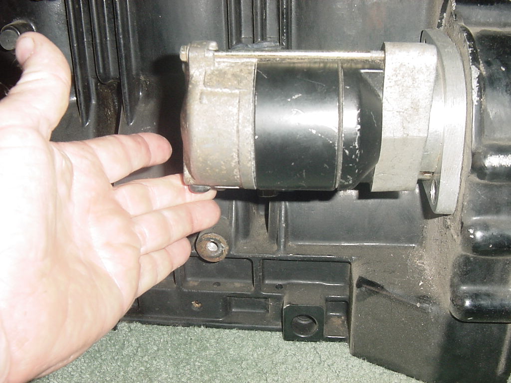

    Thanks for the compliment on the picture that I sent of Eli's RPU. I have just got the bare ch***is set up now so it will be a while before I get any pictures of mine.

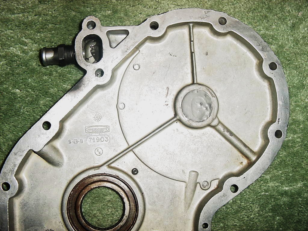

    I have cut off the front of the camshaft just in front of the cam gear and have removed the water seals from the cam cover and epoxied the hole closed thus solving the seal problem.
    I also cut a small section of the water pump impeller cover and epoxied it to cover the front water inlet to the block. I then drilled and tapped a 1/2" pipe thread hole into the side of the cam cover to allow water to inter the block from the side. This shortens the engine and allows more room for the electric radiator fan.

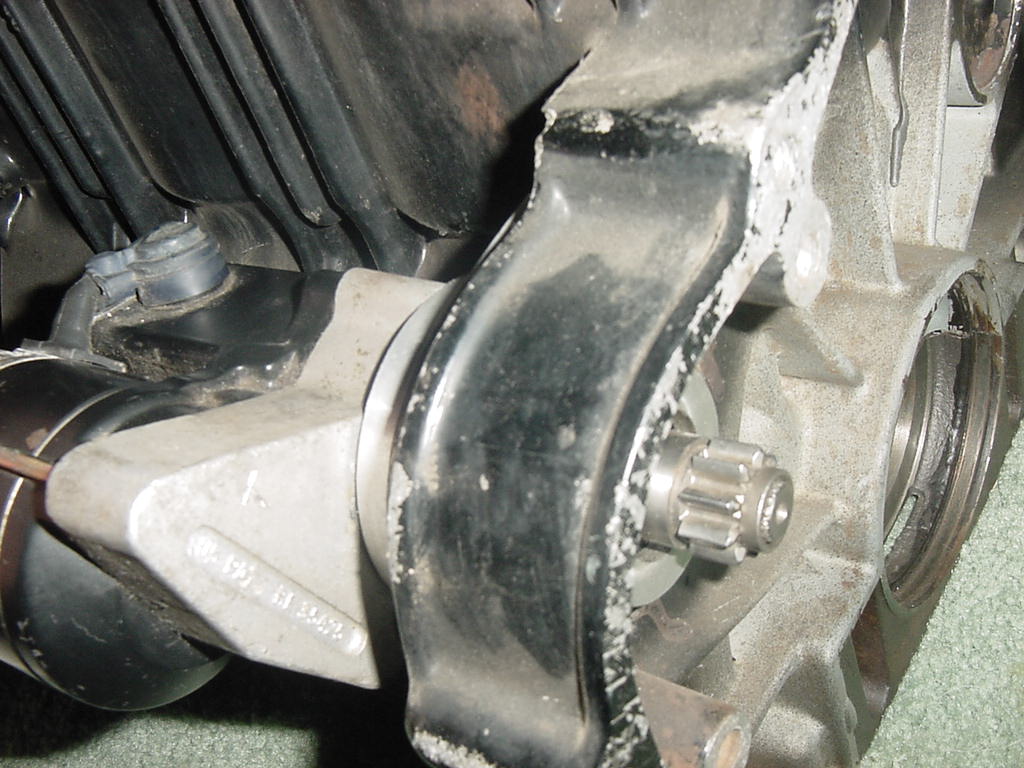

    I also machined off the alternator stator mountings around the crank shaft to allow a shorter zero ballance harmonic balancer to fit. This also shortens the engine: See pictures
    I use ebay IH Scout IMI High Torque Starters as they are smaller, lighter, more powerful, draw less current and can be rotated for clearance. This starter also dos'nt require cutting or messing with the bellhousing. : See pictures

    **** /I also have had my eyes on that type on engine, but I wanted a inline 4 cyl. because of the the car inspektion here in Sweden. Anyway I already bought a mercruiser 3,7 and started my engine building projekt. I custom making a intake manifold plenum with centerd placed injektors, and also a exhaust manifold for the turbo. I try to send some pictures.
    / Johan

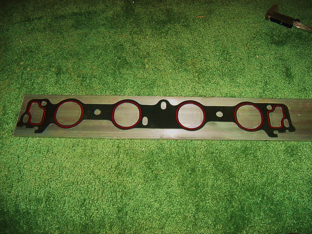

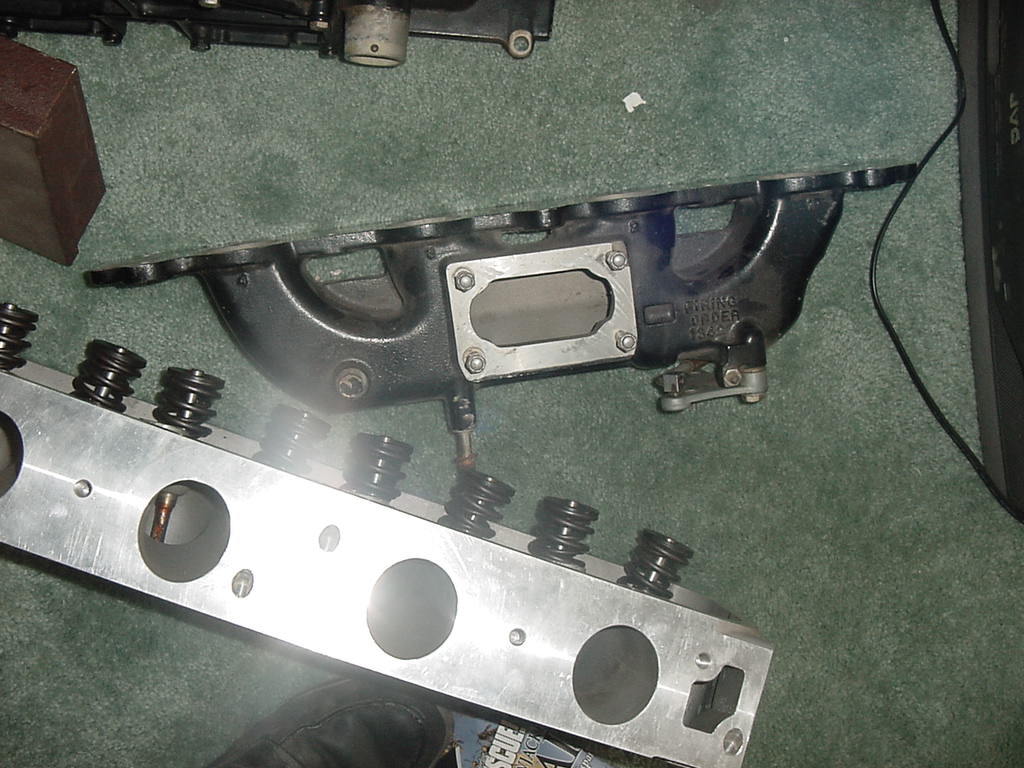

    I have a piece of .25" aluminum that I want to use for a spacer to fully cover the water jacket hole in the Intake side of the aluminum. The Mercruser manifolds don't quite cover the larger holes on the aluminum heads. This way I can drill and tap the plate with 1/2" pipe threads to install 1/2' water ******s for the front and rear of the head. These will provide the return to the radiator.
    I am sure that there will be those that think that 1/2' water lines won't be big enough to cool this engine but if they look at the 3 small slots in a thermostat that restrict the flow of a 1 1/2" hose on most cars they will probibly see that the .60" hole will flow plenty of water when fed with a larger hose necked down at the ******. There will be 2 return lines out of the head front and rear that will also feed into a larger return line to the radiator.
    This aluminum engine with its open deck and aluminum head should shed heat very well.
    My question is what is the easiest way to make multiple manifold plates out of the aluminum stock that I have. Can I get them laser or computer cut and if so where and how much. Remember that I live in So. Cal. I will probably have 6 or more cut if the price is right.
    I know that I can cut and drill them myself but that is a lot of work for me with my shop not fully set up yet. The gasket will serve as the pattern for the cad cam.
    Thanks for any suggestions.

    Your manifolds looks great. The first picture looks like a bunch of worms fighting it out but I can see that you thought it out perfectly and I know that it will work great for you. Nice work.
    It also appears that your head has the smaller water jacket holes like the cast Iron Ford heads. Your heads would not require the extra plate that I will need for Mercruiser intake manifold.

    I am using small block ford zero balance flyweels, clutch and presssure plate and I am using WC T-5 V6 Mustang transmissions. They have good ratios and they have long input shafts that don't require shortining the Mercruiser bellhousing.
    The small starter will work fine on any flywheel with the original number or teeth. I think they are 157 tooth. I don't remember and I am too lazy to count them right now.
    Anyway the starter will not hit the bellhousing because it does not have the end bearing support sticking out the end like the Delco starter. You can see that on one of the pictures that I posted earlier.
