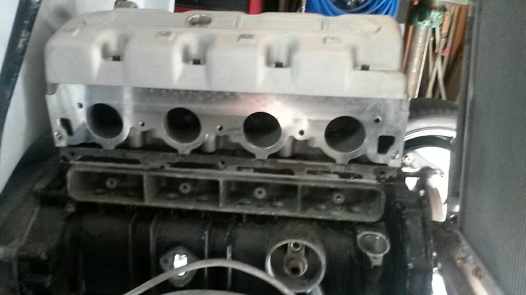

    A front shot I took of Doug's engine. This is a mock up engine. Most of what you see is a one of a kind piece. dougeng20.jpg

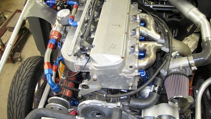

    Hey guys. So I just came across this thread while doing some research. Well I would like to share that I have one of the 3.7 engines with a BOSS 9 head by Jon Kaase. The engine has a 4.000 inch stroke with a 4.440 inch bore. We had the crank off set ground to use big block chevy 6.800 rods. We are planning on using two 52mm IDA EFI fuel injection bodies from CB Performance. We are expecting to get about 400 horsepower naturally aspirated. I am happy to share photos and answer any questions if you guys are interested.
