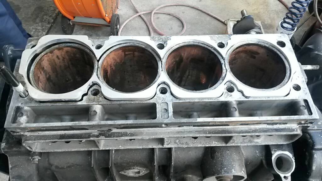

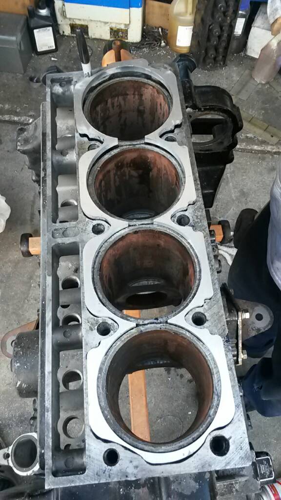

    If you plan on going the turbo route I would suggest turning the block into a closed deck. We had a 1/4" thick piece of aluminum cut to fit into the water jacket around the cylinders. We are going to weld the plate in then decl the top of the block to smooth it. The cylinders in these motors aren't really supported at the top. Then later on you just cut the water holes in the plate and you have a closed deck block with extra strength on the top. It is really just an extra safety ***urance but it's creative to. Here is some pics of mine

    Boss9 Brian : Great idea to reinforce the top of the block!! This would allow the use of Dalton(or similar) sleeves for more displacement! beck : To expand your choices I suggest looking at available piston dia/compression height /pin dia combos to ***ist in determining available/useable rod lengths & crank throw diameters(how much off-set can be ground into the crank?) from other brands. For example ;Rat motor flattop pistons(4.5"/pick your compression height for the rod length/ block deck height)/ Rods to match the pistons & off-set ground crank to match(you'd use Chevrolet wrist pins 'cause the parts don't care) Applying both Boss9 Brian & beck's concepts I could see a useable 270"motor without too many exotic parts. Outside the box can be fun!! LOL!!

    There us a guy that built a 274" motor and uses it in his dragster. It has a 4.600 bore with a trickflow A460 head. It's bad ***. Currently welding the deck plate right now though. I will post a pic after the welding process

    Now to go WAY outside the box : IF we can 'close-deck' the block, what's stopping us from adding a , say 1", spacer plate to the block before boring for oversize sleeves so that we can have a 'long-rod/ long-stroke' combination? As long as we're welding aluminum & redrilling the water holes why not? We'd need appropriately longer pushrods & head studs of course. Maybe add one of John Kaase's heads just 'because' (with some HUGE injectors almost mandatory!) All kinds of possibilities, aren't there? Sounds like it could even almost be reliable enough for a street motor?

    YES. This sounds like a great idea. As of now we are thinking about doing a different closed deck block with a bigger bore. But I don't know. I feel like the A460 still as better performance from what I have seen. The boss nine head may not be the best decision. We chose it because it is different and looks awesome.

    I keep refering to the post #1203 motor photo. That block has had the top machined off of it. I am unsure of the process but, an aluminum plate was bolted to the top of the remaining block, making it closed deck. The deck height is slightly raised. It has had slightly larger sleeves added. I have not personally seen or touched that motor, but I plan to. I have been in contact with the builder. I have seen some of his other work, which is super.
    Boss9 Brian,
    Any welding on these blocks can cause signifigant warpage. You will likely have to have quite a bit of machining done after that welding. Welding on the filter mount will cause distortion in nearby lifter bores. I hope this is all being done before new sleeve fitment. Cutting out the factory sleeves and installing new ones will also lead to align boring. It may be necessary to remove so much that the cam chain is too short, even with a .010 under chain.

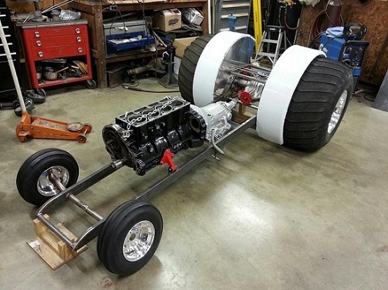

    My useage is a mini rod pulling tractor. Still under construction

    early in the thread there is a guy with an A441 (race hemi) head with a full deck plate (the liners poke up through a plate that goes all the way out over the lifter area etc. An inch of the outer block has been milled out and replaced with a plate.
    About 2/3 of the way through the thread there is a race car - comp eliminator done the same way.

    My deck plate requires no machining on the block besides putting a groove in to weld in and cleaning the welds. And I am by no means building a race car. It is simply a race inspired hot rod. We went with the boss 9 because we have a friend that works for kaase and got us a good price on some blems they were gonna just get rid of.
