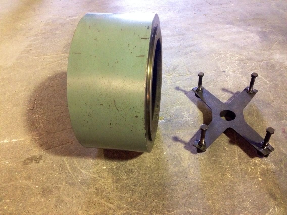

    Here are some pictures of a Bridgeport riser. I think this one is 7".
    Bridgeport says that the max between the table and the spindle gauge line is 18 1/4". So, a 6" or 7" riser Might be able to accommodate a 24" block.
    I have a line on an 8" for $200.
    I could be the Mercruiser shortening king!:D
    My wife said I can spend the money on an 8". Boy, will she be surprised when I show her that hunk of cast iron!
