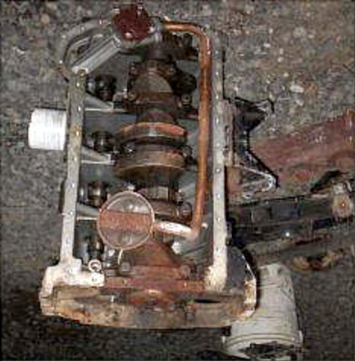

    My motor core came with the iron oil pump which has a pick up tube that runs central in the pan right below the crankline (may tag a main cap for support, IIRC?) and enters the pump from the rear, lengthwise to the engine.
    I have only been able to find one other pic of a similar set up.
    Everyone else has an aluminum body oil pump with a pickup that runs along the driver side (*cough* Port, lol) pan rail, and crosses what looks like under the front main...and enters the oil pump "across" the motor.
    Also, I have seen one pic of a full depth box pan (that didn't look home made).
    So, I have in the mail, (thanks to that big auction site) one supposedly reusable "typical" pump& pick up, because I need to notch clearance into the pan right where the set up I have sits.
    Now, sitting in the garage looking at the setup, drink in hand formulating a plan (it's hard to formulate stone cold sober), I figured maybe the center pick up and box pan were for small boats that the angle to the water changes more than the regular boats that'd take an inboard.
    Then I realized, hey! the pick up ended up in the same spot either way!
    And not for the first time, figured engineers just changed things to keep themselves employed.
    Anyone got a familiarity with the Merc pans and pumps, & can clear anything up?

    Idar : What year is your block with the iron oil-pump/central pick-up?( Possibly early?) Mellings has a new aluminum pump listed(I forget the number) with the tube inlet like your 'other' picture. I think most of us have that set-up as it's the only one I've run across after pulling down 3 different motors. so should be available from a boat-motor salvage at a reasonable price. Or fab it yourself if they're outrageous(you could even do your own dry-sump if you wanted to.)

    No idea the age of the motor. ser # 6102563
    As said: "So, I have in the mail, (thanks to that big auction site) one supposedly reusable "typical" pump& pick up, because I need to notch clearance into the pan right where the set up I have sits."

    If you call Mercruiser Inc. they can tell you when that [HASHTAG]#motor[/HASHTAG] was built . Getting info & 'specs' out of Mercruiser takes "Effort"!! I had to make 4 phone calls just to get basic torque values(head/main/rod specs). The independent suppliers are easier to deal with! The tube that goes down the edge of the block typically bolts to the block 'wall' in 2 places for support, so your pan may not need to be 'notched' for clearance. Just trying to help out, as I also had an 'interesting' learning curve(& I'm still on it!! LOL!!)

    My block already has the little (1/4 inch?) studs on the pan rail for the tube, so it having this other pump would likely have come from the history of this engine being made out of 3 or 4 blown up ones. It even has a main cap from another block that has been fitted- that is often a big job (unless you luck out), and has been done right.
    This was where the engine was sourced from- super isolated, served partially by barge for larger freight, though I did drive: http://www.google.ca/search?q=bella+Coola+BC

    Could the iron oil pump be from a 385 series Ford(370/429/460) that someone used when they weren't able to locate the proper Mercruiser pump? The alignment of the pickup tube & pump does suggest V-8 ; I'm just asking, as I don't know. As to the Roller Cam controversy : if a dry sump is used with an external oil pump, a distributor could be run off the end of the cam, so no need to cut 'camshaft-gear-teeth' in the new cam, as they're only there to drive the distributor/oil pump anyway.

    as far as the Cam gear- no it is not in common with anything else. The chain is, but that doesn't help.
    And no, oil pumps are nothing like Ford 429/460 pumps, they are one of the areas Mercruiser did their own thing.

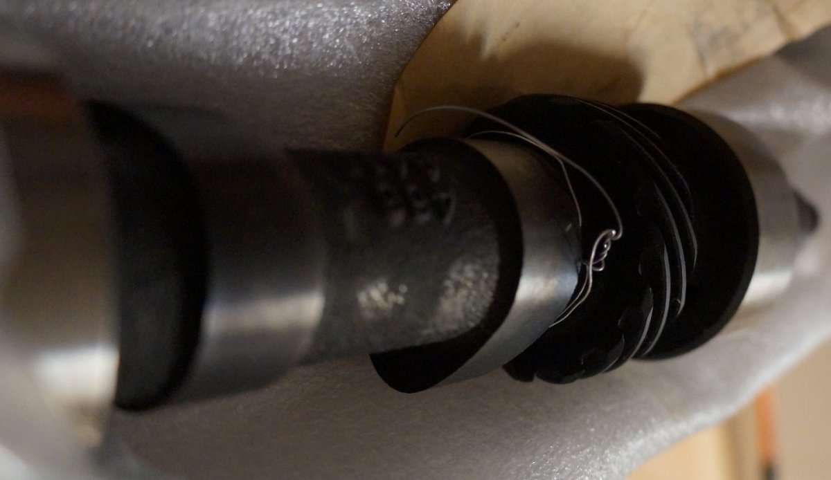

    I am attaching pics of my Lunati regrind. Incidently- is this the early or late nose?
    It doesn't look that radical, does it? Big base circle, lobe with big nose radius, it hides in plain sight! I know there are case hardening and other hidden problems but *if* you went right down to the core diameter on the heel, I think you'd be having the lobe material for at least the 242@.050. For that matter, I have a Volvo b18 cam that Isky undercut the core on. A little safer on something that is planned to have 200lb open pressures, maybe not so good an idea on this.
    So, looking at it this lobe I have photoed (vh44, exh) gives -with the Boss 1.75 ratio, about .576" lift. If you want a racier duration you are going to look at the two larger lobes. I'll write them as a conventional split duration, though if you turbo, you may run a single pattern or even reverse split.
    dur 287 - 242 @ .050 .161 @ .200 lift with 1.73 = .614, lift with 1.8 .639"
    dur 297 - 252 @.050 .171 @ .200 lift with 1.73 = .637, lift with 1.8 .662"
    There is a some chance the 252 won't fit on a factory lobe (is it worth chasing a 488 cam core?).
    For rockers, 1.8 rockers are as easy to find as 1.73.
    http://www.summitracing.com/int/search/part-type/rocker-arms/make/ford/rocker-arm-ratio/1-8
    My contention is that the best hydraulic lobes- bearing in mind you lose any safety margin by going to a .904 design lobe on an .874 lifter, with a 1.8 rocker, have valve open times better than "average" hydraulic rollers.
    Here are Comp's Xtreme energy. I'm prejudicing this by picking a m*** market hydraulic roller, not a race oriented solid, but to be fair I used the Ford Lobe ie base circle...though maybe we'd be coming down to SBC base circle at this point, actually, IDK.
    Point being, this is what every machine shop sticks in their -crate-motor-compe***or-packages, and most of us think of as a roller.
    Basically zero advantage except some nose radius, presumably.
    ******** race solids pull up some advantage, yeah. But remember to deduct lash...
    Going back to the Lunati's, you'd probably be wise to pay the man to have Nitriding done after one of these regrinds. That at most adds a couple hundred... sometimes less than $100 with another purchase or if you don't need it done "this week". I don't think I did pop for it on mine, but may have? But, I did buy some of the carbide face lifters (Schuebeck) that kept coming and going out of production mid 90's to 2008-ish.
    I am using Comp 26095 springs set up "tall" for reduced seat pressure. They are for some kind of Nascar sub series- not quite Cup, I don't think? Beehive with small ***anium retainers. They are overkill for me, but I bet -probably with a shim, they'd work for you, if you go this way. Actually not sure if hte Boss head changes that? EDIT- had wrong spring number up here for a couple hours.

    iadr - From my understanding that is a late style camshaft nose.

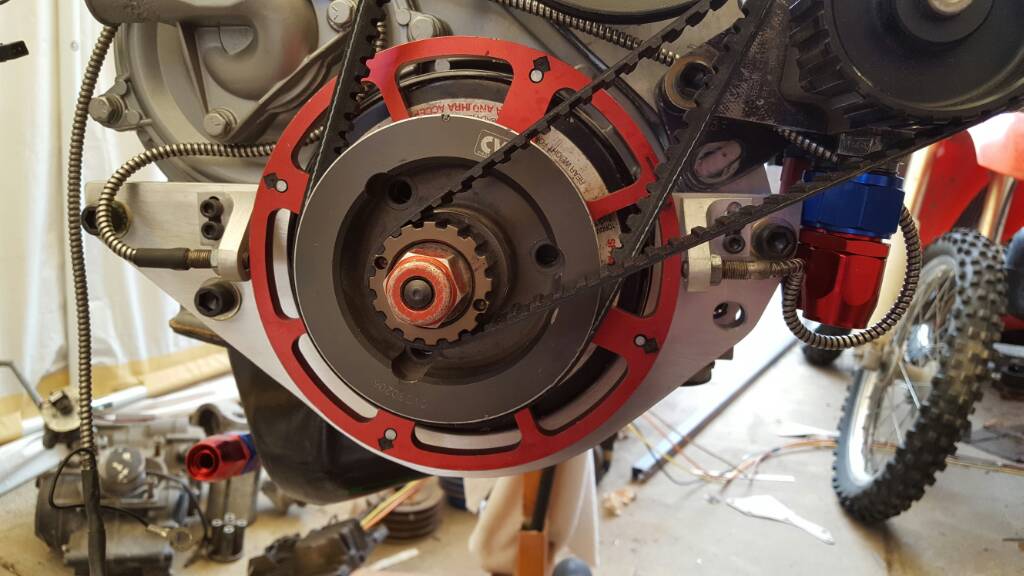

    Hey guys. I've been super inactive lately due to my schedule but I have made A LOT of progress on my 470 with the boss 9 head. Here are some pics. [​IMG] [​IMG] [​IMG]
    We made the decision to go with the crank fire ignition. Also, we are running two holley 500 carbs with a custom intake. We really took no short cuts with this engine.
    Sent from my SM-G920V using H.A.M.B. mobile app

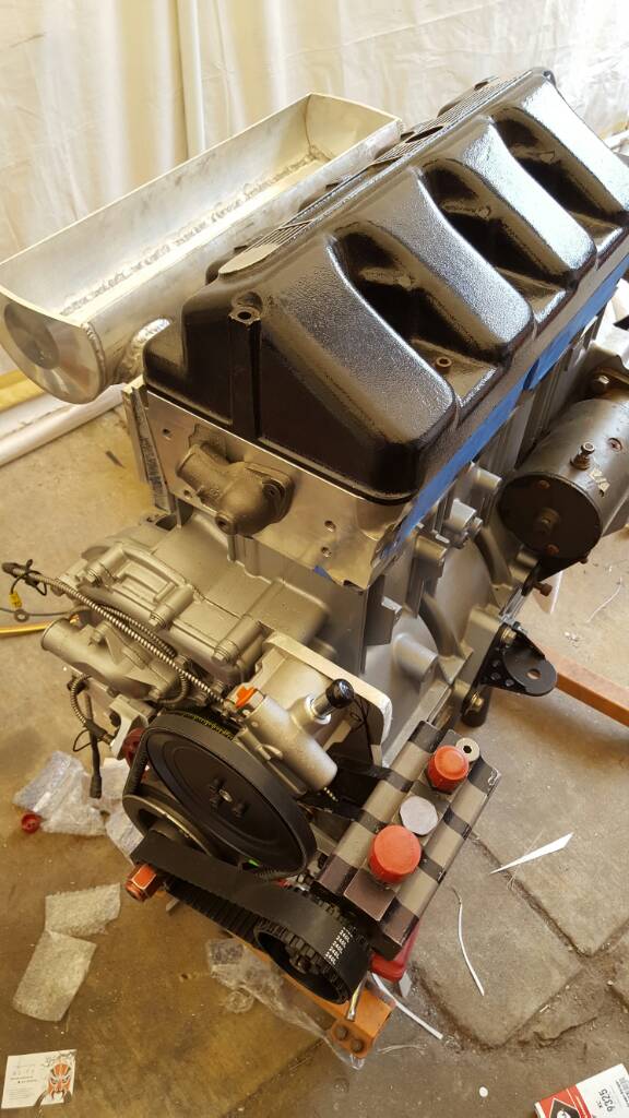

    Here is some more manifold pics of the finished product for the ports. Still have to make the top playes tomorrow. Also had to make a plate for the head to make it 90 degrees since the boss head is tapered. [​IMG][​IMG][​IMG][​IMG]

    How about a shot of the whole engine with the manifold and head in place? I'm really liking what you're doing here.

    I will post some pictures in a lil bit. Currently working on the manifold some more. Might even have a mocked up exhaust header by the end of the weekend to share.

    Here is the pictures I promised. I'll post the exhaust flange as well.
  26. Boss9 Brian
    Joined: Jul 29, 2015
    Posts: 73
    Boss9 Brian
    [​IMG][​IMG]
    2.25" primaries should make the little bullet sound healthy.
  27. My cam grinder said his equipment depends on the centering hole so regrind before cutting off the cam nose...I now need a second regrind and a centering hole.
  28. stealthcruiser
    Joined: Dec 24, 2002
    Posts: 3,750
    stealthcruiser
    You can't chuck it up in a lathe, and drill and tap a new hole?

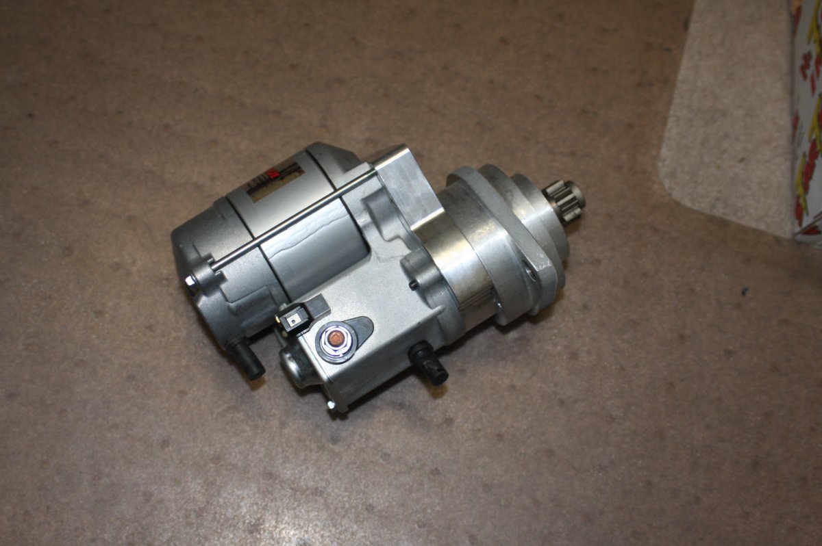

    Boss9 Brian : What starter are you using in the photos? Mine came with an International starter that has the solenoid rotated to be outboard of the bell housing &, for clearance reasons I had to go 'after-market'. (the Model 'A' brake lever wouldn't 'clear' the solenoid, & the starter couldn't be 're-clocked' for clearance.)
  30. Brian;
    I am putting a 3.7 in a Watson Indy car. I bought a starter off of Ebay from a shop in California. Number on the box is IMI 302-012. IMI High Torque starters, Whittier, CA. My delivered price was $260.00 in April of 2015.
    I needed a starter that did not extend beyond the outside of the engine block. It did what I required. Good luck on your project. Hoping this helps.
    Craig
