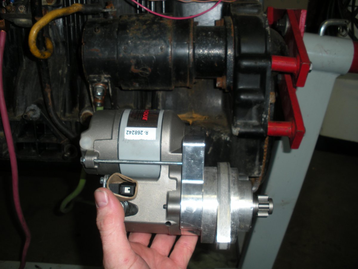

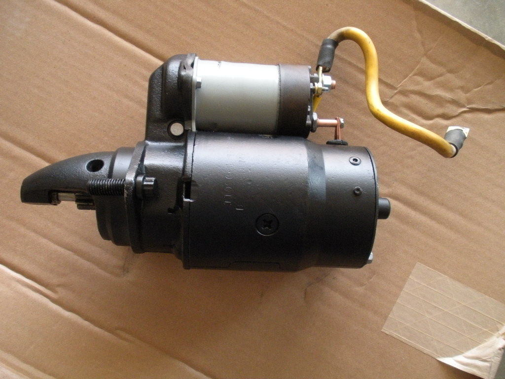

    I had not considered there could be different "stock" starters. I have 3 motors. 2 have this starter, which is like Brian's.
    The Ford style starter relay is just visible on the upper left of the photo. The gear reduction unit is the same as you have.
    One of my motors has this one. I thought it had a Ford starter relay on it, but may be mistaken. That is obviously a solenoid on top. There used to be a trick with the hot rod small block Chevy guys. You would byp*** the stock solenoid and just use the spring and plunger inside it to actuate the gear. You then used a Ford relay to energize it. That cured the hot no start caused by exhaust header heat. The starter mounting bolts are critical on this one. They need to be 12 point bolt heads or Allen heads. When I tried 6 pt bolt heads they wouldn't clear the larger part of the starter housing.
    I dis***embled and cleaned up this starter. I had it on eBay. A guy from England bought it. He backed out when he found the shipping was going to be $147. They are quite heavy.
    drtrcrV8, I know what starter came from each motor. Would my motor numbers help you match either up?
    If this is a Mercruiser only piece, it will be pricy. It would still be as economical as having one of mine shipped across the country. The bottom starter would bolt on and go, but isn't "like new". I did a no load test on it and it worked. The top ones were both on motors that were exposed to rain water so I would think a rebuild would be in order. I have not tested them.

    Early on in this thread Mercruiser's use of an International starter was discussed, & the IMI gear-reduction starter is also listed as being for International. In the above pictures from Beck the housing looks the same, just seems to have a re-positioned(?) solenoid. If I'd used a set of '32 up pedals(or 'swing' pedals for that matter) there would've been no problem with the solenoid location, & if I do another build with this type of motor, I'll keep this in mind. I'd gotten too dedicated to what I wanted to do in my current build to change to something else(& still keep the "presentation" that I wanted to keep.) Yes, I've got to learn to upload pictures & start a 'build-thread' on my project, but I'm not quite 'happy' with it yet :it'll need to be on the road before I'm ready to do***ent it here!!

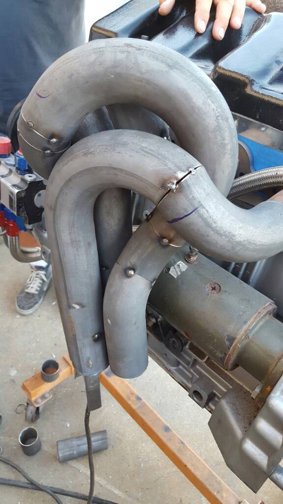

  12. Boss9 Brian
    Joined: Jul 29, 2015
    Posts: 73
    Boss9 Brian
    [​IMG][​IMG][​IMG]
    Got a little tricky with the headers. Were able to get them all pretty close to equal. Big thanks to Speedway Motors for making an affordable header kit.

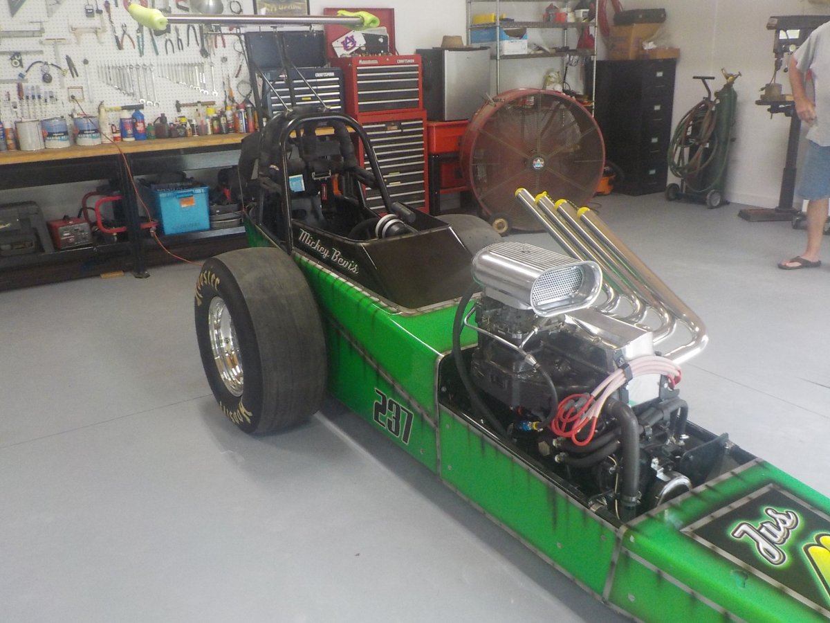

  14. mongo4u2
    Joined: Apr 1, 2007
    Posts: 215
    mongo4u2
    from sparta
    Here is one in a front engine dragster
