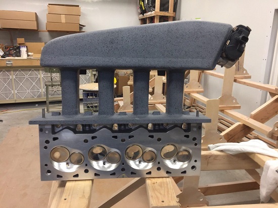

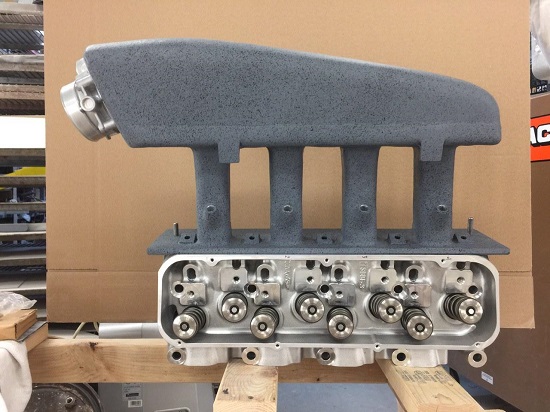

    I hate to leave all this cam/timing gear conversation, but....
    My intake manifold if finally about finished. I think it should move a LOT of air.
  22. beck
    Joined: Sep 20, 2008
    Posts: 316
    beck
