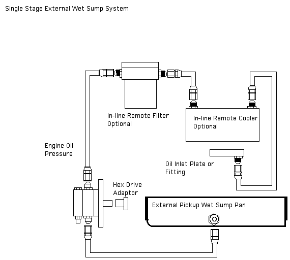

    This is the pump I will be using. A good friend of mine owns this Co and is willing to donate to the cause.
    I plan on using a 16/34 gears gilmore belt. The cool thing is off the back of the pump I will be running this power steering pump. It will really clean up the system.
  9. FlyHiFlyLo
    Joined: Dec 5, 2016
    Posts: 107
    FlyHiFlyLo
    I already run a duel oil filter and cooler... So I just got to mod the pan and suck from the sump and go right into the center of the existing oil pressure port where the filter mounts. Here's a diagram off the net.

  11. beck
    Joined: Sep 20, 2008
    Posts: 316
    beck
    Your setup doesn't use an overpressure bypass? Do you remove the original bypass and plug the hole?
    If I have to go to the external pump I would like to keep the oil filter in it's stock location to save space. I planned to plumb the oil back into the motor using a oil cooler adapter like this;
    https://www.summitracing.com/parts/...-performance&gclid=CLzEm6yIsdECFQaGaQod-NECdA
    The hole intended to feed the cooler would be plugged. The return from the cooler that feeds the filter would have the inlet hose from the pump.
    It would be super if the pump could be fed from the supply side of the adapter, but I think there is too much restriction in the motor passages. The original pump would be replaced by a spacer hooked to the supply tube. I will need to modify the pan like you are planning with hose feeding the pump.
  12. FlyHiFlyLo
    Joined: Dec 5, 2016
    Posts: 107
    FlyHiFlyLo
    I'm not sure if that will work because it might just shoot the the oil right back into the pan where the pump used to be. Maybe thread and plug the old oil pump hole. The pump has a built in regulator.
