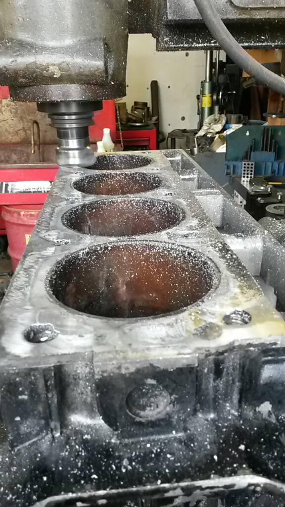

    On my block we actually went through and made it a closed deck block. We bored and sleeved it, but just to be safe we had a 3/8" aluminum plate water jet cut and we welded it in. After welding we resurfaced the block and it was good to go. Just make sure that you line a gasket up with it and transfer the holes for the water jacket. [​IMG][​IMG][​IMG][​IMG]
    Here are pics of the result. It turned out good.

    All we did was use a round end mill bit to give us a good groove to weld in.

    Also, in regards to cutting out more of the plates to support the cylinders i will need a quantity. I cant give you guys a price yet because just as everything else, it is cheaper with quantity. Also, i will need to know the thickness of the material you want. We chose to go with 3/8" and its obviously aluminum because we welded it in. Also the material thickness changes cost as well. So if anyone is interested then just message me. It would be best if you guys could agree on a plate thickness as well so it will minimize costs.

    To make the original mold for the aluminum plate we used Vaseline and modeling clay to plug up the water jacket. Then we put fiberglass resin in it with nails sticking out to pull the mold out. Then traced it on construction paper and took it to water jet.
