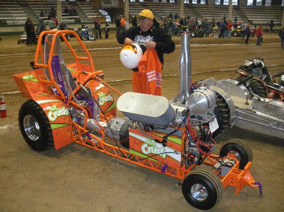

    I will get a better photo later. You almost can't tell it is a 3.7 with the side shield, fuel tank, and big air cleaner.
    This one has a Cobra Jet head, mechanical Engler methanol injection, relocated ignition, and all the best parts. It is based in central MO. The owner/driver has not been able to get near all the power to the ground. He has been detuning the motor to try to let the tires hook up. If you are near central KY (Powderly) and want to see and hear it, come to the tractor pull there (Fri and Sat). This is probably the nicest "Outlaw" garden tractor in the country. The same guy has another nearly like it with an Esslinger Ford in it.

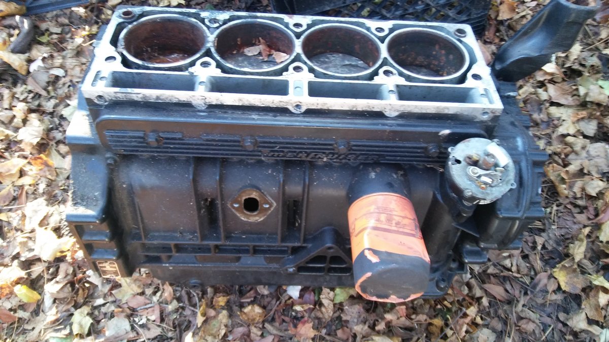

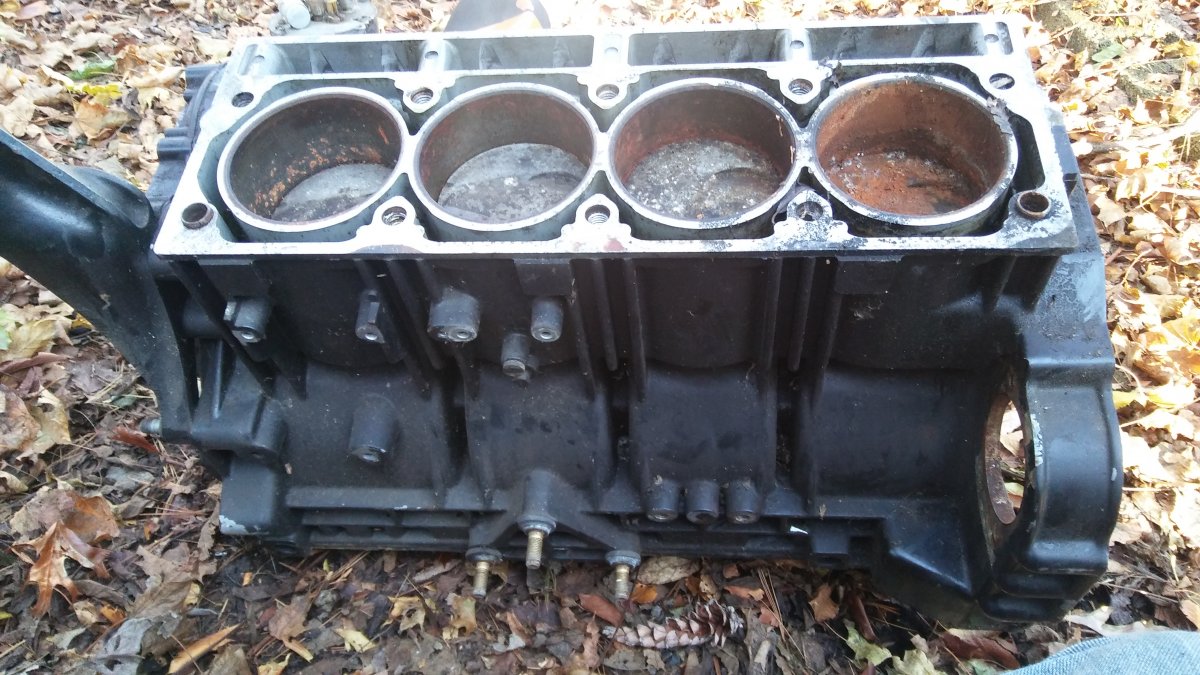

    20171112_142127.jpg 20171112_142054.jpg I've officially joined the 224/3.7 owners. Picked this up for $100. Obviously needs work.
  13. Glad to have you with us. We have a lots of information posted here so you will not lack for that.
    I've saved engines with uglier bores than yours, but you are limited on how far it can be bored as the cast in sleeves are not thick.
    If you did not get a good head with it, A big block ford head will work but is so wide that sealing on the intake manifold is difficult unless you either use a soft cork gasket or mill the head's intake gasket surface to match the block's width. Mercruiser heads have a water tube the factory adds . You do not have to do it their way. I drilled the intake manifold flange for water movement to the radiator from the head. I posted photos of this several years ago.

    Thanks Dennis. I didnt getba headvwith it but did get a 2 barrel intake, and the bores are standard size right now. I'll be checking out the whole thread. Joe
  15. good, I thought he owed you more than what was in the picture so I'm glad there is an intake manifold. It is a good heated manifold and will take either the usual carter carb or with an $11 adapter a Autolite 2100. The least overbore that works may be best.
    My latest engine had a std bore and was good except for one rusted cylinder I had some .030 over pistons so it was bored to that, but he bored one cylinder .008 too much so he offered to do the job over again and i bought a set of .040 over pistons. Before you bore the cylinders, check piston availability and price. Both vary widely.
