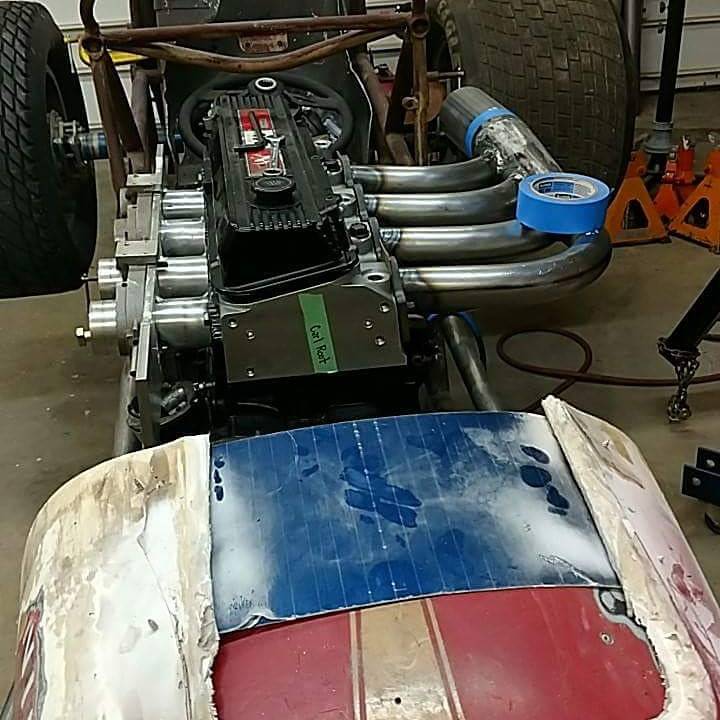

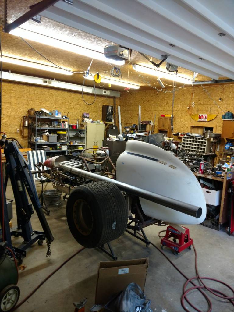

  28. Unique122s
    Joined: Jun 19, 2018
    Posts: 8
    Unique122s
    Good evening everyone. Wow, what a fascinating thread. It took me several days to read all of it. I have a lot of pasted notes. I'm looking at diving into this adventure too. I picked up a 170 with only 200 hundred hours on the meter. However, the motor is locked. but it did have good looking oil and antifreeze in the closed loop system, Unfortunately, the boat had to come with the motor. The project that I'm going for is a street cruiser in a 1965 Volvo 122. I think this should be an awesome build. I can't wait to tear into the motor and see what I have to work with. My plans are to keep it fairly stock innards except for self contained EFI, and or course address the water pump, alternator issues and add an aluminum aftermarket head. I'm thinking I'm wanting an automatic since this is going to be a street cruiser but that is not set in stone yet. Any thoughts? I has so excited when I got the engine home I had to just set it in to be able to compare the size. Again, WOW, width is not going to problem, one reason that this build appealed to me but I was not prepared for how long this big bore 4 banger is!
    Sorry not sure why my pictures posted without the above message.
