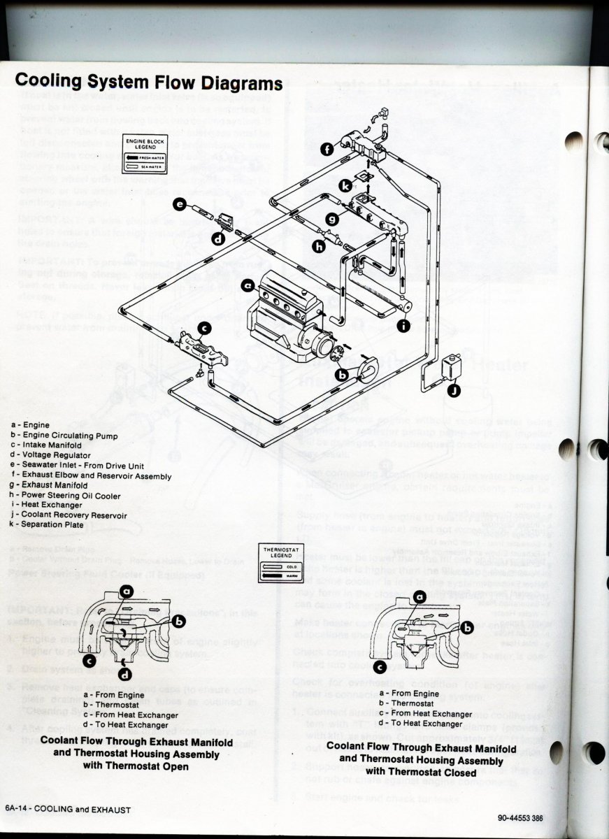

    Thanks for the diagram, It looks like if you eliminate the intake heating, exhaust cooling and the raw water lines you end up with the coolant coming in the front of the block and exiting the front of the head just above where it entered doesn't seem like the back of the motor would receive much circulation. Would it matter if the flow was reversed? It seems to me that it would be better if the coolant could enter the front and exit in the rear somehow.
  2. tjm73
    Joined: Feb 17, 2006
    Posts: 3,679
    tjm73
    Looks like the head gasket restricts the coolant flow path to go around the cylinders and enter the head from the exhaust side only. Then it flow around and out the end of the head.

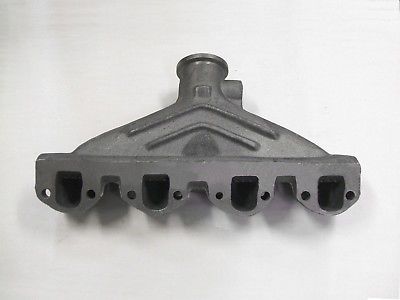

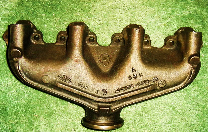

    Have a pic from earlier in this thread of someone using this manifold, can't remember who posted it. PICT3203 (Small).JPG.jpg
  25. BIGDOG69
    Joined: Jul 6, 2018
    Posts: 21
    BIGDOG69
    Here are pics of a head from Summit Racing 429/460 head and the cast manifold. Looks to me as if they will match! BBF460Bare.jpg s-l400(2).jpg

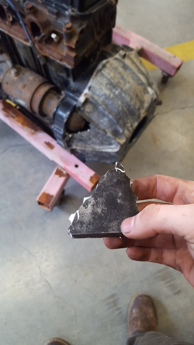

    When I am at school tomorrow I'll get a picture of my eBay header. Had to buy 2 for $100 but built well. But here is a v8 monza bellhousing. Really need a 4cyl housing since it makes use of one more bolt. But if it breaks I'm damn good at pulling motors. To take the chunk out I drilled holes and angled the drill in the hole and took out lots of material. But here is a picture of it. I know a lot, and know lots of people. So ask away. 20181126_121236.jpg 20181126_121243.jpg
