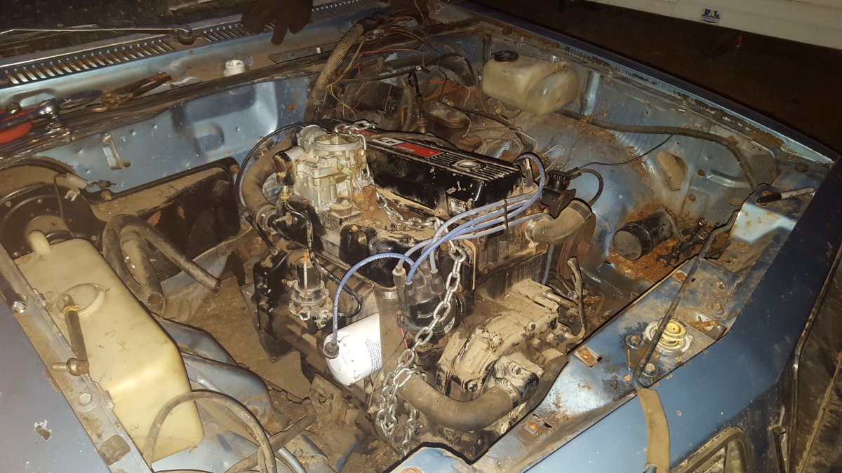

    Gm 10.4 clutch. Pic of the throwout fork is with the bearing touching the plate. I need the fork way back. 20181130_110529.jpg 20181130_112908.jpg

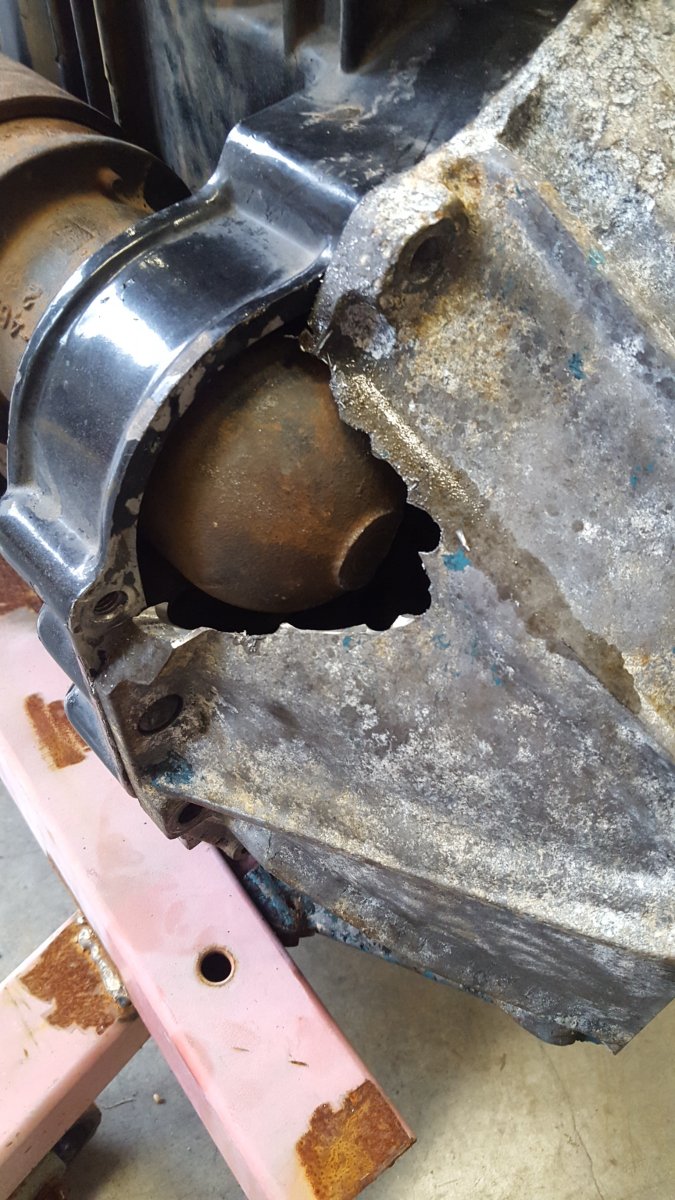

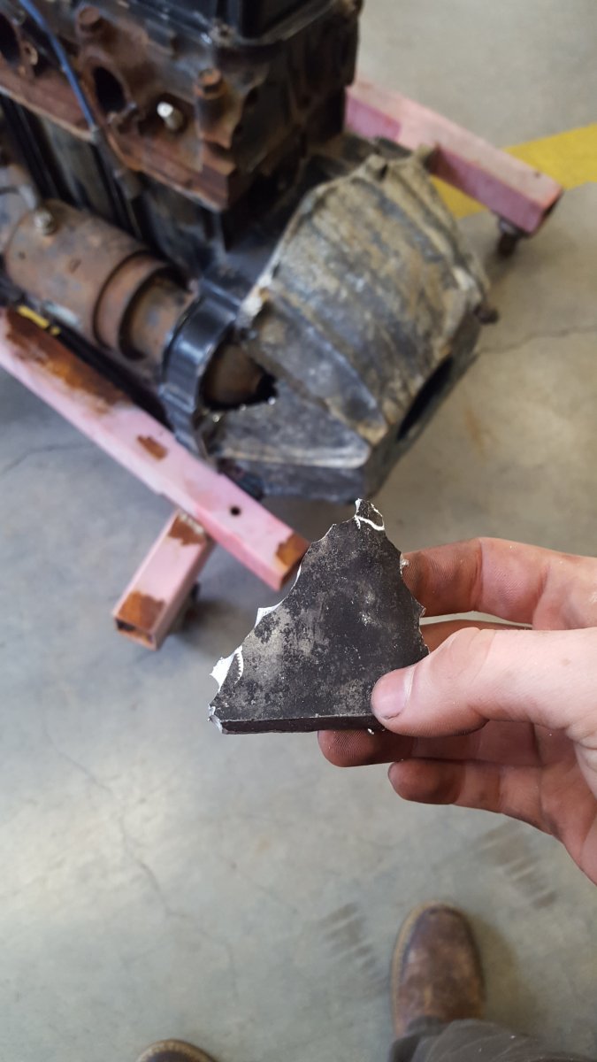

  4. Notches are stress risers and the bellhousing is stressed.
    Cracks begin at sharp edges. Aluminum is sensitive to this problem.
    Chevy aluminum bellhousings are still only $20 at swapmeets.
    There are two rear hole sizes the small hole for car transmissions and a larger one for pickup transmissions with their useless gear ratio in low.
    As one mounting hole and a dowelpin are missing from your bellhousing , buy the next inexpensive one you find. Make the holes at the end of the opening then used a hacksaw to cut in to the hole. Finish the edges with a body-file (aluminum does not plug them up) and sandpaper to get a smooth cut that will not propagate cracks.
    If you use a miniature starter you do not have to cut the bellhousing and it is half the weight of the big starter. Check the direction of rotation before buying a starter
    You will have a very nice looking car with your Vega body.

    The stress riser fact is on the mind. My dowel pins line up. If this bell breaks I'll just have to find a 4 cyl monza housing because it uses that one hole by the starter. With the tranny on it it does pull a small gap between the bell and engine. Might not last but that's not the immediate goal. It's just to make it work for a bit just to laugh at haters. And then make it better. Too bad these weigh 450 lbs without the exhaust. It can get down to 350 with the crankshaft lightened, a lighter flywheel 137 tooth sbf, and a head. If I pick up a cheap one I'll disassemble it and cut the block for my cj8. I'll 3.7 swap the white house next to make it run better.

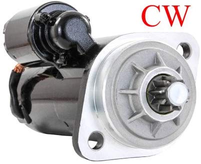

    Just found the solution to my starter issue. I found this after I bought the hard to find cast bracket for my old style starter. Google 3.7 high torque starter to find it. This means next bellhousing I use when mine breaks I don't have to cut into it. 41LjkYFwP-L._AC_SY400_.jpg

  9. It is the starter I use.
    It is not expensive.
    it is physically small ahead of the bell housing and
    it fits without chopping up the bell housing.
    it weighs about half as much as the direct drive starter.
  10. I used the big old starter in my first engine (It came to me as a basket case so I did not know of the bracket which was missing). I just bolted the starter to the engine as is done in cars and it was never a problem for my engines.

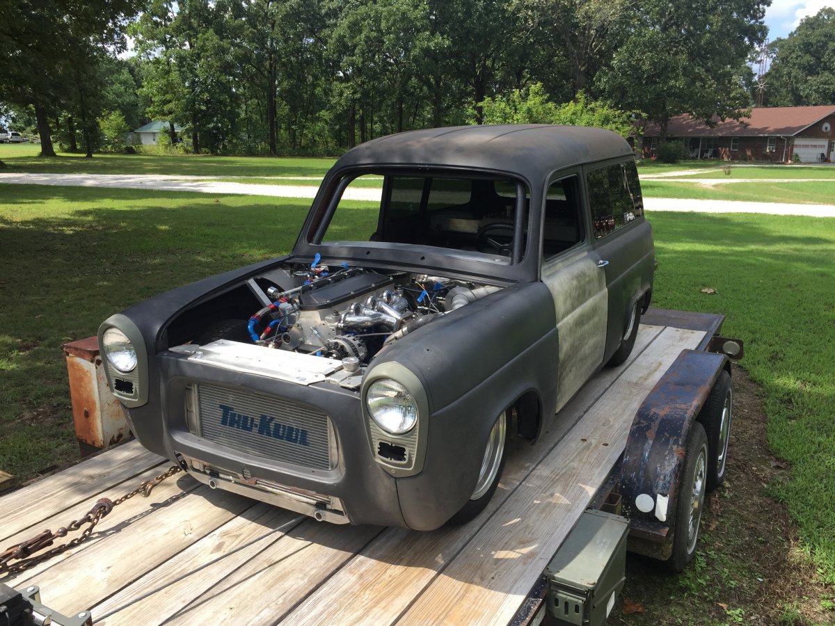

    I will try to sneak in a picture of the Anglia I am wiring. It has one of the engines that is the topic of this thread but it is way off topic. The owner added 1 inch to the height of the block. If you look closely you can see the spacer just below the head. The crankshaft is a one off billet, and so is the camshaft, along with lots of other one of kind pieces. It is turbocharged and fuel injected. It uses a racing powerglide transmission. It should make about 600 HP in the current setup and other combinations can make even more HP. It is to be street driven.

    The owner of the car is not on here. The owner/builder is a master craftsman. It is an awesome build. He has been slowly building this for several years in his spare time.
    The cam is a custom built piece. The owner used to teach machine shop. One of his students is now a talented machinist. That student cut a couple roller cam cores. The owner had 2 of these ground (he was unhappy with the 1st grind). He made the cams with a SBC snout. He and another of his old students, who now is a performance engine builder, figured out a way to combine SBC and BBF adjustable timing sets to complete the timing chain. Precision machining and shimming are required. I tried but I couldn't figure it out.
    The crank was made by a guy that typically builds smaller size cranks (motorcycle size). I spoke with the guy and he was NOT interested in building another. I tried to coax, but it didn't help.
    If you search this thread for WZ JUNK postings you will find more info on the motor. A few of my posts also have some of it's info. Page 40, post #1192, has a front photo from a few years ago.
    Update: I just spoke with WZ JUNK. There used to be more photos of that motor here, but they have been deleted as not being appropriate for the site. He is hoping to post more, but they too may not stay up long. There is a big turbo and EFI on it. That is a shame because so much of what has been done on this motor doesn't relate to those 2 items and traditional style builders could use some of those ideas. There is also some nice metal work on that car that is appropriate to this site.
