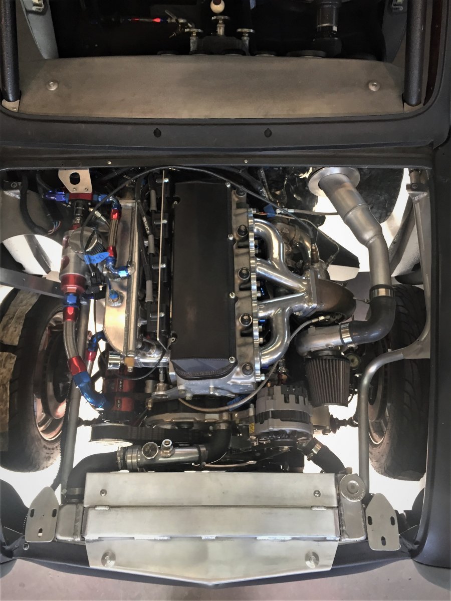

    I will see if this photo of the engine from the top will stay up long enough for you to ask any questions about the engine.
    I am nearly done with the ch***is electrical harness. We are waiting for the newest version of the engine controls computer to be manufactured. As soon as I have it I will wire the engine controls and sensors.

    What are the turbo specs? How much boost does he plan to run?

    WZ what are you using for a water pump?

    Just under the alternator is an electric water pump. There is another electric water pump for the intercooler and it is located inside the car. The water for the intercooler is cooled by Co2, that can be turned on or off as needed. The intercooler water tank is in the back portion of the car.
    I will get the specifications on the turbo from the owner.

    Cool stuff. A possible issue I see with that turbo is I don't think that header is going to pulse the twin scroll correctly if the motor has a stock 1342 firing order. The reason I say that is volvo 5 cylinders can't use a twin scroll because the scrolls can't be evenly pulsed. ***mins are the same way, the twin scroll manifold has to exit in the center to make the pulses to the twin scroll even. Just a thought. Just saying I'm better on the keyboard then I am with a wrench in my hand.

    Might not be a twin scroll turbo.
