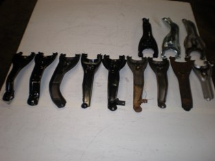

  20. A manual transmission depends on moving the pressure plate, the choice is between moving it directly with hydraulics or with a clutch fork. The hydraulic release bearing system is nice except its adjustment with shim washers will require several trial ***emblies of the transmission to the engine to check clearance. It is really easy to break the bearing retainer doing this so you may want a spare bearing retainer on hand. Don't pull it together with the transmission attach bolts or I promise the bearing retainer will break like mine did years ago.
    Push rods were the usual stock solution, but there are things which can go badly wrong with them when you make your own (as I found out).
    External clutch slave cylinders are another choice but they have most of the disadvantages of their alternatives and offer few advantages.
    If everything fits well, a good simple system is a cable pulling on the clutch fork . I use an old parking brake cable to pull the clutch fork . It works reliably and is really cheap. I extended the clutch fork on a previous engine a few inches for more leverage. Reshaping the clutch fork may result in the throwout bearing to clutch fork angular limit being exceeded.
    You must have a clutch fork that does not begin at the end of its travel in the bellhousing opening for it. Resist cutting the bellhousing as there is not much to gain by doing that. Although the choice of Chevrolet clutch forks is wide (see photo), you may have to cut and weld what you have to the shape and length you need. Heating it may cause the metal to become softer and it may not resist bending( that happened to my Goldwing centerstand).
    stores here stock one clutch fork an ATP ZA 100 or a Pioneer CF 100 which look like a mid 70's Chevy fork the 340278 (Chevy part number). In striking contrast, you can see in the above photo how many Chevy clutch forks were made.
    You can change the clutch fork to clutch disk to throwout bearing distance minus 650 thousandths using the long throwout bearing. Another minus 650 thousandths by using a V8 style pressure plate with inclined fingers instead of the 6 cylinder one with flat fingers. The converse applies: 650 th more clearance with the short v8 throwout bearing and another 650 th clearance increase with the 6 cyl style flat fingered pressure plate.
    Other than the above, if it needs adjusting, make a new fork pivot ball stud. Mine is refusing to unscrew in spite of penetrating oil and a long breaker bar.
    While you have it apart change the shaft seal in the transmission bearing retainer. The original seal is a # 125172C mine now is a new Duro #D431.
