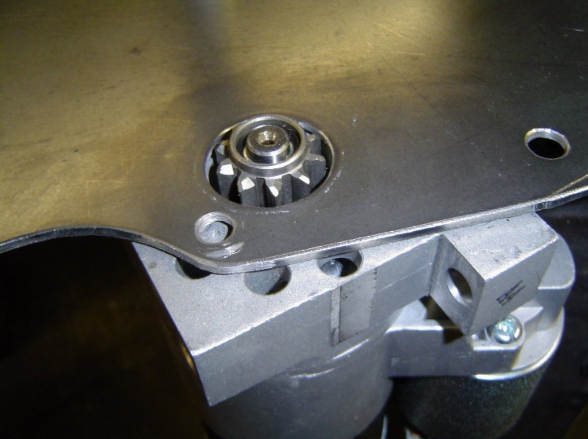

  2. Yes, no interference with any engine or transmission parts. Modification is absolutely not required as long as a starter without an extended nosepiece is used. I cut a hole for the end of the big old standard Mercruiser starter in this bell housing and later used it with a much smaller gear reduction starter.
    The smaller starter saved about 10 lbs. I posted photos of the opening I cut some time ago. You can see that their location impacts nothing except the starter nose.

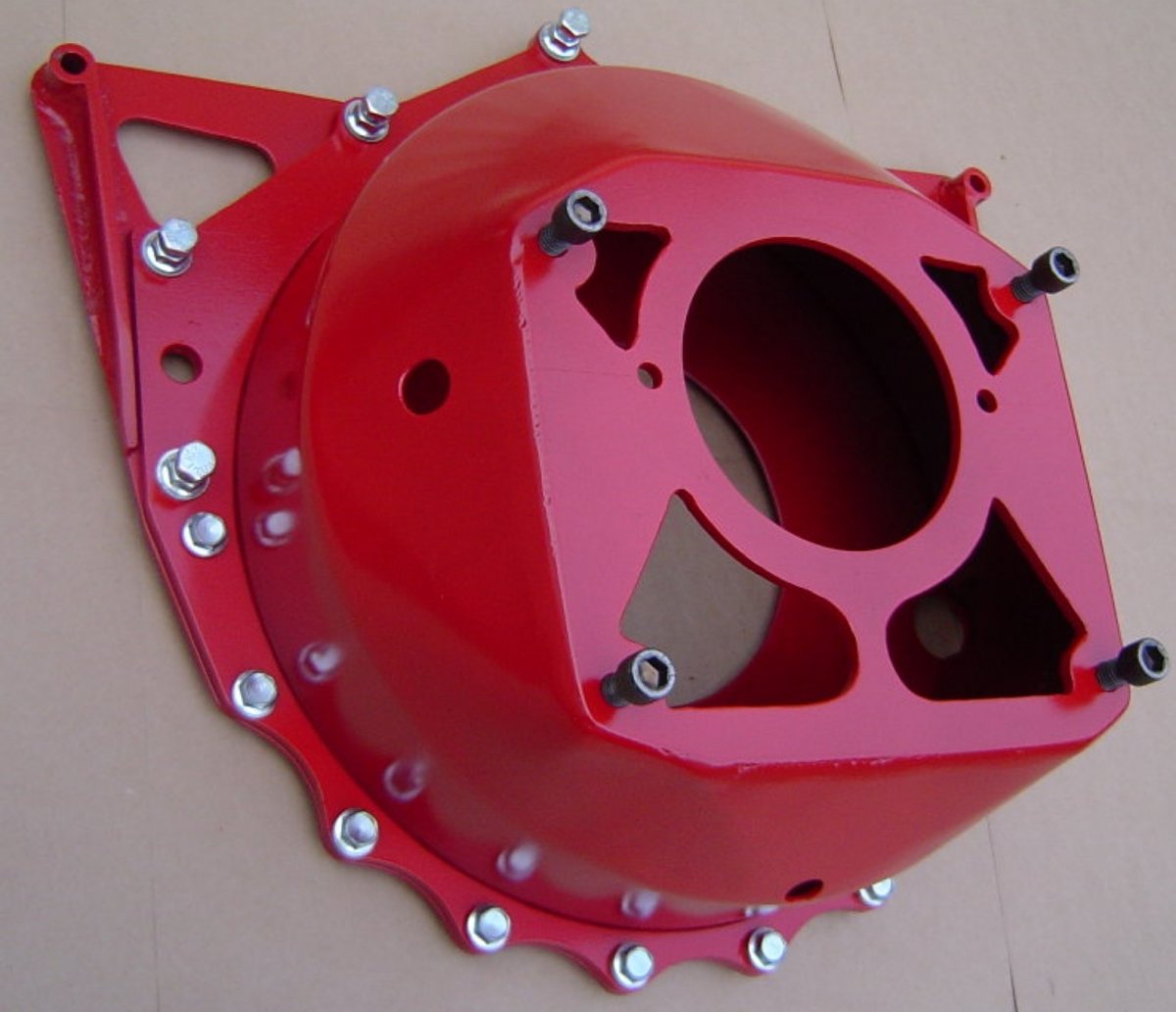

  8. ^^^ Holy sh*t !!! That bellhousing is gorgeous.
    I've often looked at this thread, for inspirations. The stuff done here, is needle moving. Love it.
    Pictures saved, in case the that guy's thread disappears ...

  9. tjm73
    Joined: Feb 17, 2006
    Posts: 3,659
    tjm73
    The guy that did that owns Gearbox Grannies. They build V8 swap stuff for RX7's.

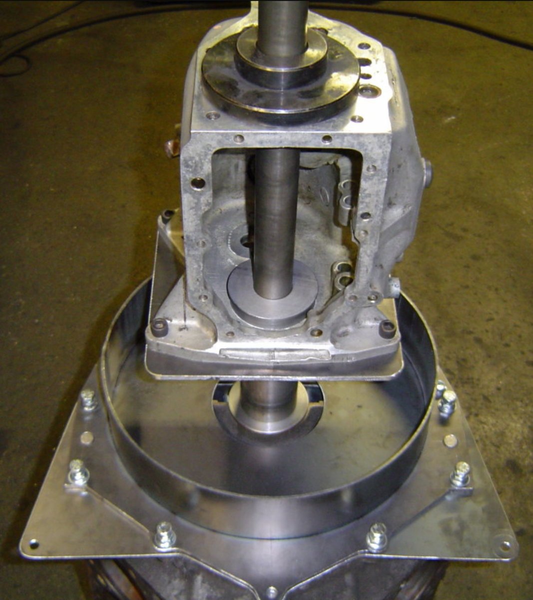

  10. This afternoon I cut the bottom out of a 153tooth Chevrolet bellhousing to be able to get a stock mercruiser flywheel into it. It was an experiment.
    In post 2040, it is the one with a dab of yellow paint on it. A big chunk was removed (2 inches by 12 inches). Flywheel teeth are still in contact with the aluminum so more remains to be cut away. The aluminum of these bellhousings is a strong alloy but it is thin, brittle, subject to cracking and must withstand the full torque of the engine without breaking. With a large hole in it, that part of it changes from a "tube" structure which has strong resistance to twisting forces to a partial tube which is much weaker . In my opinion a 153 tooth bell housing is too small for use on a 3.7 mercruiser engine but you can use them on the smaller 120 and 140 mercruiser engines
