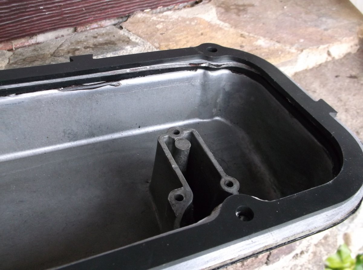

  13. Mercruiser valve covers are pretty but if the rocker arms hit them because of a higher lift cam, they can still be used if you space them up with the extra gasket that comes in the package so this will cost nothing other than a few dollars for the aluminum.
    Double rubber gaskets squirm around making assembly frustrating unless they are glued in alignment on an aluminum spacer . This combination is like having a triple gasket. As my rocker arms only made light contact, this spacing was enough for my engine. The "store bought" spacers do look excellent.
    Permatex spray adhesive works to hold them in place and has the advantage of being easy to remove. You can see a sandwich of two layers of gasket with aluminum between them. A little dark adhesive from the previous owner remains outside of the gasket contact area. valve cover gasket 003.jpg
