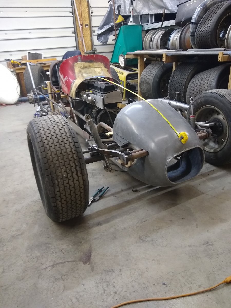

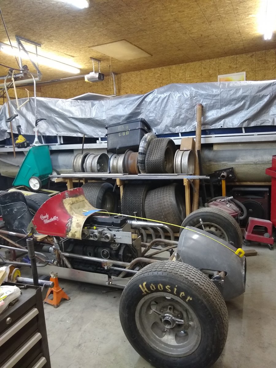

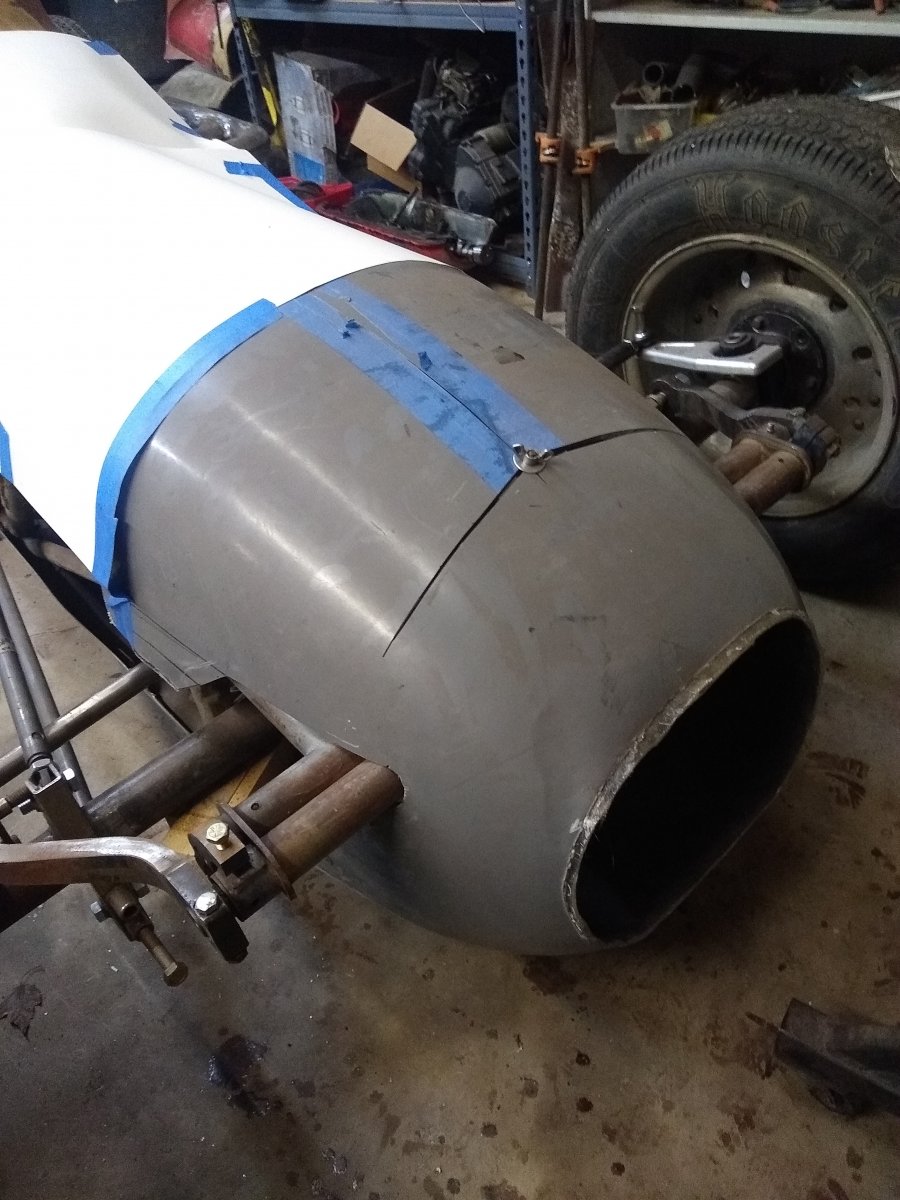

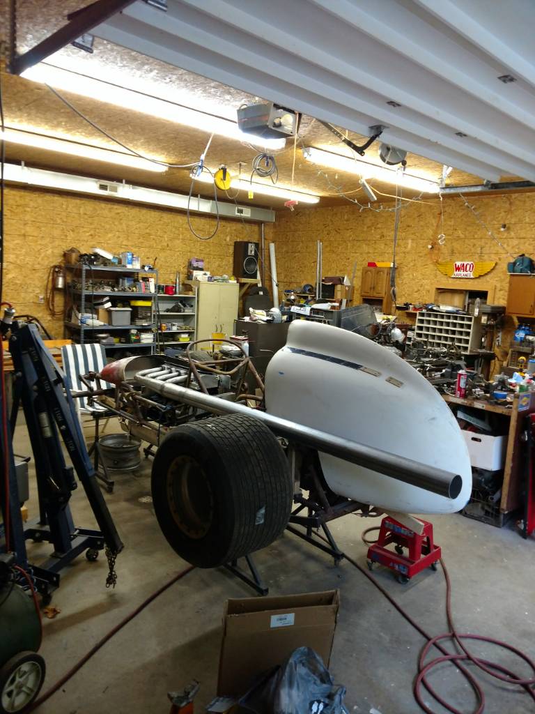

    Not much to report. I refurbished an old sprint car last spring and raced it last summer. That took me away from my champ car project. Gotta live your life!
    My thoughts lately are the champ car. Not getting any younger!
    current situation:
    I may have posted some of these earlier. IDK .
    Plans from here: finish bracketry on chassis, then weld up and send off to powdercoat. then work on engine. finish intake manifold, fuel injection, and build a home spun lost fire ignition.
    to answer probable questions- rotating****y will get balanced, won't run a harmonic balancer. fuel will be methanol.
    just little stuff lol
    chriseakin likes this.

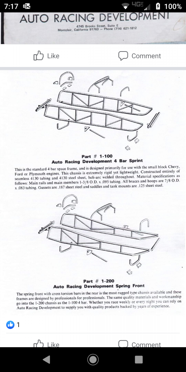

  8. The car is coming along and it's nose looks much better.
    Now some questions:
    What does or will it weigh?
    What wall thickness on the small frame tubes?
    and Could you post a photo of the front of its frame showing the complete torsion bar ?
    this pandemic is an ideal time to work on cars.
  9. Rootsgroup
    Joined: Jan 26, 2008
    Posts: 60
    Rootsgroup
    from Indiana
    1300 to 1500 lbs I would guess when complete. This is about the norm for cars of that era, no more than that.
    This drawing I found is probably same material, (thickness, rest is same). Mine is a Don Edmunds copy. Refer to upper drawing

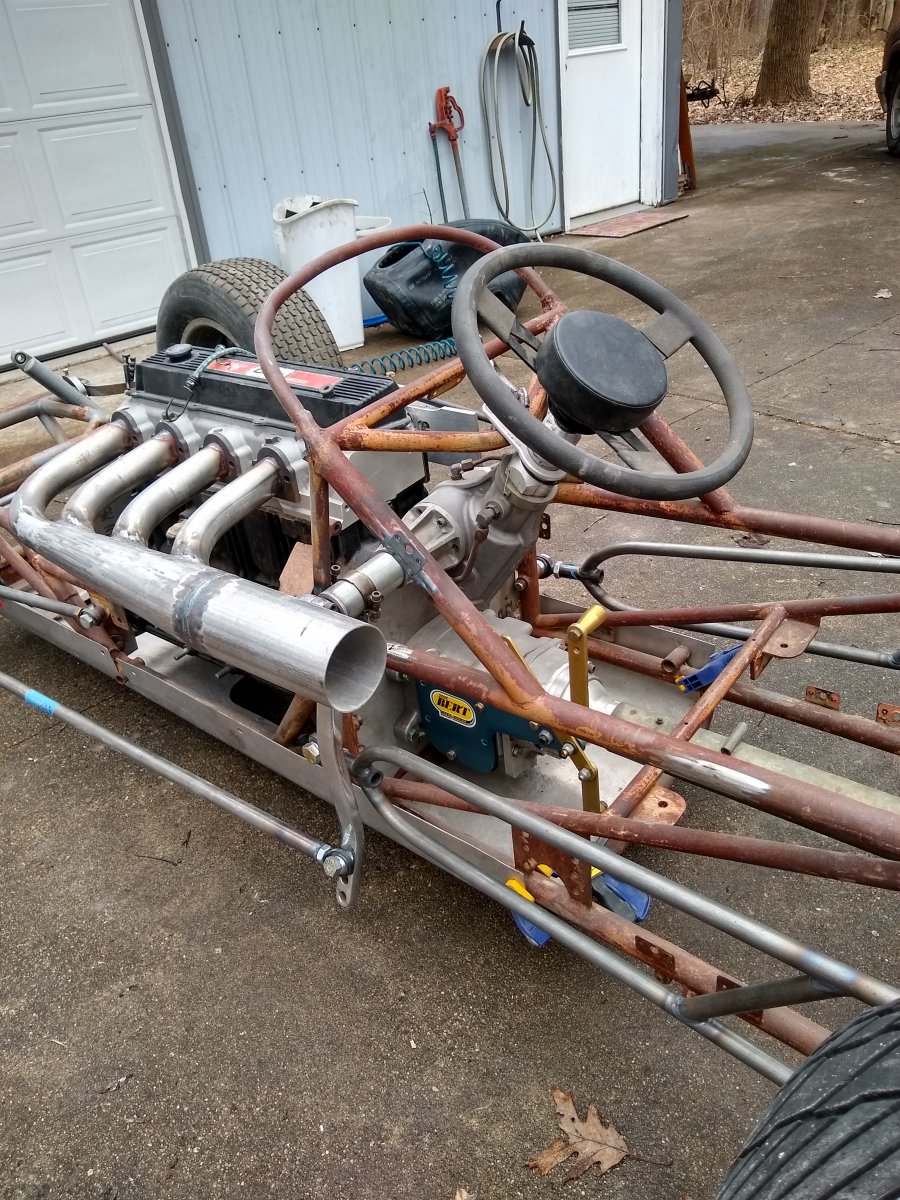

    My project update is above on this page. I have gone far enough on the engine to use as mock up, then when chassis details are complete, it will go to powdercoat. Then I will finish up the engine.

    Rootsgroup,

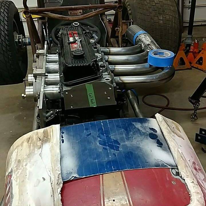

    Thanx for getting back. I really like the header. How big is the outlet? Did you roll the cone yourself?
    That engine really sits back doesn't it?
    Very cool project!
  23. Rootsgroup
    Posts: 60
    Rootsgroup
    from Indiana
    I built the header from two 2" u-bends, and a piece of 4" exhaust pipe. Lots of thought and figuring went into it. The cone part is a a piece of 4" I pie cut down to to 2" one one end.

    Dennis G asked for these - from suspension pics
