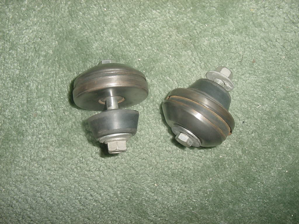

    If you go to Speedway Motors online you will find that the #7209314 motor mounts have a step in the hard rubber lower pad that keeps the mount from moving in both directions.
    That step fits into the frame adapters #1353274. These adapters are made to sit flat and they are found on many small block V8 hotrods that have much more power and weight than any thing that we are likely to get out of the 470.
    If you look at the picture you will note that the holes are slightly oblong allowing the engine to center its self.
    There is an engine mounting guide under Info that showes the setup with a V8 block.
    These motor mounts and adapters in addition to the third mount at the rear of the transmission should be perfect for the ideal 3 point system.

    The mount in my previous thread that I bought at a parts swap isn't the Speedway part but is similar in apearance and I won't know for sure if it is identicle untill I get one from Speedway, but it has metal sleeves molded into the rubber that I am sure won't allow it to self distruct.
    I noticed that the one that I have has a metal cap that goes over the top of the rubber. I imagine that it is there to protect the rubber from oil and other contaminants that were a problem with older hot rods.
    I suspect that with newer cleaner hot rods they found them unnessary.
    I don't think that the 470 will have any problems in this area as I have seen many well used engines and haven't observed much in the way of stray fuel or oil around the engine compartment.

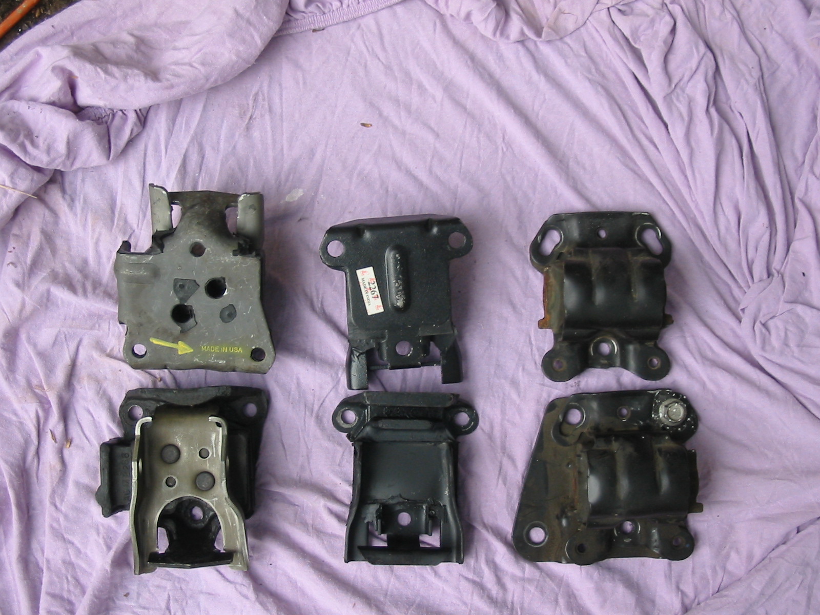

  14. three examples of captured rubber mounts:
    a 1980 Lincoln mount, (much like the chev mount)
    a 1995 econoline mount, simple, safe & $15
    and a 1972-2010 chevrolet v8 and v6 mount.
    Can't argue with 38 years of success.
  15. More noteworthy mounts of t he 60's:
    1962 nova
    1965 mustang [ which persists as a 1995 F150 mount
    1969 chevy pickup mount, used through 1972
    none are captured rubber so they could pull apart
  16. Buick was more adventurous in their mounts:
    [in order]
    1972-1990 Riveria mount [must have been a success] $18
    1972 Skylark mount
    1975 Skylark sort of a copy of the 69 vette mount. seriously ugly.
    1990 3.1L mount $28 (same as $5 1962 nova mount??)
    1990 v6 3.8L right rear mount, captured rubber and it does the angle, it might be very good. $27

  21. made in India VS made in USA,
    three sets of chevy mounts.
    The two left sets are made for the pre 1972 big block chevy in a vette. For comparison the set on the right is the captured rubber mount used since 1972 by chevrolet .
    Now for a second comparison, look at the difference in metal thickness in the two photos on the right. India [black] vs USA [NAPA][unpainted in part]. I returned the made in India mounts.
