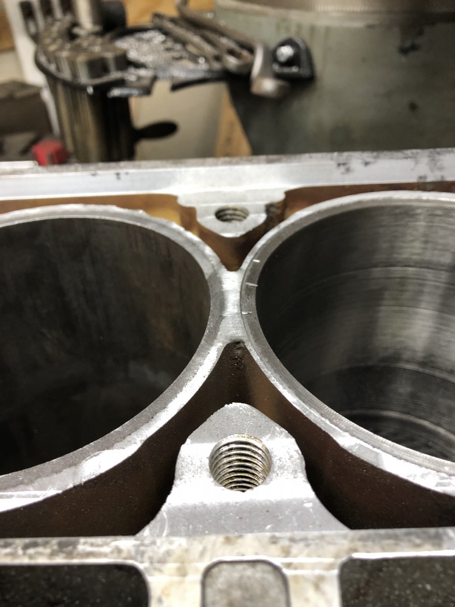

    It has been posted about abnormalities in the casting of our motors. I am seeing the same thing here. I had to do some piston modification to my motor and noticed the cylinder wall of my motor is way out of whack.
    Look at the difference in the thickness of the steel sleeve between the top and bottom. There isn’t much left at the top. This motor is bored .060” over.

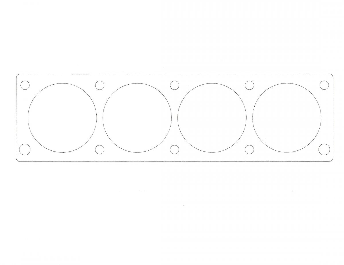

    This won't help your situation, but hopefully it will help some of the other guys, especially those that are boring the original sleeves completely out.
    I developed a CAD drawing so that we can have plates cut by Laser, Water Jet or some other means. Since the blocks are not consistent I worked from the two engines I have here and made the drawing so that the part can be modified to fit at ***embly.
    This is a very basic plate that can be used to locate a boring bar or modified to reinforce the existing barrels. Deck Plate.jpg To use it as designed, it does require machining a recess in the block. This can be done a Bridgeport with a bit of fooling around. I suppose it could be modified to fit around the bolt bosses, but it might be better to make a dedicated plate. This block has a split cylinder and barrel, so those will eventually be machined completely away.
    This is not my original idea. I combined what @beck did with what @Chris Nichols did.
    I got a quote from a Laser shop, but when I asked him to quote me a price for 3/8" material instead of 1/4", the price was 50% higher. When I asked if I could supply the material, he 'No Quoted' me. Too bad because I have enough of that to make 15 or 20 plates.
    This plate is simple enough that I can make it on my mill. I just wish my DRO was a bit more reliable. Since this is a long term project for me, I will keep trying to find someone to cut the plates at a more reasonable cost.
    I will try to make a drawing for a plate more like the Honda guys use. It's not that hard, but time consuming for a guy that doesn't have a good handle on CAD:)

    For that kind of cutting they need to work from a vector file. A DWG file is one example of a vector file a DXF file is another vector file. the problem when working from raster files (pdf, tiff, jpeg and more ) is that they are pixilated. magnify them and you can see that at high magnification. When they are converted to vector files they often become double lines which causes confusion in the laser cutting equipment so it stops cutting a line and cuts a circle. The local cutter took the time to show this to me and he did not charge me for the half hour he spent on me.

    Beck, You do have plenty of aluminum and the other cylinder there for support. The only problem would be if it gets thinner as it goes down and the cast iron starts peeling. Should be a good block for sleeving. If seen before boring that cylinder could of been offset a bit to keep some thickness there.

    Bruce, I like your plate idea and was looking at something similar. I only have the one block so I can't play with it. I ordered pistons for it today, when they get here I can get on with getting mine ***embled.

    The drawing I posted is a DWG file. I had to scan it and make it a JPG to post it here. I also have it in DXF but the Laser guy couldn't open that one.
    Once I get a plate made, I will take it to an Automotive Machine Shop to get an opinion as to whether to install the plate and then bore it for sleeves all at once. Or, bore the existing sleeves out and then install the plate for final sleeving. The Bridgeport has a maximum quill travel of 5" and the cylinders are 6 1/2" long. It can be done by boring to the maximum depth and then raising the table the extra 1 1/2". You can raise the table after every p*** of the boring bar or bore the first 5" all the way out and then raise the table and repeat the process. Either way, it is a lot of extra work.
    This block will be wet sleeved, but if it wasn't cracked, I would attempt to leave the aluminum barrels in place. I love this stuff. :D

    As for the plate, I think I would install the plate then bore for sleeves. Is your block cracked like Dennis G's? Crack running down the bore? How big do you plan to bore it? If not going to a 4.600 bore I think I would offset bore it in your Bridgeport to expose the aluminum, weld it up, install the plate then bore it for regular sleeves.
    If you cut everything out for say for a Darton wet sleeve, then put the plate on, that's a lot of air to cut to get the top in inline with the bottom. I was never a fan of a Darton sleeve even though I have put in a few in Honda's. I was always afraid of the seal at the bottom. Which brings me to another point, how much do these blocks move around under load? How much do they move with heat expansion?

    Lots of things to consider. Dennis, I think you are right about installing the plate first and then boring the sleeves out. hadn't thought about welding the crack in the aluminum barrel. It is pretty wide and extends down the cylinder about half way.
    It has been over 40 years since I sleeved a block, so I'm not up to speed on what all the latest equipment can do. I planned to remove the aluminum barrel completely, leaving the iron exposed to the water. Sealing at the top and bottom will be critical. The final bore will probably be 4 1/2". With a sleeve of 1/8" wall gives a bore in the block of 4 3/4". I think that in this case the plate should be welded in the block.
