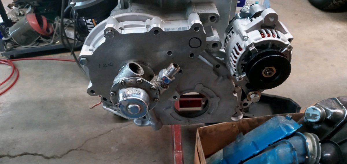

    I'm still stuck on this block growing and tightening up the chain. My plan was to use a 460 chain. I measured my block cam to crank at 6.082. It was listed earlier in the thread that 460 is 6.078, so I thought 460 would work as is. Wrong, I tried three different sets, all were loose. I was going to just drill out one of the three holes to hold a standard Ford pin like most Fords use, cut the cam off, drill and tap for a stock type 460 set up. But the I rolled the cam over and there was the damn key way. Still may do it with a 3/8 bolt that will allow me to run my fuel pump off the end of the cam. The other way would be to broach the keyway into the stock 460 gear and drill the three holes. All doable. I am using 9 key lower gear old SVO timing set.

    I have never heard of offsetting the cam for roller cam bearings, or for any other propose. Maybe just me being stuck in Alaska for the last 50 years. I have put roller bearings in a few 460's and know they didn't want a lot of press on the bearings. Again I would be afraid of putting roller bearings in the Mercruiser for fear they would fall out when hot. I know its been done before, but I don't think I will do it.

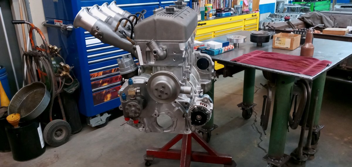

    Did you tell us what water pump that is? I like that it is centered over the crank leaving the end of the cam available for whatever.

    Its the same pump most are using here. I could not find the one Dennis G has or the other with the long ear sticking up. My pump is Gates 42221 for a 77-79 Toyota Corolla Starlet 3kc 1.2L engine. I have positioned it so the water outlet and the merc inlet are close and the hose connection is straight out. My back plate is 1/2 thick and will have to be remade to support the pump there. Its not quite centered like I wanted it. I wanted to use a fan bolted to the pump and wanted it centered in the rad. The pulley flange is drilled 6mm but is the same pattern as Ford. I think Dennis G did not block off the stock Merc cover, but I want to block it off so water doesn't run back down to the old seal area.
    So with all that said I'm thinking about this. Its a old marine pump its off the front cover of a nailhead I have laying around. Looks like it could be a simple hook up. waterpumpnailhead.jpg
