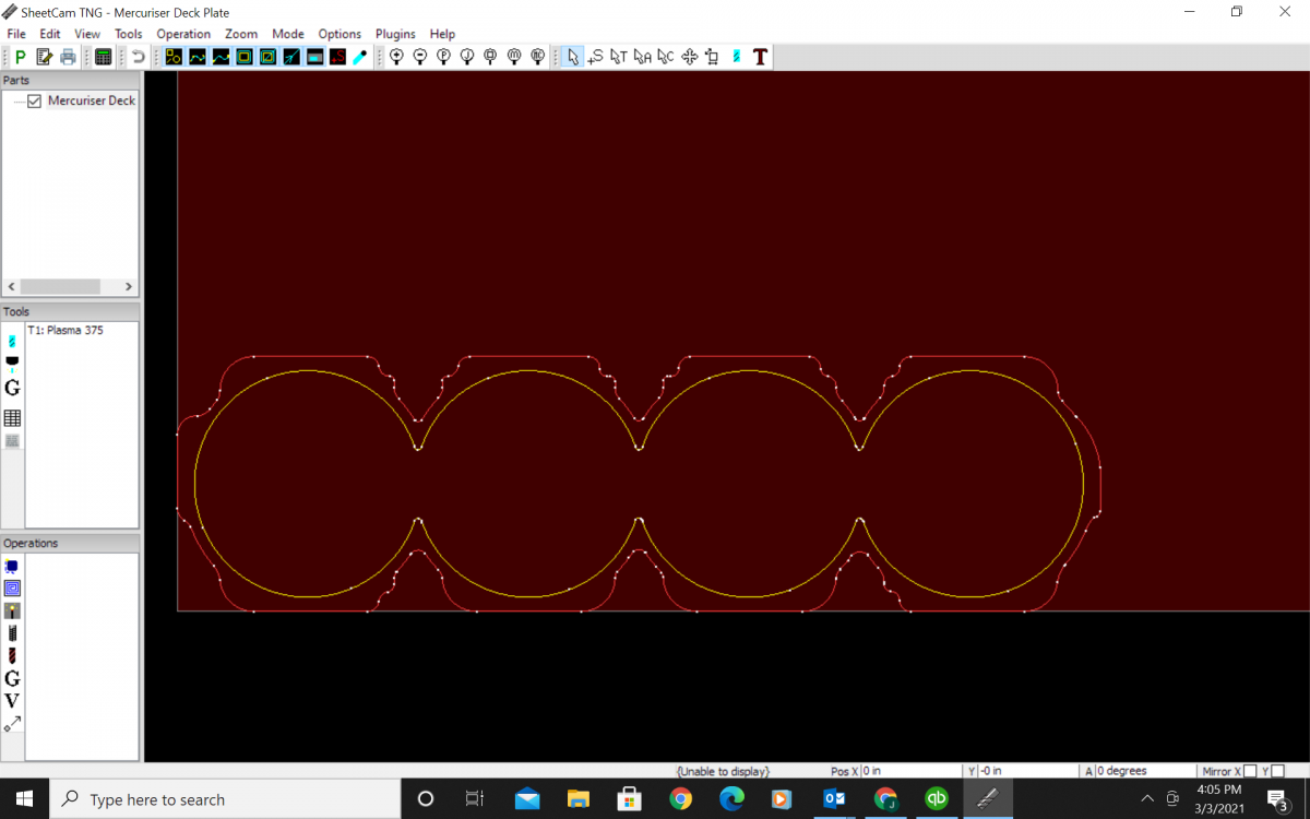

  20. Three Widow's Garage
    Joined: Jan 18, 2010
    Posts: 230
    Here is a screen shot of the .dxf file opened in Sheet Cam Screenshot (1).png
    Calkins likes this.
  21. Thanks for showing the image, the color is even nice. From it I see that our blocks have different contours around the head bolt holes and cylinders.
    1/4" or 5/16" takes less laser power than 3/8"
    When welded there should be no need for more than 1/4" and the weld will penetrate a higher % than thicker metal. Some aluminum alloys fracture immediately adjacent to laser cuts but welding may heal that. A deckplate has the added benefit of carrying more heat away from the very top of the cylinder.
    Thanks for going to the effort to show the illustration so I could see it.
