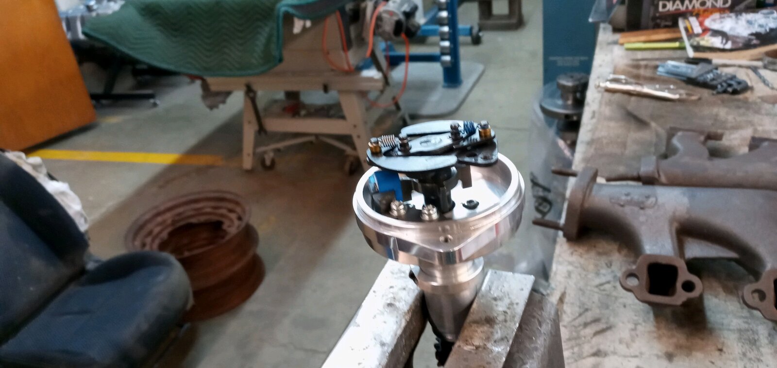

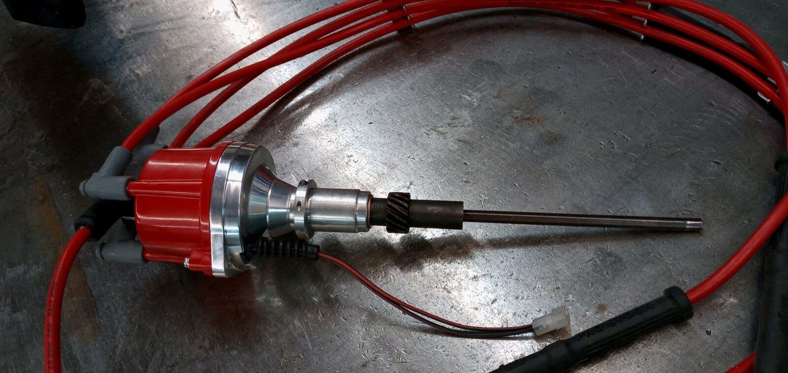

    I like msd distributors but they don't make them for the 3.7. so I made my own, well sorta. I bought cheap off shore stuff to see if it will all work. This is what I came up with.

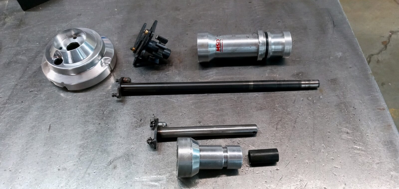

    I didn't take any pictures, but here is what I did. MSD makes a VW bug dist, so I
    I bought a bug dist from I believe was Southwest auto on ebay, $69.95, then I bought a small block Ford, $124.95, from the same for the shaft and housing. Both MSD knock offs. The bug dist is to short and to small od. I thought about sleeving it like the Merc but still needed a longer shaft. The small block Ford housing is I think .030 larger then the Merc. So turned it down to Merc specs, shorten it, made a slip ring to set depth. Bolted the upper and lower together. The shaft parts are .500 and the Merc gear is .470ish, so reamed the gear to .500. Slipped it all together, set end play, drilled and pinned the gear on. I can take pics later of the old parts, I'm sure it will explain it all a little better. Not knowing if it would all work and taking my time to make sure it would, I had about 5 hours in putting it all together.

    Here is a pic of some of the parts. The top shaft and housing are MSD small block Ford, the bottom is the bug parts I did not use. I only used the shaft and lower housing from the Ford dist.
    If that don't explain things, I will try again. I don't have a second Mercruiser dist, but am gathering parts to make another one.

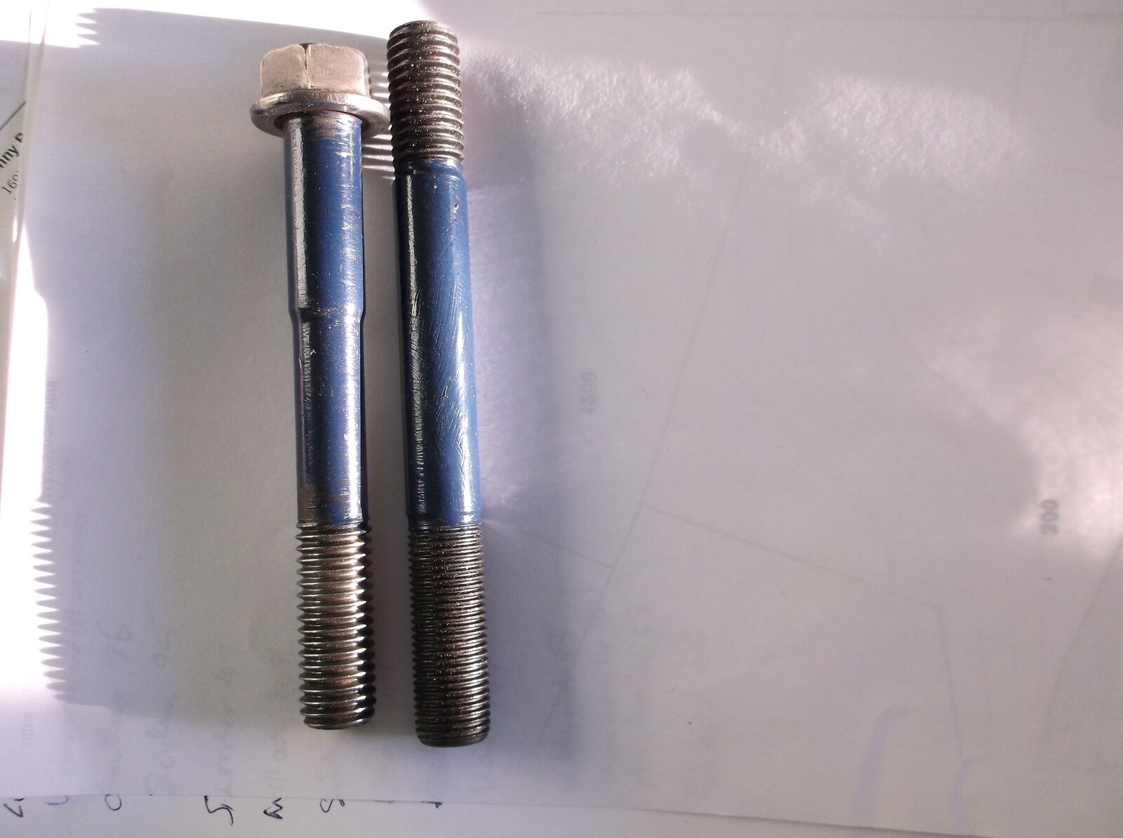

  12. stud reversed.jpg Warning: Speedmaster cylinder head studs for Ford 429-460 are made wrong.
    The factory rolled the fine threads too far down the stud and only rolled the co**** threads about half as far as they should have. The studs they made will pull out destroying your block. The picture shows a speedpro stud and a Frod (mercruiser) headbolt the stud is reversed to show how the threaded sections lengths compare. The speedpro thread only engages 75% of the amount of block that the Ford stud engages. This is serious and made more serious as die cast aluminum has about 1/3 of the shear strength of grade 50 grey cast iron.
    Another error in them is that the shank of the stud is too fat at 0.558 inch. This results in a rigid bolt that breaks instead of flexing. When a bolt breaks it is often in the threaded part near the beginning of the threads where the stress on them is the greatest. A fat bolt breaks before a more slender one which flexes in length. Volkswagen discovered this decades ago.
    Stock Ford headbolts have 0.500 inch diameter shanks.
    The proper diameter of the fastener shank will not exceed the minor diameter of the threads (0.480" as I measured it). because if it breaks, you don't want it to break in the block where the threads are. That diameter may be too much as it may need to be more slender to flex.
