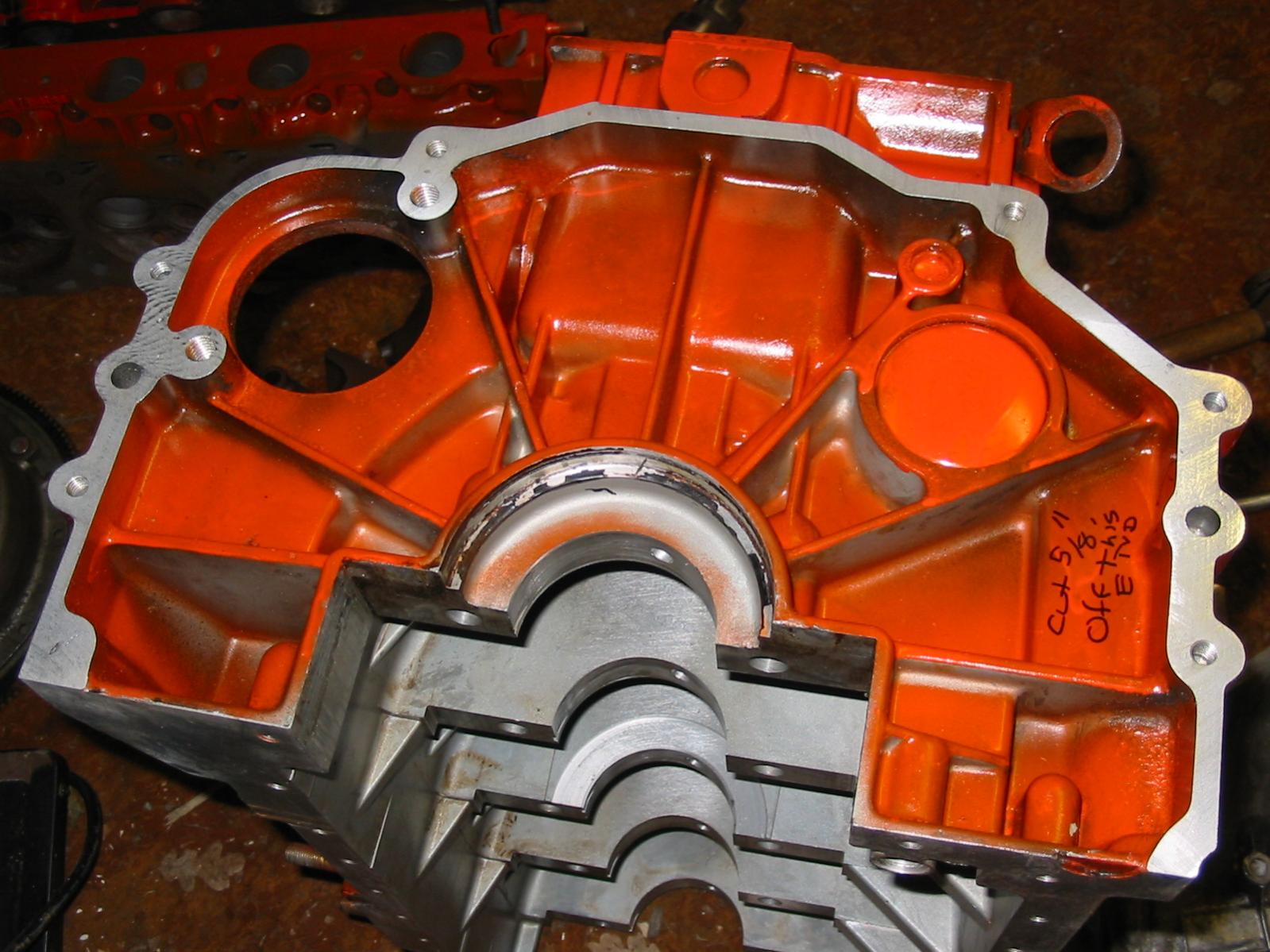

  1. It is not yet ***embled as I think I'll take the block out Tuesday for a freshening of its top surface.
    So If you just want to see pictures of parts, ok: first the milled rear surface [5/8" removed]. Then block pix flywheel pix and modified intake manifold [needed as I'll be using a stock Ford head but not drilling for a water outlet in the front of the head]. cut block.jpg

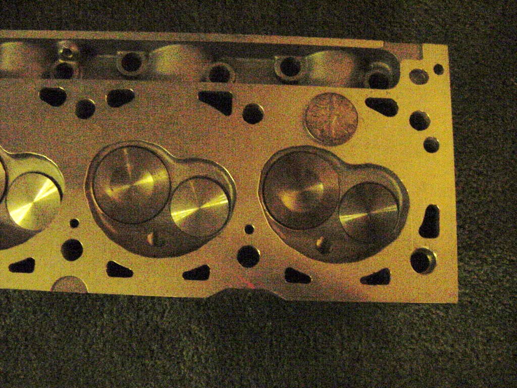

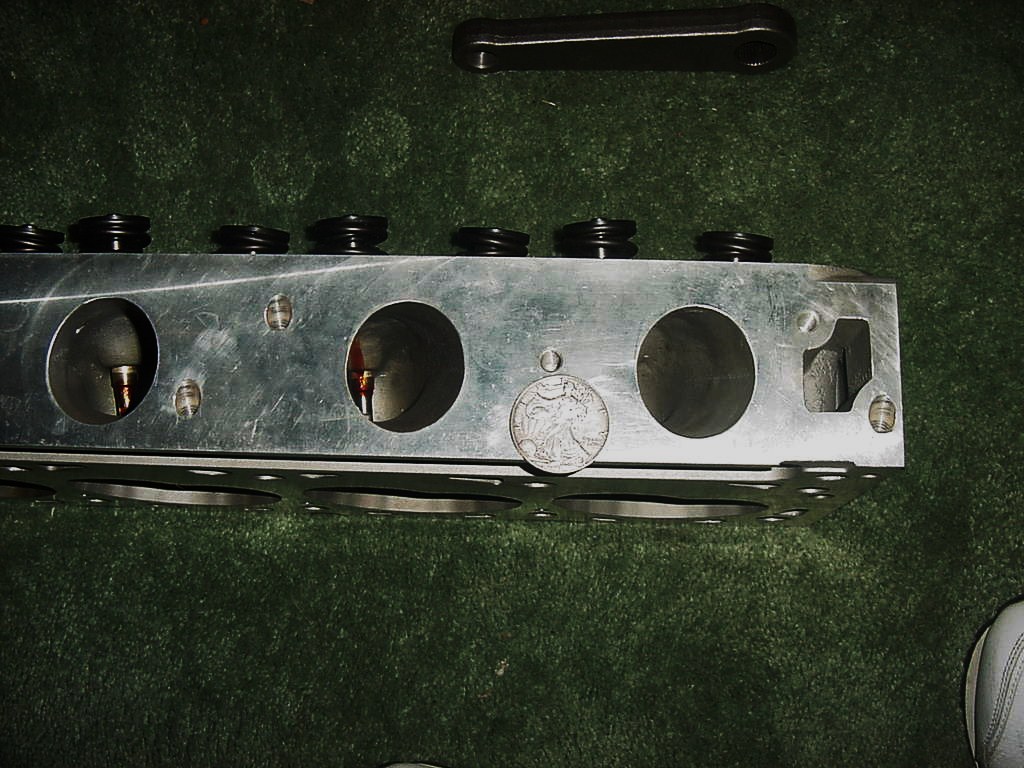

    The primary reasons that I am running the aluminum head doesn't have as much to do with pre detonation or squash as it does with bigger valves and ports providing better flow and with aluminum heads on an aluminum block.
    The intake valves are 2.19" and the exhaust valves are 1.76" and with the Mercruiser cam and the 1.72 rockers they provide about 1/2" of lift. The ports are large and smooth enough that I don't think I will have to port or polish them to achieve a very satisfactory result.
    The aluminum heads not only cool more efficiently but they also expand at the same rate as the block.
    In the original Mercruiser application with the heat exchanger acts as the radiator. It uses lake or sea water to cool the closed loop cooling water that runs thru the block.
    That way the engine runs at a constant temperature (170-180 degrees) as long as the system is functioning correctly. That system functioned pretty secuessfully if it was properly maintained.
    In a car the system relies on a radiator that hopefully is sucessful at maintaining tempretures near that range.
    My concern is that if I decide to drive cross country thru the desert and up hill when it is 109 degrees and the engine temperature gets up to 212 or more will I risk blowing a head gasket.
    In years past when some cars had cast iron blocks with aluminum heads or when they had aluminum blocks with cast iron heads they sometimes had gasket failures due to unequal heat expansion of the 2 dissimilar metals.
    The pictures have a silver dollar for size reference. If the valves were removed I think you could drop a hard boiled egg in the port and it would drop into the cylinder.

  17. I looked at clearance between the head & piston crown. .073" if my head gasket compresses to .050". However there is not much clearance between the exhaust valve and the bottom of the piston recess...I wonder if valve clearance is the limiting factor on removing material from the top of the block. Mercruiser said don't take off more than 0.010". I figured the clearance to be 0.010" if the exhaust valve is fully open when the piston is at t.d.c. [ I'm not sure the valve actually is fully open at t.d.c.]
  18. Ok, I bit the bullet and asked for my block to be zero decked. I see no alternative to doing it.
    The valves can be recessed in the head or the piston valve clearance recesses may possibly be deepened so I've an out if the valves interfere with the piston.
    I want .085" intake valve clearance and .125 exhaust clearance. and around .045 squish.

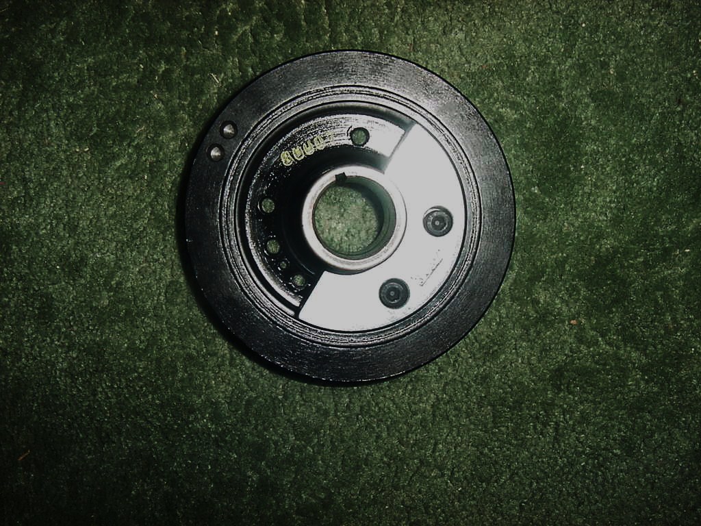

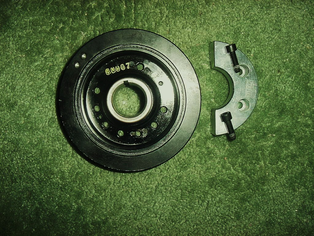

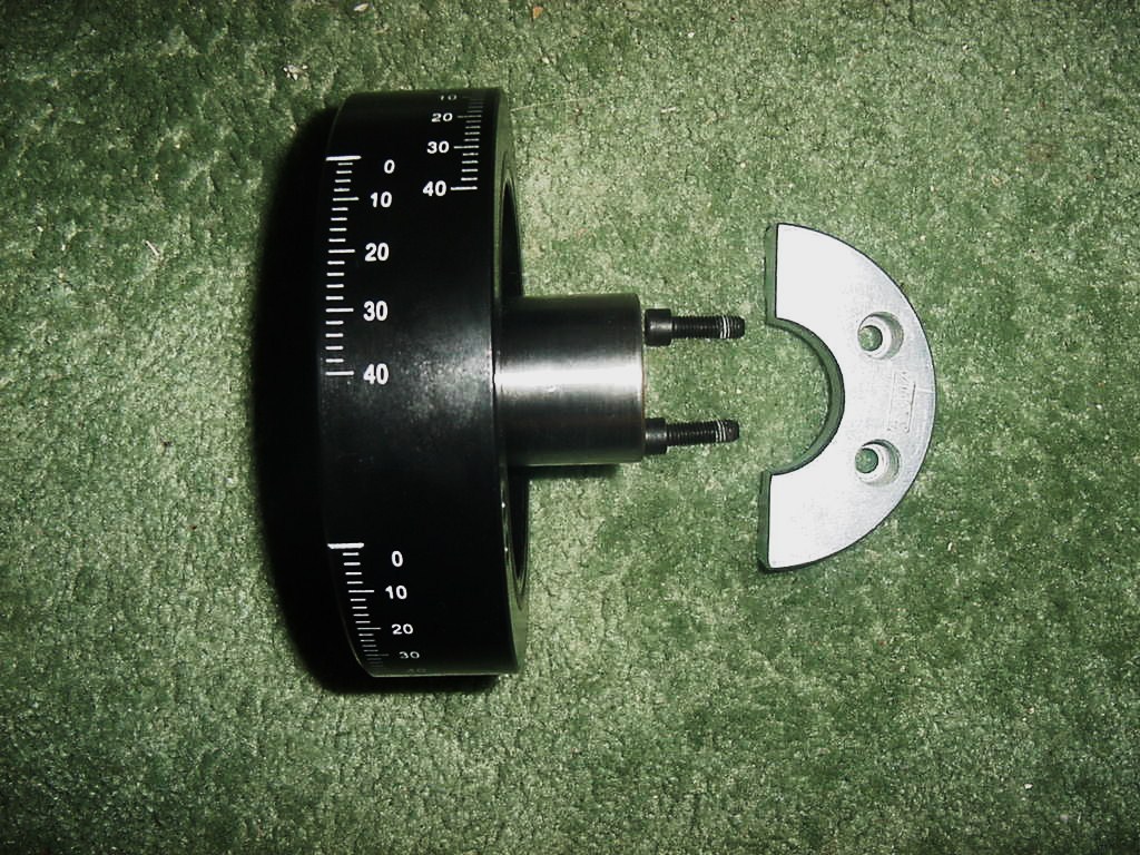

  26. here are some heavier ford harmonic dampers
    FORD 300:
    C8TE-C 13 LBS 65-68 3 BELTS
    E3TE-BA 12 LBS 65-81 3 belts
    C8TE-AB " " " " "
    C5TZ-J " " " " "
    FORD 351 :
    D1ZX-AA 13 LBS BOSS351
    NOTE : some ford truck dampers weigh up to 20 lbs
  27. dawford
    Joined: Apr 25, 2010
    Posts: 498
    dawford
    dennis,
    I am going to try a Professional Products S/B ford balancer from Speedway $67.99.
    The one I got has a removable 50oz counterweight which I have removed.
    With the counterweight removed it is zero balance and weighs about 10lbs.
    It also has 3 sets of timing marks.
    If the engine has too much viberation when it is in the car I figure that I will get another 50oz counter weight and install 2 of them to add another 6 1/3 lbs or get 2 of the 28oz and add 3 1/2 lbs.
    If I add the 2 counterweights I will have it rebalanced before installation.
    Others who have used zero balance mustang clutch and flywheels with zero balance S/B balancers have not reported any balance problems.
    Remember that the crank has only single wide conrod throws and extra wide counter balance weights.

  28. ****, thanks for the weight info...I did not have it. And the price info also as that price competes even with JC Whitney. I'd say you are right about adding the second 50 oz wt. I'm going to balance my balancer in any case as It will be free for me.
    The weights go on the rim, where they would be most effective, don't they?
    As these dampers [or dampeners] are a frequency tuned device, do you have any info on what frequency or RPM they work best at? More weight = lower frequency. I wrote the company for that info and will post it unless you beat me to it.
    their phone number is 323-779-2020
    Dennis
  29. dawford
    Posts: 498
    dawford
    dennis,
    The weights go on the inside of the rim where they won't interfere with the pulley and centrifugal force will lock them to the rim at rpm.
    As you can see the 50 oz weights are 1/2 circles that would make them easy to double up by drilling and tapping additional mounting holes.
    The only problem might be with interference with the pulley mounting holes that are already in the balancer.
    Still I really don't think the extra weight will be necessary in our application where we won't have to run at any particular sustained speed.
    The T-5 transmission will allow a gear shift to another ratio should any harmonic develop at a specific speed.
    I have a weighted arm that was attached to the tail shaft of one of the T-5 transmissions. I suspect that I might try to use it to dampen any harmonic that might develop.
    Again I haven't heard anyone complain about any balance problems in a street vehicle.
    If you just want a big heavy balancer use an original Mercruiser balancer with the magnets in it. Just loose the coils and get a power steering pulley for an external alternator.
    I didn't want to use the original balancer because it sticks out so far that it would necessitate moving the engine back even farther into the firewall.
  30. I bought the same dampener that you did. Thanks for your help in making the decision.
    Yes the original mercury alternator rotor is really big, and the magnets are brittle and only glued in. I was going to use it until one magnet fell out. I then decided that I had to get a dampener. Not only do they look much better they are also heavier and cost less than a rebuilt Ford dampener.
    As to the weight, I also asked for a 50 oz one. You don't want the weight sitting on the rim though as the weight seems to screw into the center part of the balancer. The rim must be rubber-isolated from the center for it to absorb vibration well.
    My alternator rotor has a pulley as part of it.
    And I also have engine length problems due to the big alternator rotor.
    I think there would also be some dampening effect from a belt driven alternator
