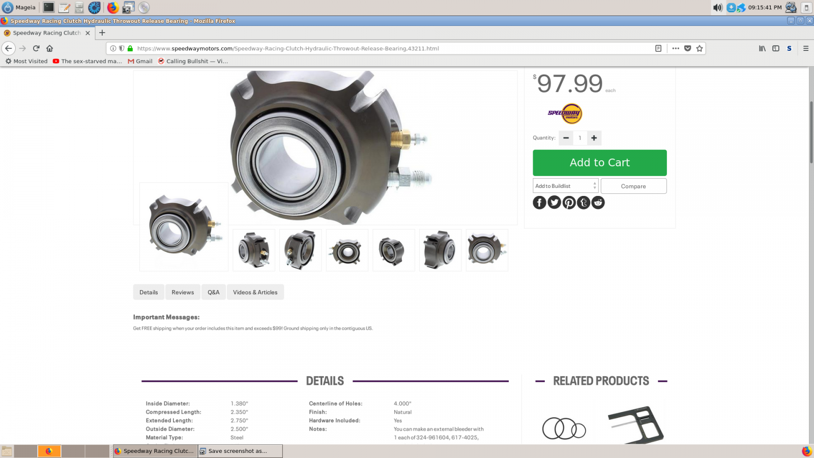

  15. Would this fit?
    gm clutch throwout5.png.png full]5326615[/ATTACH]

    That looks like the throw-out bearing behind my motor. The one I bought specifically states that it is for small diameter racing clutches only. They may make them for the larger diameter clutches also. The front of my transmission is the same as a Saginaw. This bolted up nicely, but remains to be tested.
  17. arse_sidewards
    Joined: Oct 12, 2021
    Posts: 344
    arse_sidewards
    from Central MA
    No.
    If I was a normal person running a normal Chevy trans it would.
