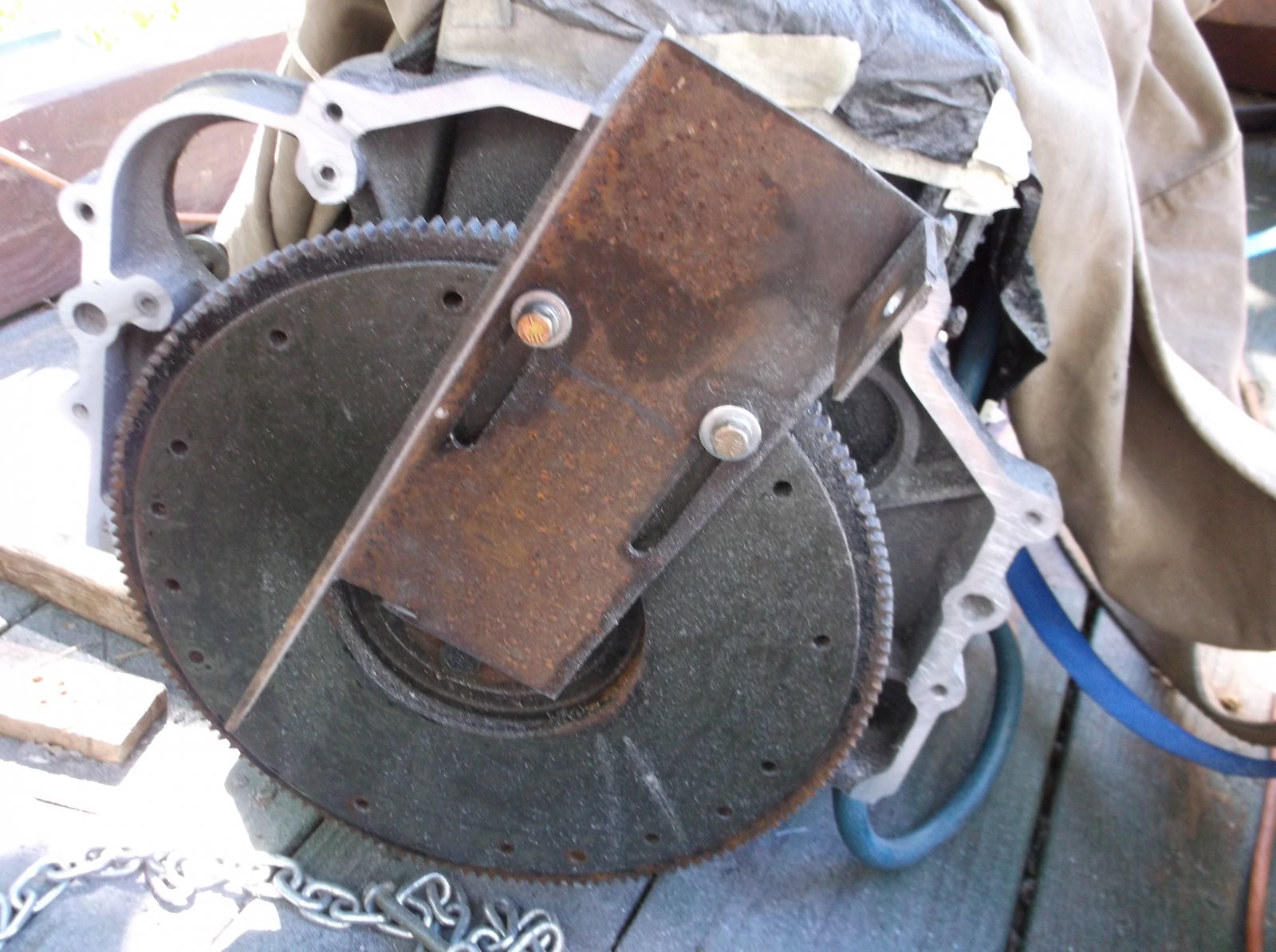

  2. update on making grinder holding fixture:
    I have the holding fixture in rough form and have suggestions. I had some rusty folded channel about 135 thousandth thick. So I cut it down to the size as it was about 2 foot across. I'm glad it was not thicker as it cut so easily with a 4.5" angle grinder. I cut away one side and then drilled and welded on a little piece to support the other side of the grinder as I was going from a two feet wide channel down to a 100 mm wide(interior) channel. It seems rigid. It looks ugly.
    I put the little side on by pinch welding it as I did not want to fight a warped fixture. Easy to break off but it isn't going to withstand much force. I needed slots in it for the bolts to the flywheel. and milling was not working out as I could not clamp it well. I solved yhat by drilling a 5/16" hole at the end of each slot and cutting between them with a cutoff wheel that was now smaller. It was way faster, quite easy and more accurate than milling wobbling steel. but crude in appearance. The slots are slightly wider than necessary but I will put washers under the bolt heads.
    The grinder sits flat in the fixture by itself. It was not much cut and try as the measurements I gave worked out.
    The cutoff wheel is deeper than it needs to be, so I will elevate it with a 3" x 3" shim x (looks like 0.225" thick is needed). A very shallow test cut will be needed to see if the measurement is ok.
    I'm really glad I scribed a line where the cut is to be as it makes checking the cut height possible as you go along.

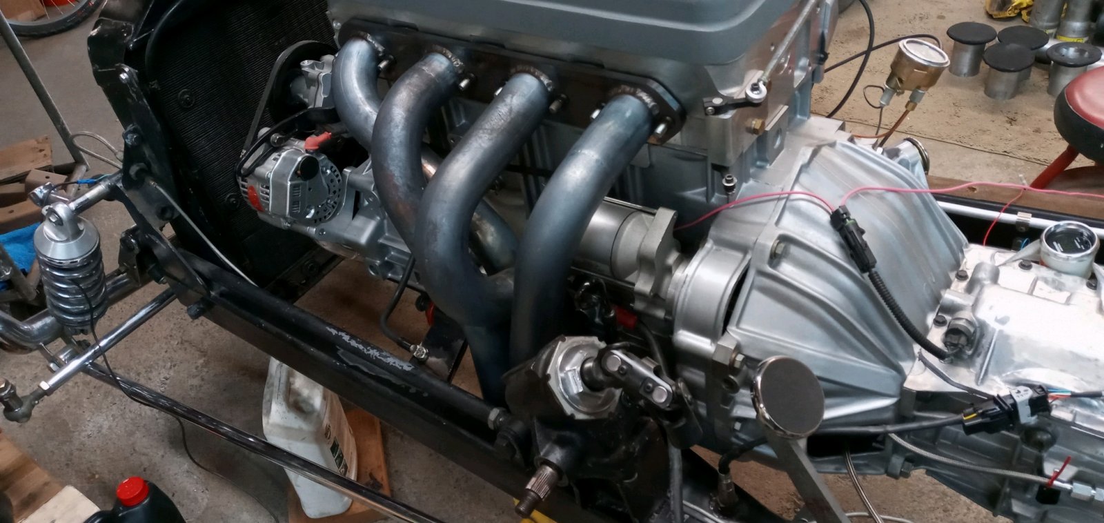

  4. It looks lovely. Nicely done. Is the little linkage to a brake booster? And is that a car bellhousing? It looks like one.

    The linkage bolted to the head? That is throttle linkage running over to the injector. I am using a 621 bellhousing,(3899621), yes I believe it is a car bellhousing. It is for a 168 tooth chevy flywheel. As a side note chevy 153 tooth bellhousing will not work unless a lot is trimmed off the bottom. numbers 421, and 403 don't work well. I have the 621 and a 444 that do work.

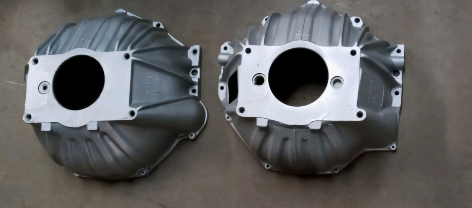

    A quick look at bellhousing will tell you which one you need. See the starter pocket on the left one? That is the one that works. The one on the right is for the 153 tooth chevy and you will need to cut most of the bottom off to make it work. Both are car bellhousings. bellhousings2.jpg

    Dennis, are you saying the Mercriuser is a 168 tooth flywheel? All of mine are the Ford 157 tooth. In my picture above the left is for the chevy 168 tooth and the right for the 153 tooth. As far as I know all the 168 tooth chevy's will work on the mercruiser, truck or car. I have no cast iron ones, so I can't speak for those.

    Same. The flywheel is noticeably smaller than the 168t truck stuff I have kicking around.

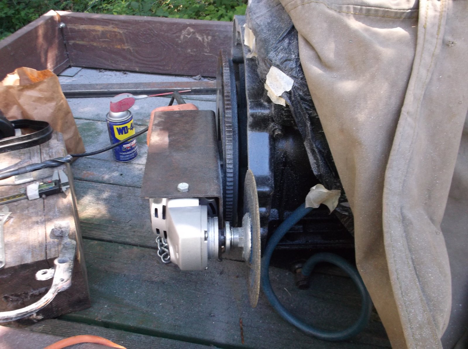

  11. I compared the length of 3 chevrolet bellhousings I have here. Their height laying flat is the same. The truck bellhousing has the same bolt pattern but is larger around its bottom. I was itching to cut my block and did it outside finishing the cut just before dark.
    The cutoff disk did not load up with aluminum. The grinder gearbox became too hot to hold. The cutoff wheel became hot also so I stopped every few minutes for cooling. The heat vaporised the wd40. This block has starter mounting studs and I cut through the ends of them. The pretty sparks ignited the WD40 so I blew the small flames out.
    A 7 inch disk with a nut and dished center worked very well except that there was a metal stiffiner on its back side which interfered cutting the extension which is around the starter nose. I just pushed it through and it distorted the cut width a little so Tomorow I will remove enough to have the flange an even height( It took 98 th.) There were a few spots where I needed to cut slightly deeper more than the abrasive disk would do without lengthening the slots in my grinder fixture so I used a hacksaw (it looks like a keyhole saw)to finish 3/16" of the cut in the few places the disk could not reach.
    The cut surface is smooth, much better than I expected. Hearing protection is highly advised. It was wonderful fun doing this.
    Yes, it was easy to make a consistent cut often within a very few thousandths of my scribed line. Problems began with deep cuts which interfered with metal onthe back of the abrasive disk.. the grinder mount is quite stiff as it must be. I even chained the grinder handle down to the flywheel. The disadvantage of my fixture is that it must come apart for any adjustment by shims. The cut would take about 20 minutes for 2 complete p***es. Cutting is slow in the very thick places but the rest is reasonably fast. It is necessary to tilt the engine at each end of the cut to make room for the abrasive disk and whatever the engine is resting on at both ends of the cut. The cut must begin on the distributor side of the block and go to the starter side of the block.

  12. I made finishing cuts today as the first cut was off in some places. I drilled 5/8" center holes in washers of the following thickness: 54 thousandths, 73 thousandths, 98 thousandths. the washer fitted between the abrasive disk and the grinder. The cuts were made with single washers as spacers to cut deeper. I was suprised at how quickly and easily the aluminum ground down. A whole flange grind took only a few seconds for a 20 to 30 thousandths cut. I cut 98 thousandths off in steps and it looks good so far. I will fit a bell housing to it as a check.
    The pilot bushing will need to be pushed in 98 thousandths deeper to maintain the Dupree depth setup dimensions.
    If you need to remove material I suggest that
    7/16" be the first cut with a cutoff wheel.
    Then go to the final dimension in a series of 50 thousandth steps stopping at the 5/8" scribed line. These removals are with the face of an abrasive disk. I used my cutoff wheel for this and it worked well even dry.
    but after 3 cuts aluminum bits began sticking so WD40 helps if you don't have a disk designed for aluminum grinding.
    A surface grinding abrasive disk is thicker and probably stiffer but I did not try one.
    This shows the grinder with its handle reversed bolted into its fixture. Normally, a chain holds its handle to the flywheel but there was so little force on the grinder in light cuts that bolts were enough for the rigidity needed for a very light removal (30 th).

    Nice job @dennis g . The pictures made it very clear as to your set up and procedure. I had envisioned it with the block standing on it's nose. I'm surprised that the disc didn't load up even with WD40.
