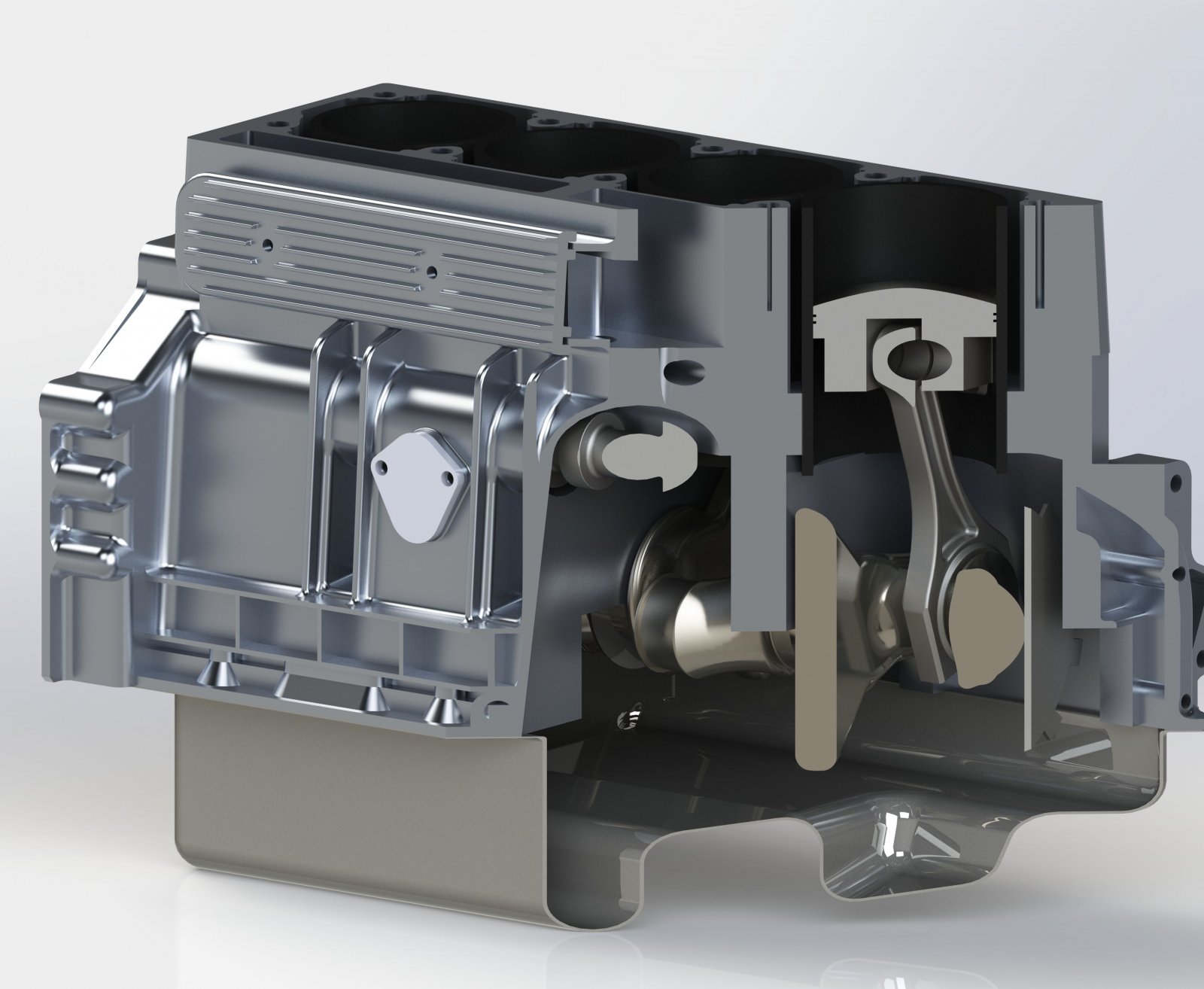

  6. Sean Lougheed
    Joined: Dec 26, 2021
    Posts: 40
    Sean Lougheed
    from Canada

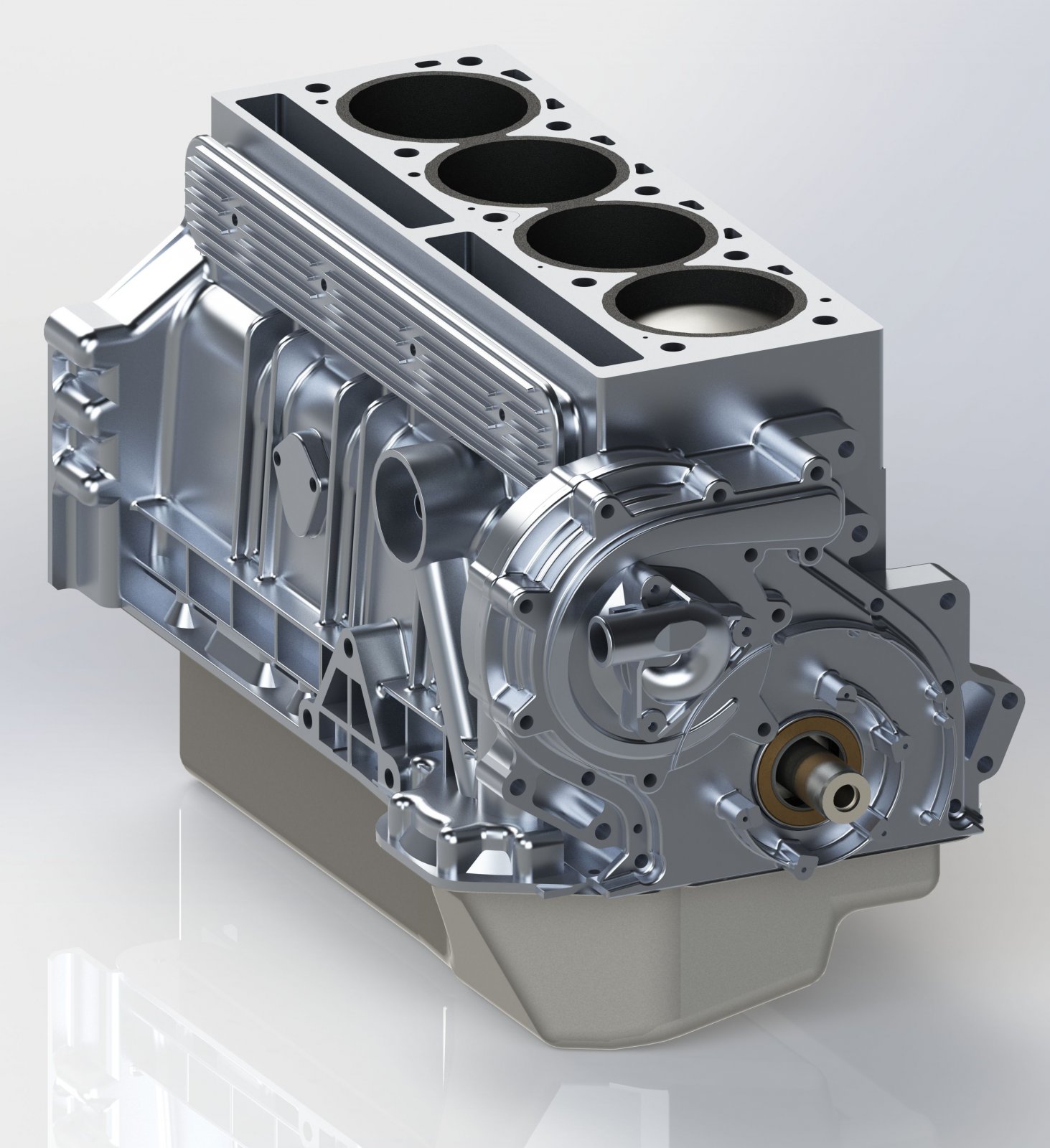

    I want to thank Dennis for the work on an index. This board is by far the most valuable repository of information out there on the 470 and I too have spent hours too going "I know I saw it here somewhere".
    I also wanted to pop in and give you some gasket files and an update.
    The gasket kit I got has no pan, timing cover or water pump gaskets, (Mahle) just a big sheet of material for a frustrating DYI project. If you get the same or just need one of them, these templates will give you the design - either print them and trace or as I am going to do, use the zipped DXF file to laser cut them out.
    I have completed drawing the short block of the 470 in 3D and post a sliced and complete view here. The next step is to add the head. It has been a lot of work as I am a bit of an OCD accuracy freak, but it is proving invaluable to "fitting" the motor and transmission into the roadster - which is also being done completely in 3D. It is a tight fit in the roadster and this it is very quick (and cheap) way to make adjustments. I would be happy to p*** on the model as a stp. or such to anyone here crazy enough to do the same.
    Trying to fit engine internals like con rods to check clearances would be a breeze as I have digitally probed the blocks internal dimensions so have an accurate crank case to check clearances by, but to get even an outline of a con rod from any manufacturer is met with dismay. The recommended procedure seems to be buy a set of rods and see if they fit. - you have to be kidding? If I can get some con rod models I will post up what stroke is possible in one of these engines. All I know so far is it's somewhere between 4.25 to 4.5 using a 2.2 journal. The limiting factor is the side of the block where it is very thin so there is no ability to grind anything in that area to go bigger.
    Enjoy the files and pictures and best regards to everyone.

  8. GearheadsQCE
    Joined: Mar 23, 2011
    Posts: 3,670
    GearheadsQCE
    Alliance Vendor
    I think that the maximum stroke possible is somewhat dependent on the rod journal diameter and the design of the rod big end. When offset grinding the rod journal the arc described by the outermost section of the crank throw does not change.
    Since the original diameter is 2.500", offset grinding down to 2.000" will give you an increase of .500". The original stroke is 3.75" giving you a max stroke of 4.250". The practical limit of offset grinding is probably closer to .475". A 2" crank pin (SBC) would be the max I would consider. For the very brave, the Honda size might be a possibility.
    Now, if you weld up the journal to get more material out there, that changes things. The limit would depend on the space inside the case and how small you could make the rod big end. (as Sean pointed out).
    Those 3D drawings are absolutely beautiful! I wonder if you could get some connecting rod samples from an engine rebuilder on a loaner basis.

  10. Sean Lougheed
    Posts: 40
    Sean Lougheed
    from Canada
    It does depend a little on the rod as Gearheads points out. The only actual model I have gotten is Bill Miller aluminum rods which I thought odd as he gives out a totally accurate model. Everyone else is paranoid that someone might see something to copy which is not he case with a 1D view that would show the outer most line of the rod, cap and bolt - which is all you need to check the clearance.
    Oh, and the aluminum rods are huge and have no chance to swing in a stroked 470, so we are looking at good steel rods.
    Thanks for the complement on the drawing Gearheads
    chryslerfan55 and Calkins like this.

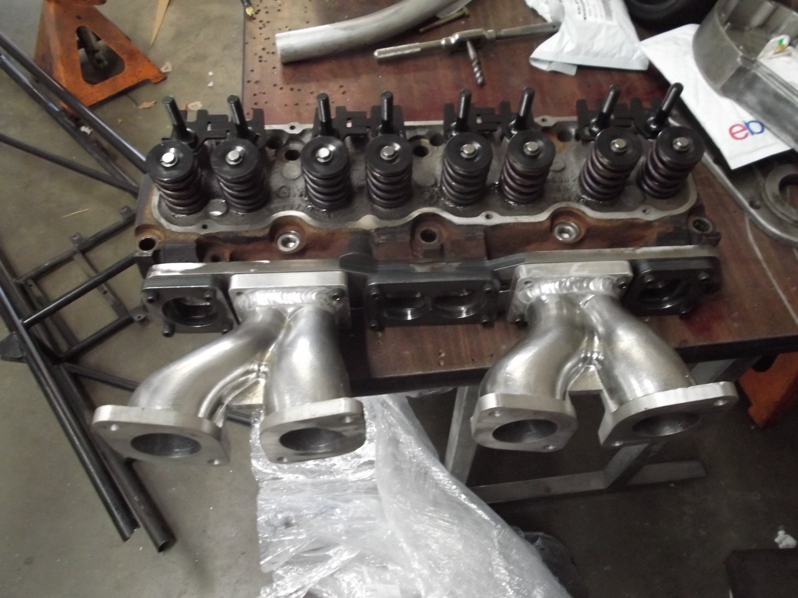

    Looks like he is making a dcoe weber intake for the other Mercruiser, the Chevy 181ci.

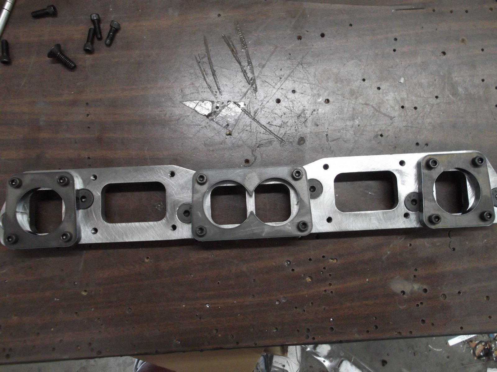

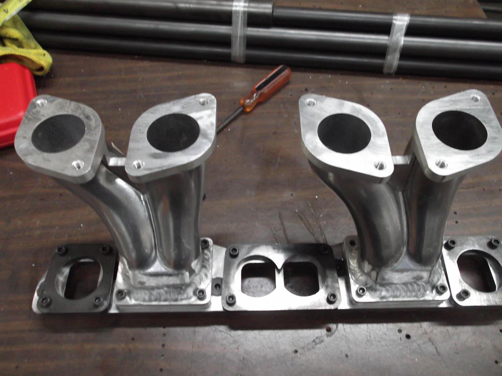

    Actually, I'm using the Webber manifolds as cheap formed runners into the head for which a plenum box will be attached with 2 inlets. The adapter allows me to convert the 6-bolt head to individual intake and exhaust flanges. I'm building a blown 4-banger, and I'm driving the 4/71 blower off the crank---Potvin style instead of normal belt drive upload_2022-9-21_8-54-17.jpeg

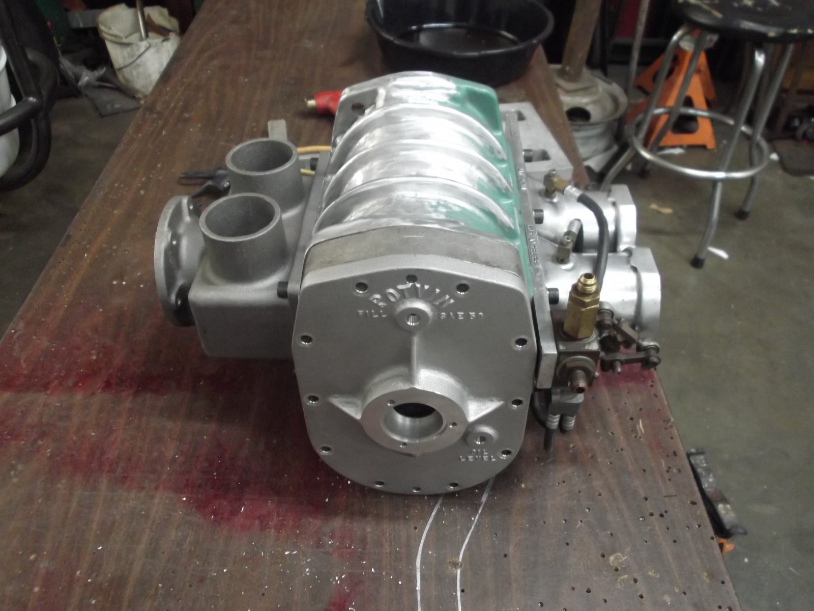

    Posts: 698
    Flatrod17
    Can we see more of it?
    I have a pair of IDA VW intakes I didn't know what to do with. New uses for them!!

    Engine is in the progress state, gathering parts and pieces

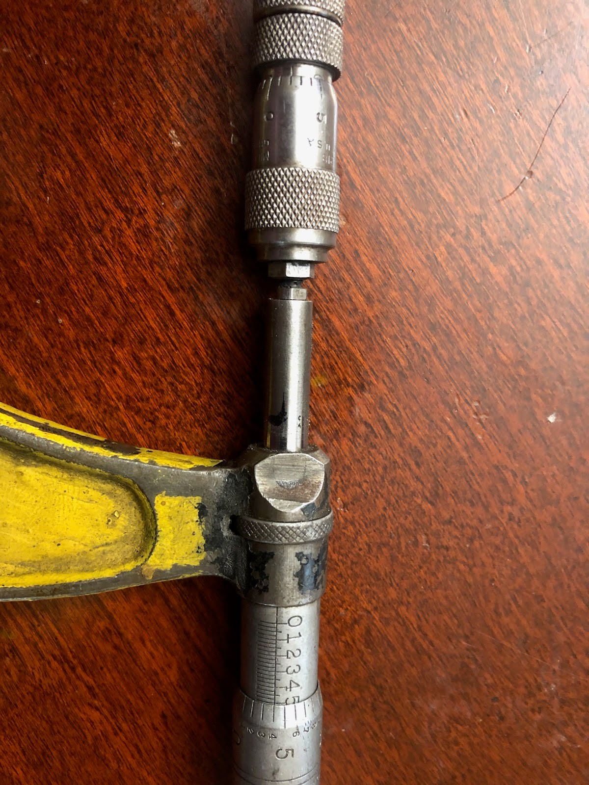

    How far out of concentric is too far out for a pilot bearing?
    I'm making an insert to fit inside the coupling hole in the Mercruiser flywheel and locate a pilot bearing. I can get it within .0015 of concentric on my rotary table. I think that's good enough unless someone tells me it's not and has a good reason why.
  25. Flatrod17
    Joined: Apr 25, 2017
    Posts: 698
    Flatrod17
    I would think .0015 is plenty close. I would expect .002 at least input nose to bearing clearance. I say go for it!
