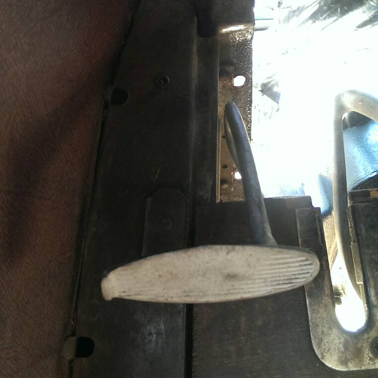

    The A column fits pretty well but the pedals need some work. I wish I could use the old wood but it's no biggie.

    Did you run into any problems w the a pedals. On my build which is a 27 touring on 31 a ch***is, my brake pedal worked just fine but the clutch pedal I had to heat and bend a bunch to keep it from fouling on the firewall. Also my a column actually lined up well and I modified the t dash/column mount to work with it.

    Clutch pedal needs work for sure and I need to extend the throttle up a bit.
    The column is almost center. I need to make a small spacer at the box then I will modify the factory mount like you. I thought about just clamping it over when I mount it but I can see it twist the frame and would rather not introduce the stress.
