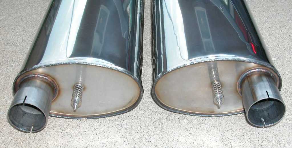

    Danny, I was fortunate to have been able to work with a true welding professional, another gentleman named Danny here in my area. He, like you obviously are, is exceptionally skilled and I recognize some very nice work from you too. Please allow me to post one shot that demonstrates why I can see your expertise in your work. I witnessed it for 16 sets of 304/409 st. st. mufflers. Great job on those headers!
