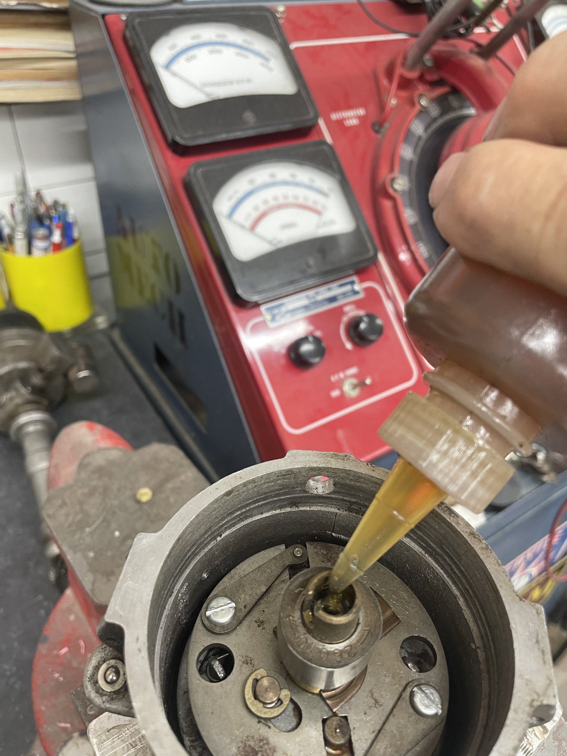

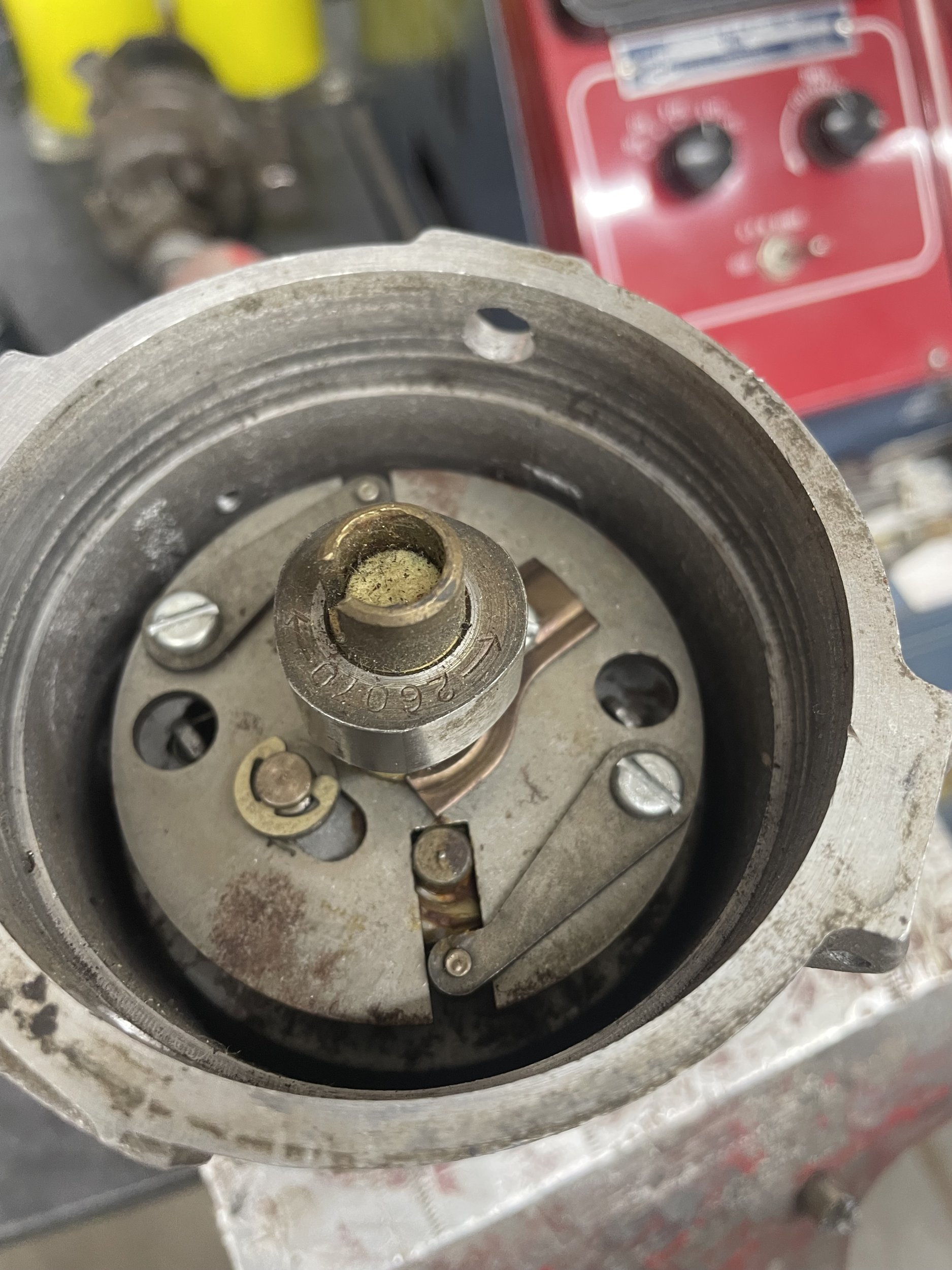

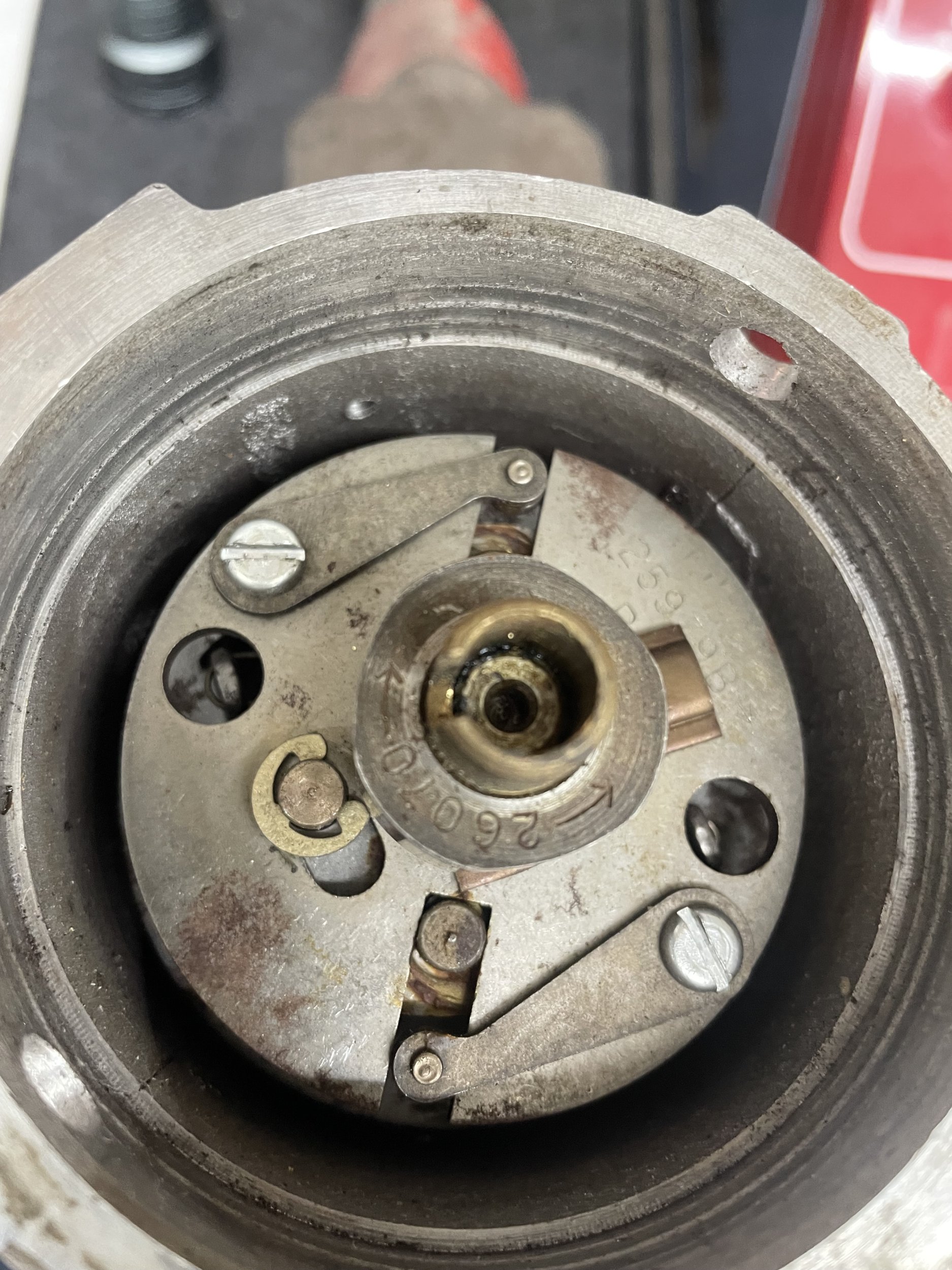

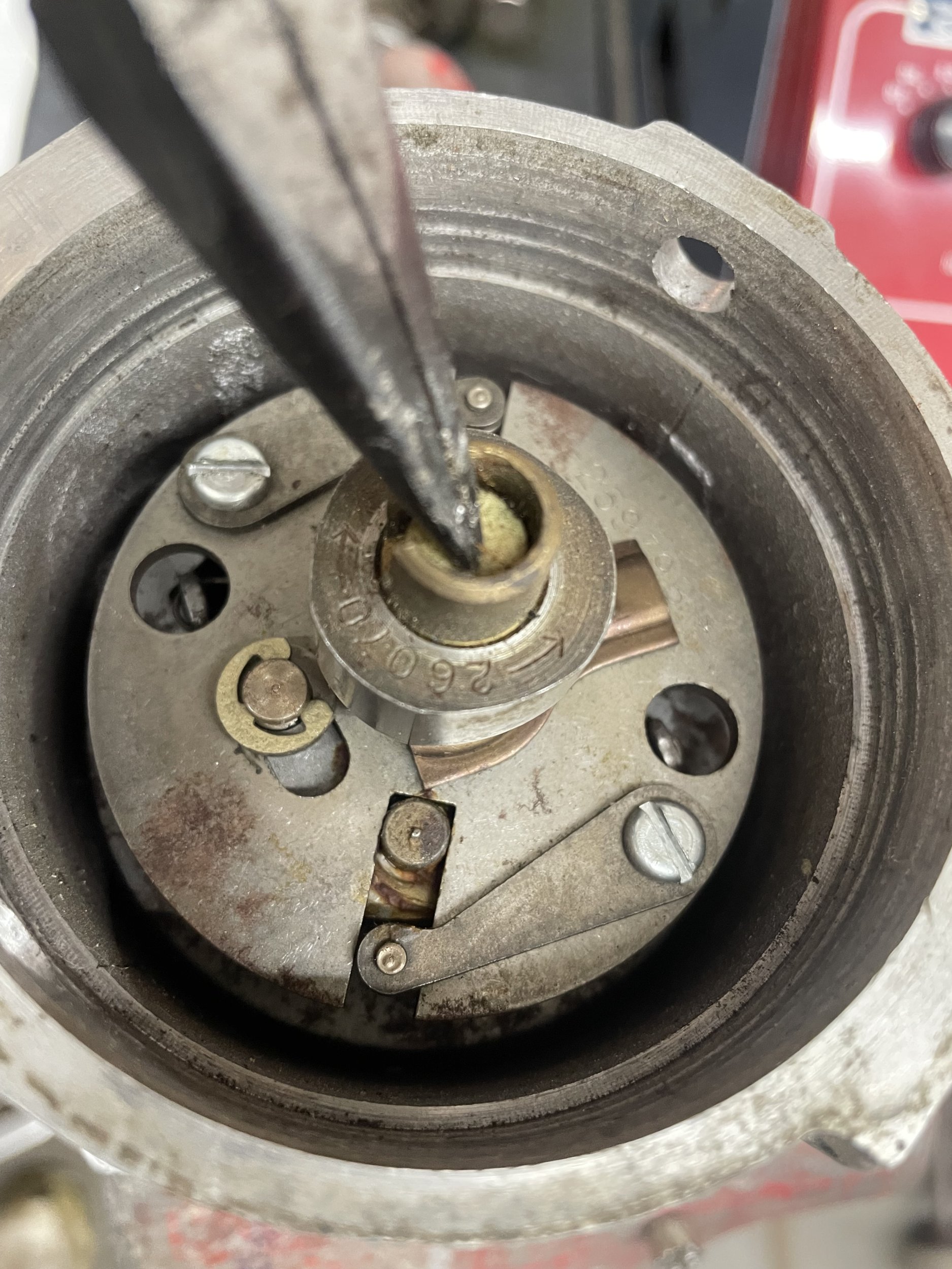

    You should be able to grab the rotor and rotate slightly and feel resistance from the advance springs. If you can’t move it, maybe it is seized. I know these pictures are of a Mallory but it should be similar. Remove the felt pc under the rotor and put a few drops of oil in there and see if it frees up

  10. it turns and i can feel the springs, so i think the advance is good. when i replaced the points i dropped a screw and replaced it with one that was slightly too long. i bumped the starter with a screwdriver and i heard a grinding sound so i removed the screw and shortened it. i think somehow my distributor got moved back when i did that. the timing is now set to 0 or even retarded. i can drive just fine once im up to speed but no power to get me up to speed. lots of backfire.
