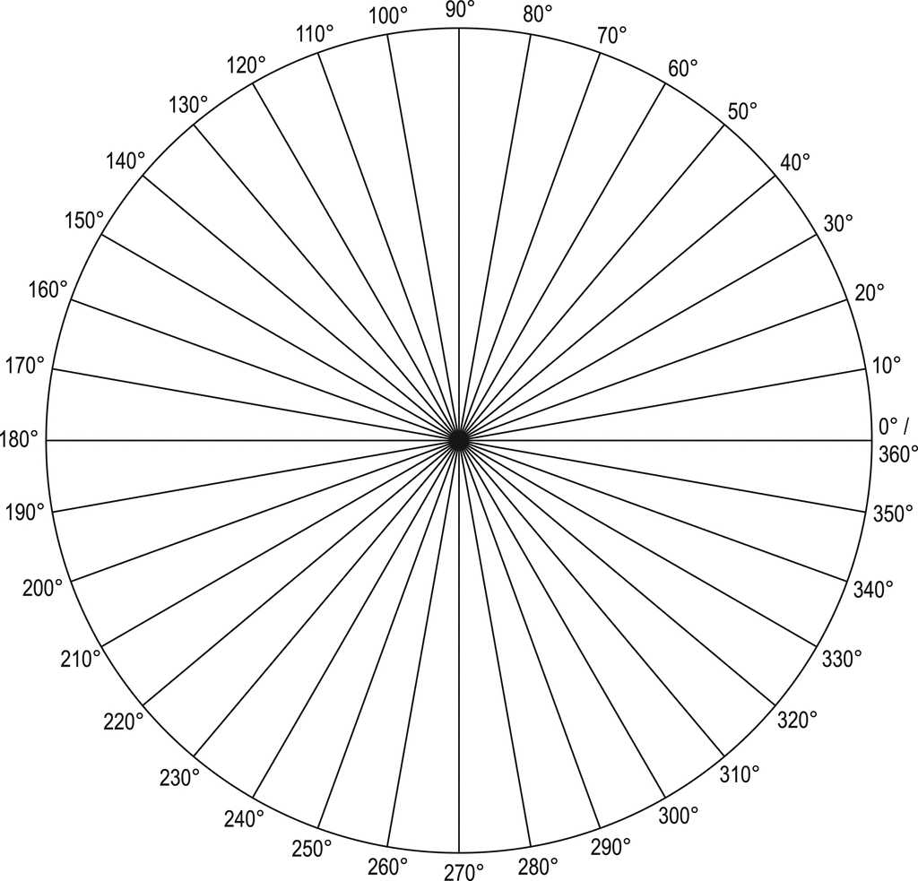

    If you can picture a three hundred sixty degree circle, those are the same degrees of change in timing.
    The typical dist cap and body is about 3-4 inches across. Rotating them to get 5 degrees of timing change is roughly a 1/16 to 1/8 of an inch around the edge. A little goes a long way!

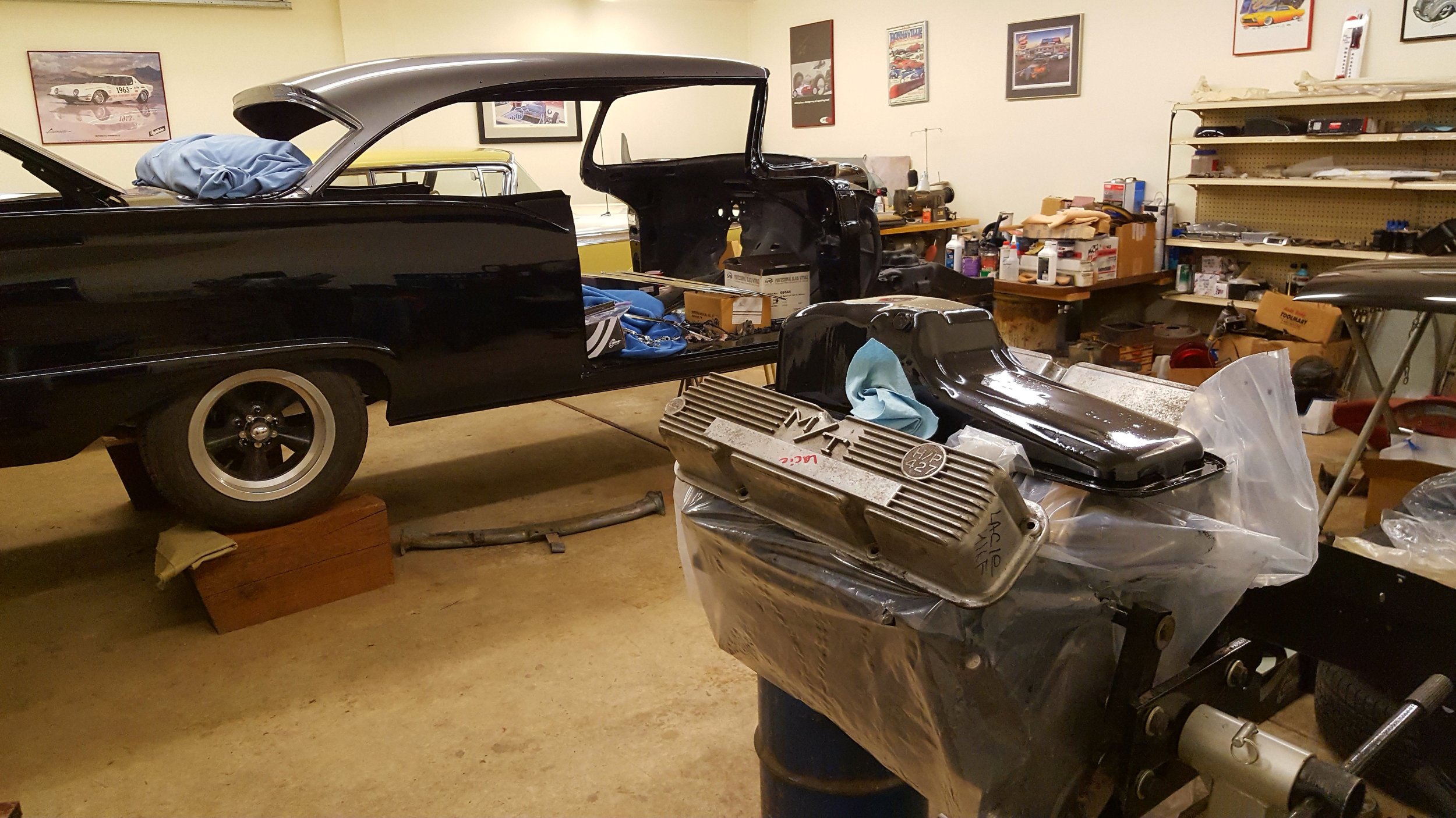

    This makes me feel good knowing where that Old Torch will for a while. Some back story on it. That fine unit was bought New by my Dad. He was a multi-talented fix everything guy. As I grew up, I seen what it could do and learned pretty well. As my Dad aged out that torch continued to earn it's keep in my hands. As time went on rebuild and ware parts disappeared. Last time I used it the acetylene turn valve leaked enough (had been for a while) to light up in my hand again. That's when I retired it and hung it on the wall. That was about 1975 and a new Victor Journeyman took its place. B-B and I was talking one day about making some trophy's and for whatever reason I handed it over. I guess it was meant to be and Odd as it may seem The_Cat_Of_All_Ages and I have a bit in common. I bought my first 1957 Ford in 1960. She was a sweetheart 500 Hardtop. I have always had at least One and often more 57's since. Here are photos of 2 of the 4 I currently own. The Black Hardtop has made more progress since this photo. The photo of my Convert is of it on the way for a new exhaust system. It too has made more progress. I can also tell you that Torch has left its mark on both of these as well as my right hand and up my arm. You should have seen it prior to B-B doing his detail job on it, had I known it could look so good it would be in My Trophy room gathering dust. I'm very please it was p***ed on and landed with a 57 Ford owner.
    P.S. Do not hook it up to a pair of tanks unless you are waring some asbestos arm wraps.
    [​IMG] [​IMG]

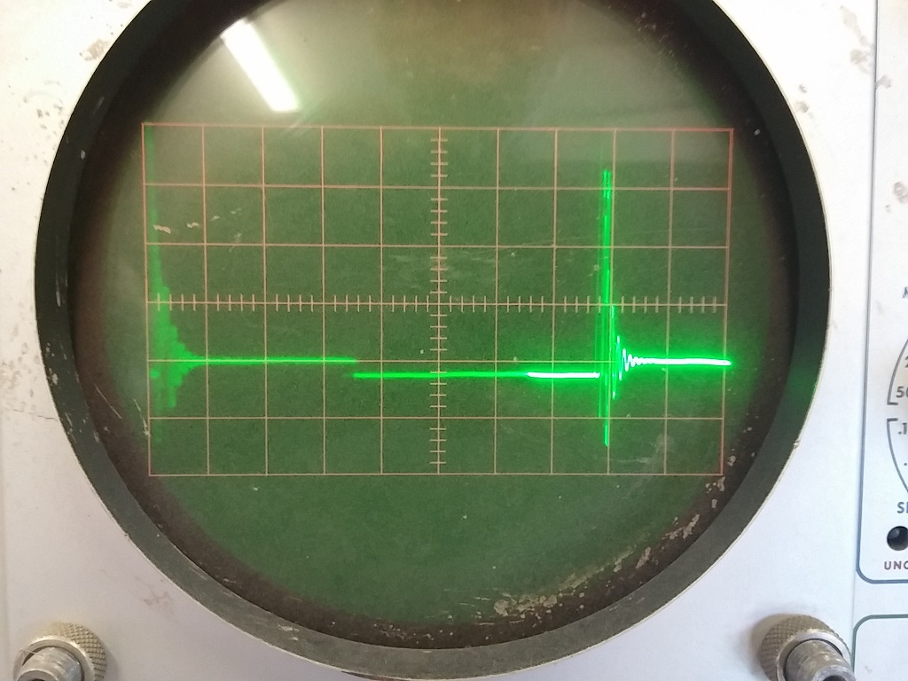

    If by "ground wire" you mean the (-) terminal of the coil, it's NOT ground! The way a point ignition system works, the primary side is a tuned LC circuit that oscillates over a couple hundred volt range. So you should expect to get zapped if you touch that terminal when the engine is running.
    If you look at it on an oscilloscope, connected between the coil (-) terminal and ground, you can see it's not just a simple on/off 12v DC signal. On this image, you can see the 12v "on-off" part of the trace, between the big oscillations. Think about the voltage scale, that peak is over 10 times as big as the 12v part, so that's a lot of voltage! like touching an AC wall outlet, but not as much current available.
