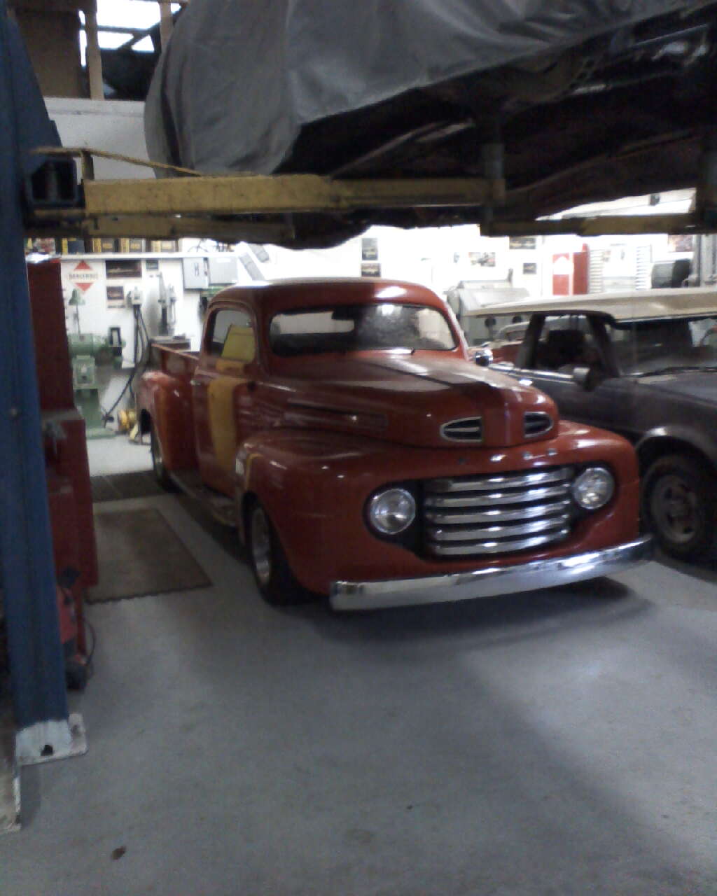

    Got the truck home tonight and i`m stoked it a fkn beauty although it has a few warts they will be easy to fix.
    It came with 72 Nova drum brakes on the truck and a pair of 73 Malibu disc brake spindles.
    Is this a direct bolt on? My mate thought there might be a ball joint problem but he could not remember.
