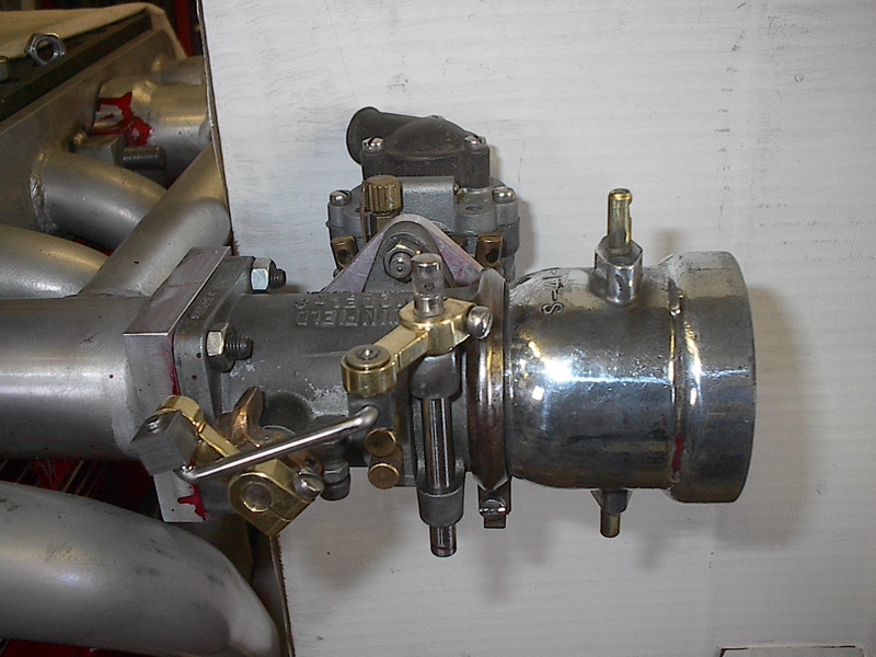

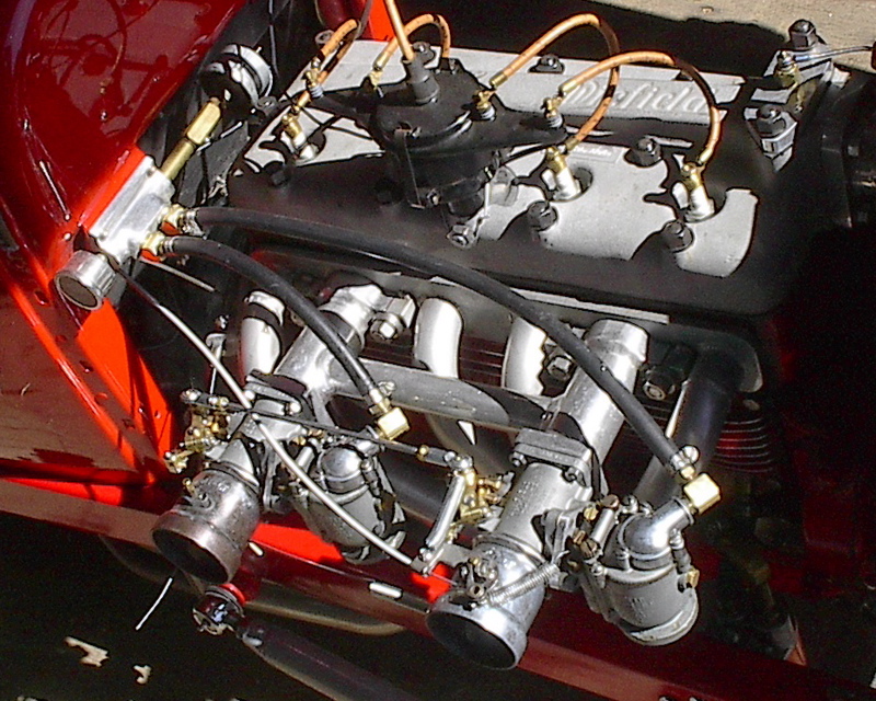

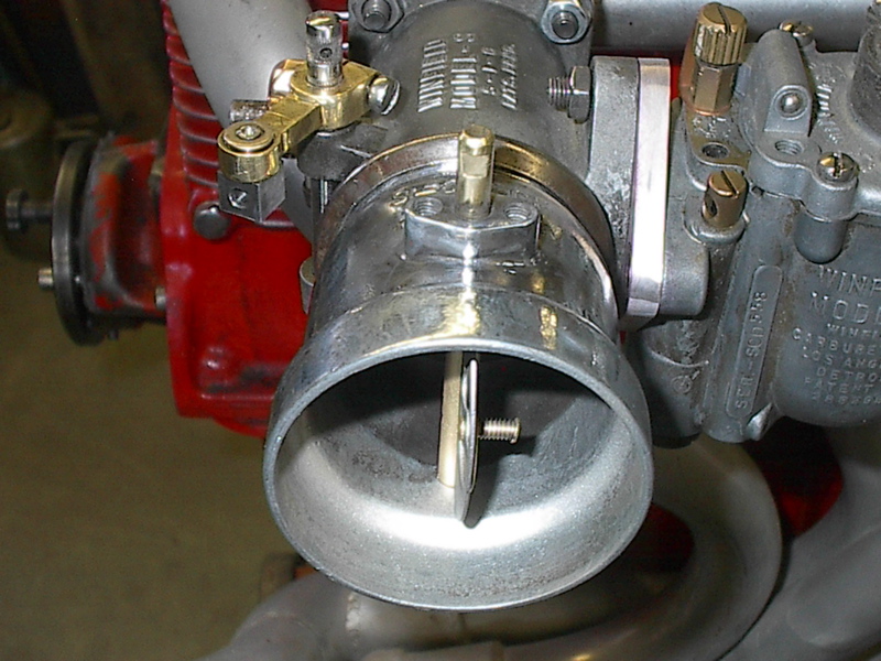

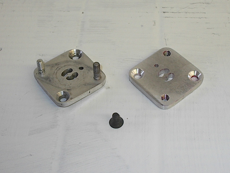

  2. I have with Winfields. They work. You can chamfer both sides for the Allen flat head and then they will work on up or down draft just by flipping the adapters. The largest I have converted with the plates is a size "C". The settup in the photos is a pair of "BB"'s. I do not use the pumps on the SR's. I make my own throttle body to float chamber gaskets as the universal "one size fits all" gaskets available have too many holes. I also make my own linkage. Nothing but time. As I have stated before, my first pair, one of which is on the left in the photo were made with a Dremel tool and part of a 6 pac of Coors lite. You do not have to alter the carburetors.

  7. Winfield carburetors.

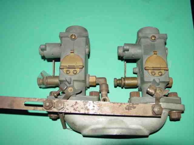

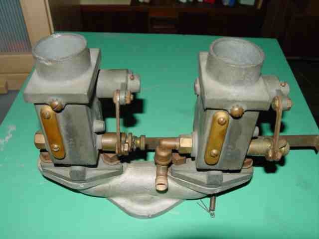

    A short primer. There is no mystery about using and setting up winfield carburetors on most of our "A" or "B" engines. While all of the articles and reprints of literature and earlier articles tell you to open the intermediate and high speed jets 32 clicks and start from that setting and go through a series of adjustments to properly set the carburetor. I have found that opening the intermediate 27 or 28 clicks seems to work, at least for me. Single or dual. I open the high speed jet 36 clicks. I have used "Color tune" and an Edelbrock air fuel mixture gauge and have found that the intermediate needle seems to work at the clicks I stated. Just think how fast the car would be if I tuned it properly! The idle mixture jet controls the air, contrary to what you may have read.
    The float level is critical. The bowls should be as close to level as you can get them when setting the level. Winfield manifolds that I have checked are machined from 2.5 to 3 degrees. I set mine static, that is with the engine not running. If you have to bend the lever I recommend removing the lever from the top and bending it in a small vise. You only have to break one float lever pivot boss in a float chamber cap to fully understand why I say this. I lap the needles in, made a small tool that keeps them centered while lapping
    The air bleed size is also important. I have found that most have been drilled oversize. The air bleeds are designed to restrict the flow of fuel from the wells. If you have a carburetor with oversize air bleeds they may seem to "blubber" almost like the engine is loading up when you get off of the throttle and right back on after a hard run.
    I set my carburetors in front of my garage which is at approx. 3850 ' above sea level and make no changes. i used to think I needed to but have not really found it necessary.
    Dual linkage must be accurately balanced. No slack on either end.

  14. I have used single Winfield carburetors on a downdraft Winfield manifold in the past. After the engine reaches normal operating temperature they run fine. You have to have them at operating temperature to adjust them. Most of the Stromberg single down draft manifolds have the heat flange on them while Winfield down draft manifolds have no provision for heat and are known, at least in my opinion, to be "cold blooded" until warmed up. I think a single "BB" would out perform a Stromberg on the same engine. This is MY opinion. Also, you don't have to search for the best size jets or power valves
    Ed Winfield is quoted as saying (I'm paraphrasing) "Any carburetor that takes a wide variety of p***enger cars from 5 MPH to maximum speed is also going to be a good racing carburetor" He felt his market was the person that desired more performance, reliability, and fuel economy. The use of his carburetors on race cars was his best adverti*****t.
    I read a quote somewheres in the past where he said the "B" would flow 120 or there about.
    The main problem with the old carburetors is wear. I reworked the "BB"S's on my 2 port to where it could idle down to 500 RPM's I built up the thin edge on the "****erfly" with JB weld on one that showed more daylight in that area than the other. You just add a little every day after you dress down what you applied the day before. Set them so the JB is down so it will not flow the wrong way. Final dressing is with 400 wet or dry fitted to the throttle bore and stroked up and down until the ****erfly moves freely. It has to have clearance. Some really show wear in that area, I guess it comes from running dirt tracks with no air cleaner
    Some times the ****erfly seems to be stuck but it is actually the shaft binding in the bronze bushing. I have some adapters to back the bearings up while I lightly tap the shaft back and forth while applying light oil and they will free up. This will move the shaft in the ****erfly so be careful if you try this. You DON"T try to free them up by hitting or putting too much pressure on the possibly 80 year old ****erfly. I have replaced loose bronze bushings on the throttle shaft bearings, by loose I mean they turn in the throttle body casting. I only work on my own carburetors. I don't want the responsibility of possibly damaging some ones treasure

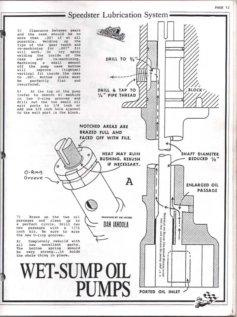

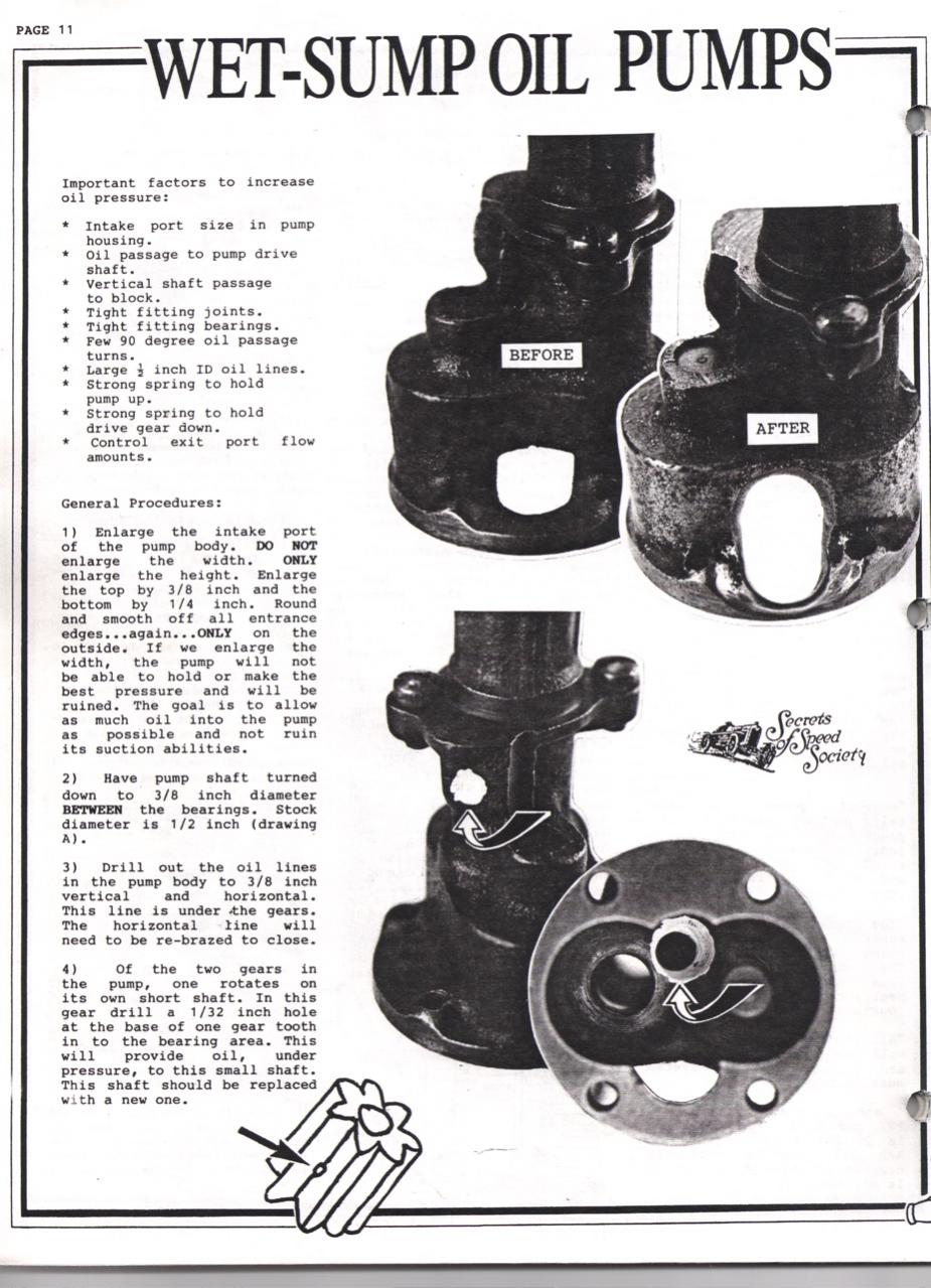

  20. ok a few questions
    i have b engine that was a stock rebuild, babbit, c balanced crank .040 over
    i have a good foundation for hopping it up
    i have a stipe 340 cam
    adjustable lifters
    dan price timing gear set
    should i use regular ***embly lube when i put this thing together?
    also does anyone have a quick print of the oil pump mods to the shaft and intake port of the pump?
    i know not to make it wider just taller (the opening)
    but how much do i take off the pump shaft Dia
    thanks
    tk
  21. Crazydaddyo
    Joined: Apr 6, 2008
    Posts: 3,372
    Crazydaddyo
    Here are the pump mods
