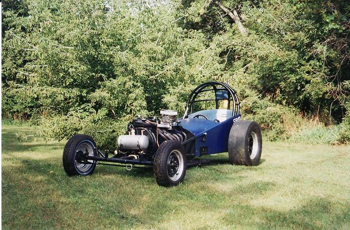

    Here is a shot of my car.
    Shift light is on the back of the blower.
    Tach is just for checking stall speed during warm up.
  2. What I'm looking for is the best places to put switches and handles. I think I will put the shifter up high on my right and the switches over the rearend housing. I'm with you Lippy on the trans. cooler I just don't think the oil will get hot enough to warrent it, one less thing to worry about. :D
    One more thing I noticed the lack of gauges in most of the cars, I have already got a tach, oil pressure and water temp gauge so I will install them even if I rarely look at them. :rolleyes:

    I've done a little bull riding when I was younger and I've got a hunch that strapping your *** to that rearend housing would generate about the same adrenalin rush, I'll have to try that some day:D

    You need to be sitting in the car. Suit on ect... to position things where you are comfortable. Just looking and putting things in there won't work or be safe. You MUST be able to reach things easily. As far as the shifter, do you have a hand brake? Is it on the right or left? On the right then it's a given your shifter will be in the middle or on the left. Think about leaving the line, with a hand brake you will have your left hand on the wheel and be holding the brake. The car will be in low, now you must quickly grab the wheel with your right hand and bump into high with your left hand so the shifter must be easy to hit without hunting for it. Now think about shutting the car down in the lights and all the movements you will make, you don't have time on a short shutdown to THINK about where everything is. You must hit the chutes, wait for the chutes to hit, then grab some brake, pull the fuel shutoff, hit the mag switch and turn off the track. We run our chute release on the brake handle so I can make a sweeping motion on the handle and be on the brake if I need it fast. Fuel shutoff in the middle with the H.S. and fire bottle knob. Take your time and sit in the car and think it out. And the less stuff in the car you have the less confusing it is and you don't have to worry about bumping stuff when you get in and out. One guage, OIL. Temp guage is for? Even if it gets hot, what are you going to do? you have a problem elsewhere then. Stop and get some water somewhere? :D Voltmeter? Why, unless your running a bunch of electronics that require a bunch of juice. If you run a mag, then a kill on the wheel, a starter ****on somewhere, plug in the batteries to start it. Go have fun.:cool: JMO the less stuff you have on the car the less chance there is of something going wrong at a bad time. K.I.S.S. JMO Lippy
