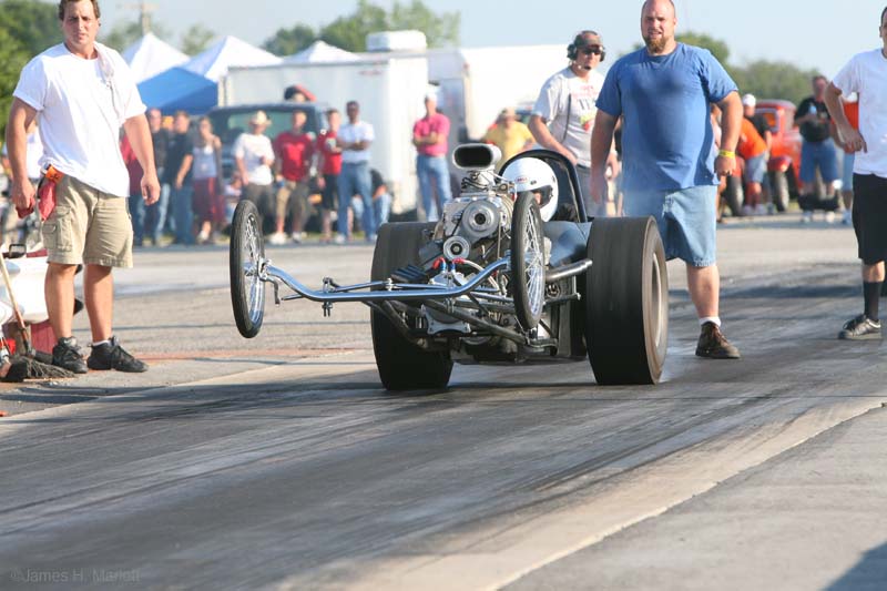

    Rich,
    the "paint" was a very authentic bare metal look<G>. Check my post in the dragster frame thread to see more or look on dragracingonline.com in their March Meet coverage (I think that it is on the Saturday page).
    Oh, what the hell, here is a shot of it from the pits at Famoso and one back at the Van Nuys shop on Monday.
    Roo
