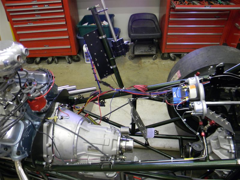

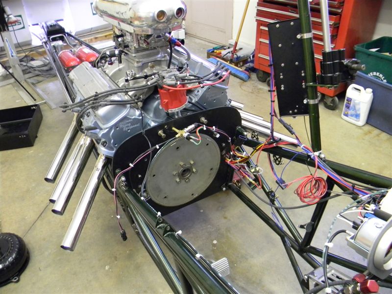

    Not sure why your car would have right side steering unless the box was a modified p***enger car unit. You may have to swap the steering arm to the left spindle to get the P & S box to work.
    Here are a couple of pix of how most box install look. Having the cross member bolted in can be a benefit if you want to pull the transmission out through the top of the frame rather than raising the car enough to get it out the bottom. The mounting bracket in the photos is a McKinney piece that will fit the P & S box as the SPE, Strange and Flaming River boxes all have the same mounting bolt pattern. Murf has the bracket available in a couple of configurations (above and below the tube) and Neil and Parks also have a nice one available.
    Brendan Murry's NT/F car
    Glenn Lever's car (carshopowner here on the HAMB- see his earlier post)
    Roo
    ps Love the big radius cowl

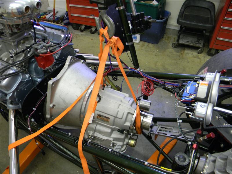

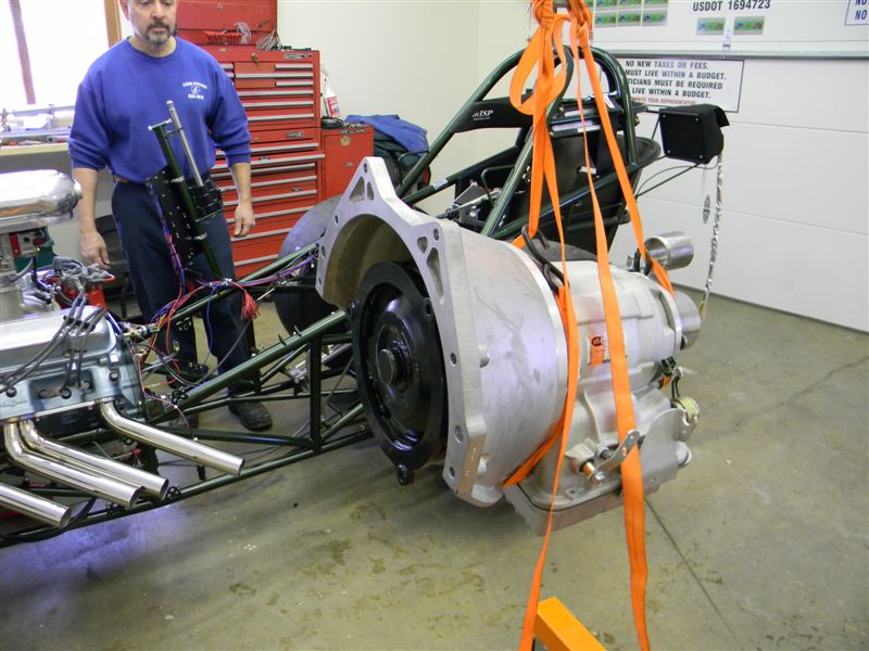

    See below on the advantage of having the steering gear box on a hinged bracket.

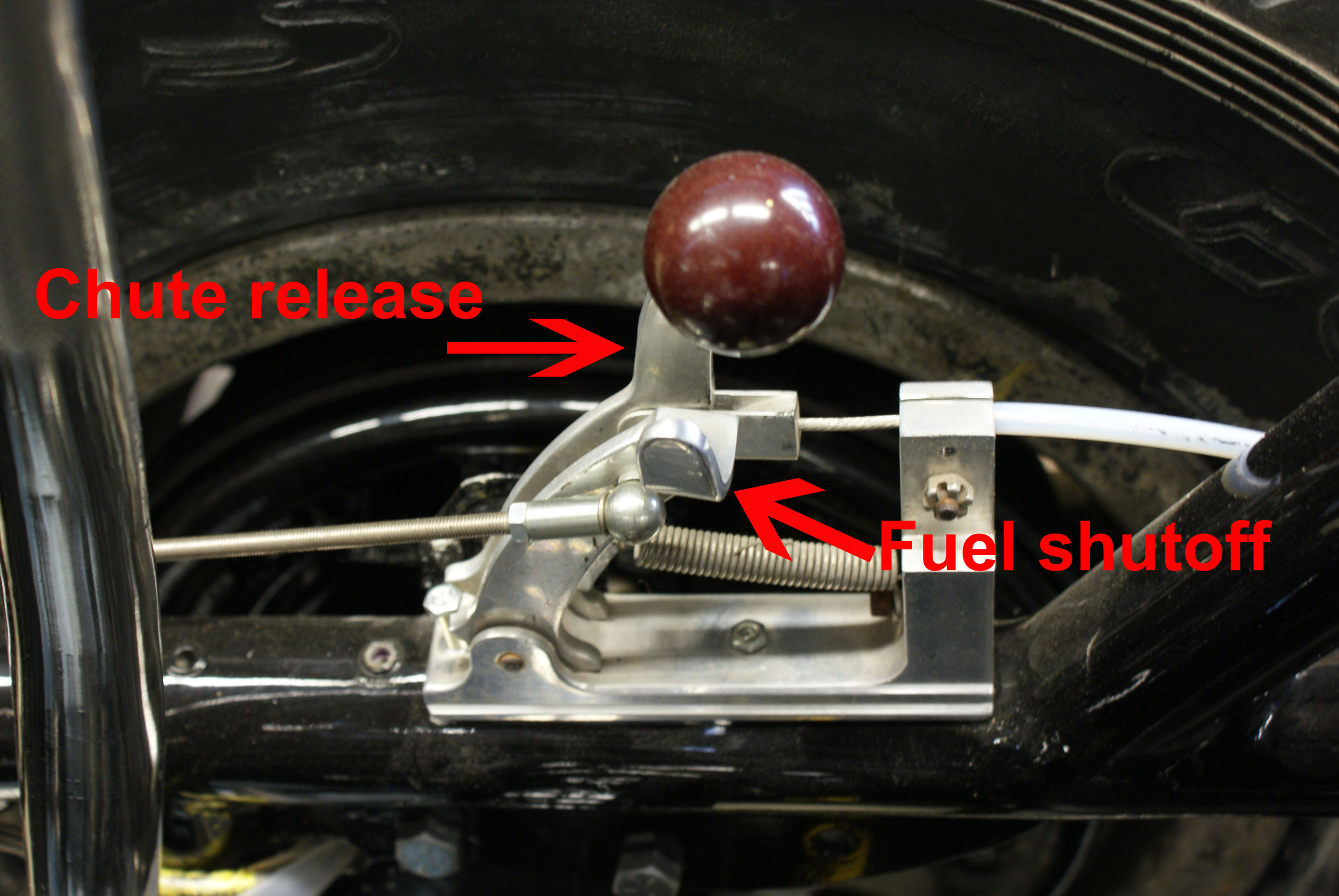

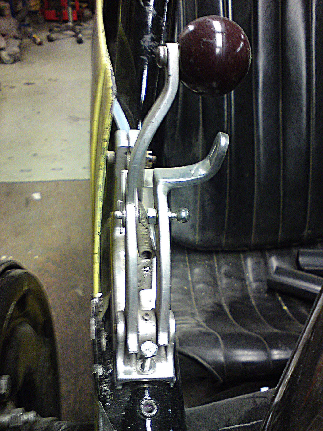

    So here are my question,
    I have a double lever for engaging chute & fuel-shutoff.
    Does anybody recognize this one?
    Homemade or a known speed part?
    Thanks.

    I have seen something like that before. Just can't remember where. Was years ago I know. Roo? Lippy

    Thanks Lippy:) If you remember where it came from, holler out:)
    Almost everyone who sees it, whants to know where it came from:)
    I modified it abit, as it shut of the fuel at the same time i released rhe chute.

    Give some history. What car is this on, who built it, and around when?
    I never knew of anything like this being manufactured.
    My guess is it's a fabricated one of a kind.

    Hi Tom.
    It has been on my 150" dragster since it came together in the late 80's.
    It was bought in boxes in Minnesota.
    The dragster was put together by Don Groff. We don't have any other history on it, sorry.
    If it is one-off, then it must be someone really skilled:)

    I'd bet this is a one-off. Very good craftsmanship however.
    I'm not familiar with Don Groff. Was this a comp or pro-comp car? If it was built in the late 80's, it was probably one of the very last conventional cars of the time. I quit in 1980, and we had a rear engine car since 74.
    I've seen the plow handle addition on the brake lever for fuel shutoff before, primarily inf funny cars or altereds, but never adjacent to the chute release.
    How do you like using this setup?

    Thank's Tom:)
    The dragster is an old one ca 1966 modell, Don bought it along with alot of parts. He put it together and run a short periode of time, than i redid it nameing it Mitty's Past Gas, painted it yellow with an injected Hemi.
    He than took the hemi out, and sold it. The new owner painted it purple, put in a flathead, and renamed it Roadkill Express.
    You can look into my thread on the my project:)
    http://www.jalopyjournal.com/forum/showthread.php?t=531757
    I really like the fuel/chute engagers. It's small and compact, and it look good:) I did however, modify it so i can release the chute, and still run the engine, cut off the fuel a litle later on, as the track are so long:D!
