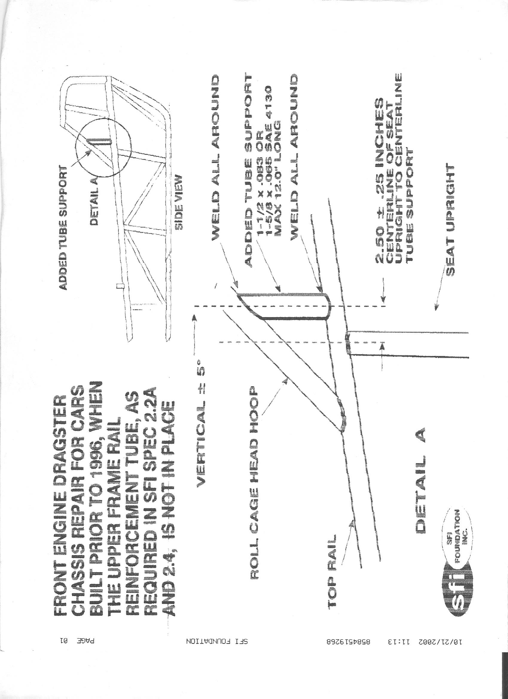

    My ch***is is an older FED with chrome moly tubing.
    I need to do some changes, i order to meet the SFI spec's.
    I have heard that it's recomended to mount a new pipe/tube inside existing "C" tubeing/hoop!? Any advice on this?

  13. dreracecar
    Joined: Aug 27, 2009
    Posts: 3,476
    dreracecar
    from so-cal
    Since yours is an older frame you are allowed to do this. sorry about the pic, just turn your moniter 90deg.

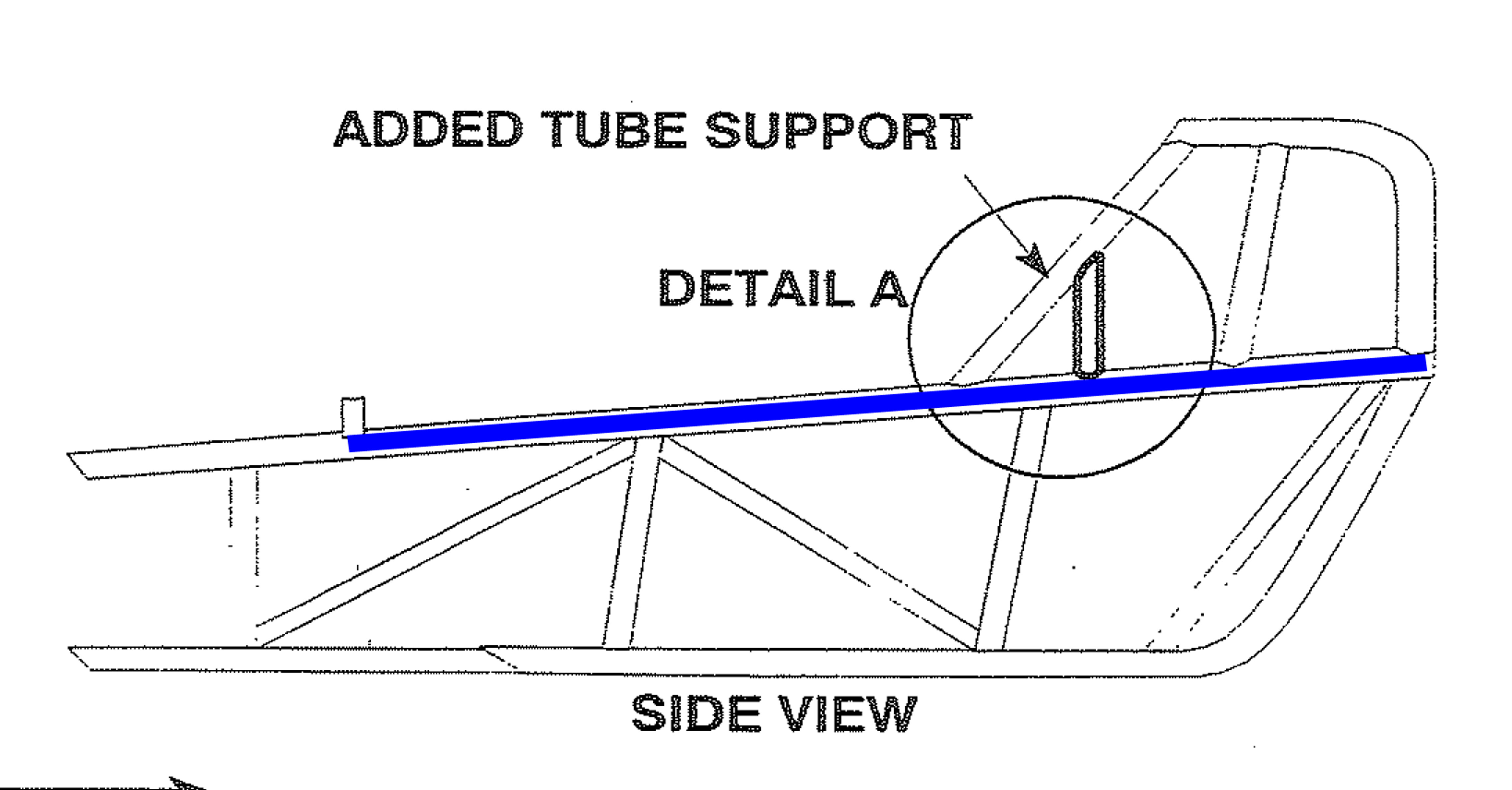

  14. fenderless
    Joined: Mar 31, 2006
    Posts: 1,286
    fenderless
    from Norway
    Thanks dreracecar.
    I must consider that pipe, but have also heard of a possible new pipe inside exsisting "C" tube as shown here. (Blue)
    My SFI specs dates back to 2000, so there might be some new guidelines?

  15. dreracecar
    Posts: 3,476
    dreracecar
    from so-cal
    First-- "PIPE" is used for plumbing a house and not to build a ch***ie with.
    A piece of tubing inside the upper frame rail was only considered if there was a splice in the area of the front rollcage hoop and the foward seat upright and was unessary if the hoop was all one piece.When the inside support tube became a requirment they allowed the cage support upright instead of cutting the back of the car off and having to insert a peice of tubing. And this methode is still in effect today

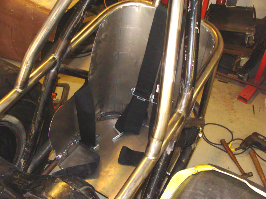

  25. roseville carl
    Joined: Dec 29, 2008
    Posts: 5,218
    roseville carl
    Question... I need to remake the roll cage on the flat fed so grandson can drive it, he's 6-2 going on 64 so won't fit, its a 10 sec + car so not worried about fast cert just want to know if I can cut it off and reweld the new one on in its place, or what should I worry about........hummm
  26. dreracecar
    Posts: 3,476
    dreracecar
    from so-cal
    Should not be a problem doing that, For grins I would put a splice tube in the secondary hoop since that is the foward seat upright and a couple rosetts.
    Personal note- I would like to see the seat sides fill more of the frame area or weld some tubing around the edge to keep the edges from acting like a razor in case of an upset
    And take the belts off the car while working on it unless you plan on replacing them before it goes out, d****** them over the edge of the sheetmetal seat is not a good idea.

  28. roseville carl
    Posts: 5,218
    roseville carl
    that was when I built the car. The belts go through slots cut in sides rubber covered to keep from chafing <!-- / message -->

  29. dreracecar
    Posts: 3,476
    dreracecar
    from so-cal
    personaly---That horz bar does nothing except add weight. Cut out that horizontal bar and put an uprite and diag corner to corner in each bay.
    But if the car does not have to be certed and tagged thats somthing that the tech at the track never looks at/for anyway.
    Carl---- They call them "LAP BELTS" not "BELLY BELTS" your belt anchors are too far back as the belts are supposed to go across the hips and hold the driver down into the seat. Its the shoulder belts that keep the driver from going foward.
